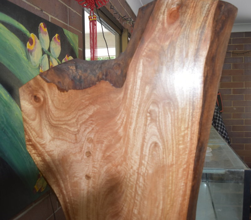

I had purchased a lovely figured piece of camphor laurel (considered a weed here in Aus due to its multiplying & out competing our native equivalents). It seasoned over some years but I was apprenhesive about using it for its original intended use: that of a natural edged table top. It has pimples and sharp edges that could be hadardous to shorter folk's heads and their little fingers.

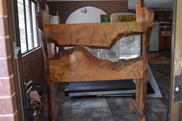

I was in a bit of a reverie looking outside the square and came up with this fish tank stand to break up the Chi energy as it rushed into the dwelling. At present I cant show pics with fish as my son moved home with his pool table and other chattels so it isn't doing its job currently. I approached an expert and she advised gold fish were fine (easy to maintain in our erratic climate) and seven were best. 2 black & 5 gold.I had to move them on when hearing of my son's temperory return ( about a year now). "The Woodworker & Woodturner"(UK) published a pic of it under Whimsical woodworking.

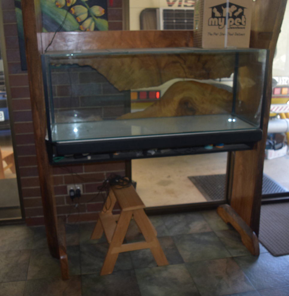

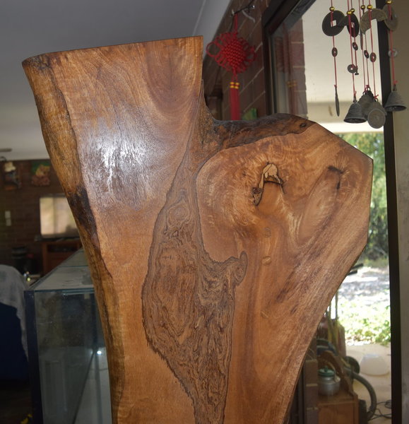

I cut the camphor slab in two & reversed the halves to create the underwater appearance of "the cave". To enable it to carry the weight of the 1.23 metre tank full of water, stones, fish etc I decided to use two solid legs each with a foot to span the weight to avoid tipping.
The legs are pear tree and the tops are cut at angles to create further interest. I originally thought of an offset gable like top to house a light but decided against that.
Attachment 28717 Attachment 28718

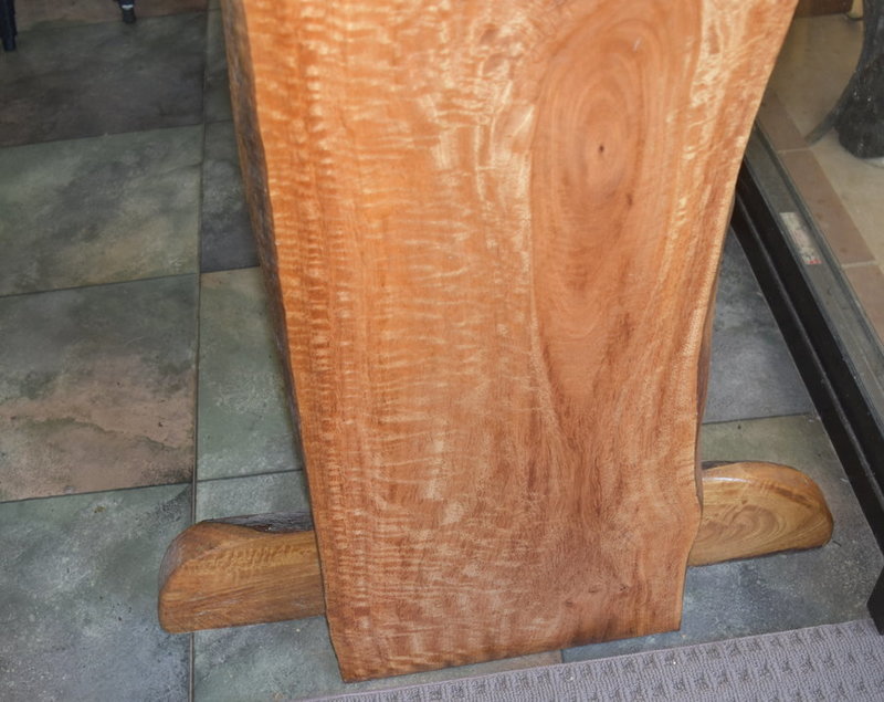

Feet are made from off cuts of other camphor laurel.

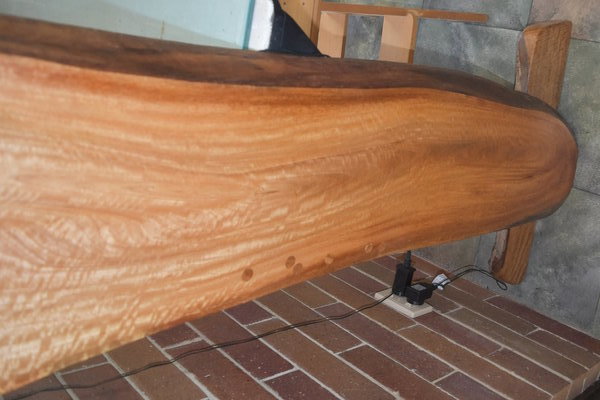

The carcase that holds the tank to the legs & front is made from 3/4" pine Lamellod (biscuit joined) together of form a main shelf with a smaller one for scoop, feed & any other bits & bobs for the fish & tank.This I painter flat black to make it invisible to the beauty of the other timbers. It is attached to the legs & front by 2" gal batton screws.
Legs are attached to the face pieces by 4" long gal batten screws and plugged with, as near the matching grain I could get from the pear off cuts.
The Original hang on waterfall oxygenator pump has long gone & could not be replaced identically so I replaced it with a Jebo (an excellent pump that lasted years: it's still on the website but unavailable). I had to rout a stopped groove for it's implentation.I had allowed a few inches for a pump in the original design but unforseen things happen.
Attachment 28721
