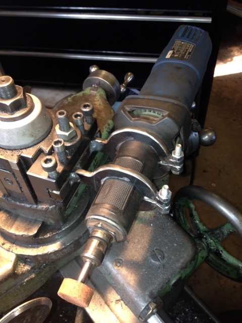

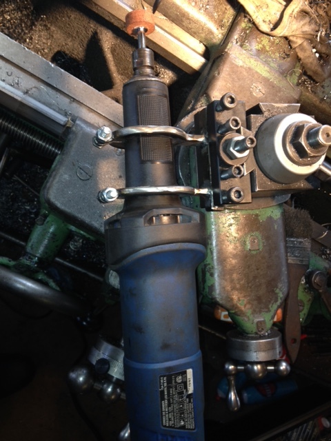

I needed a tool post grinder to back-cut some valves so today I made a mount for an electric die grinder.
Attachment 22883Attachment 22882

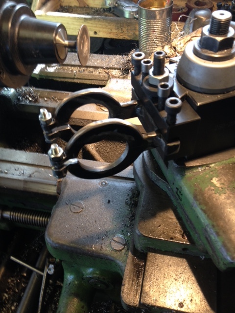

Attachment 22884
