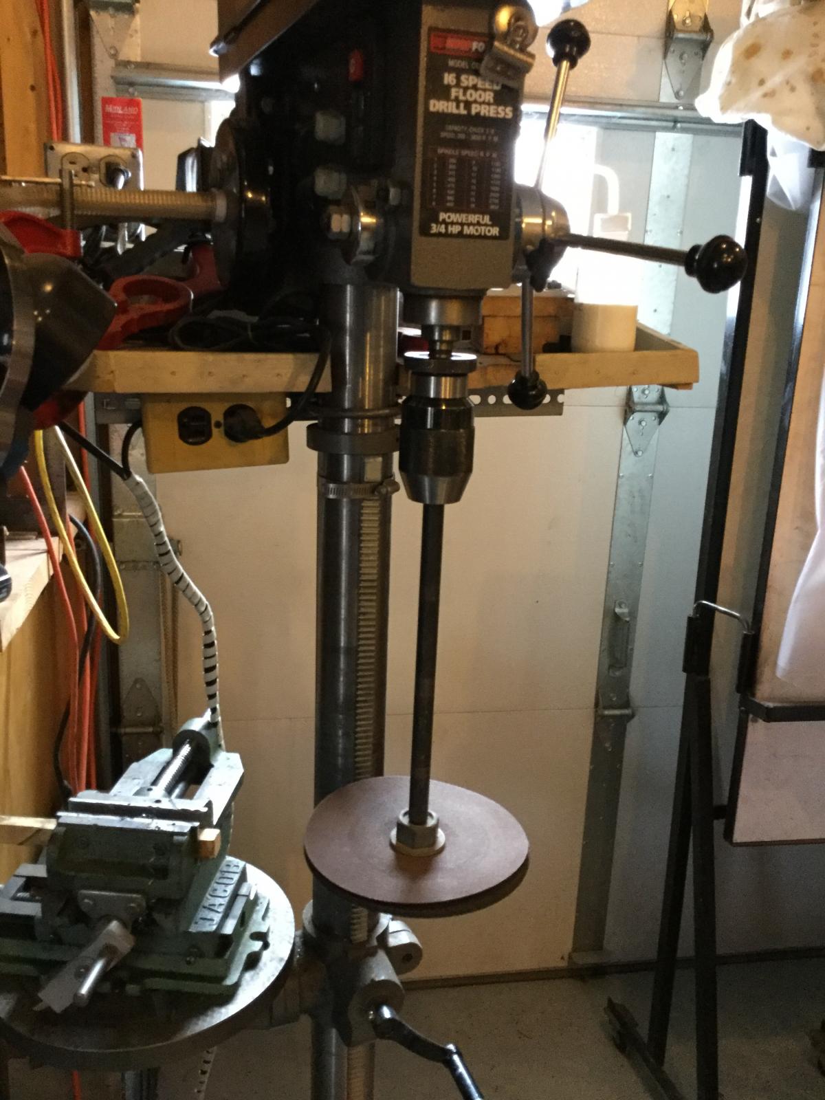

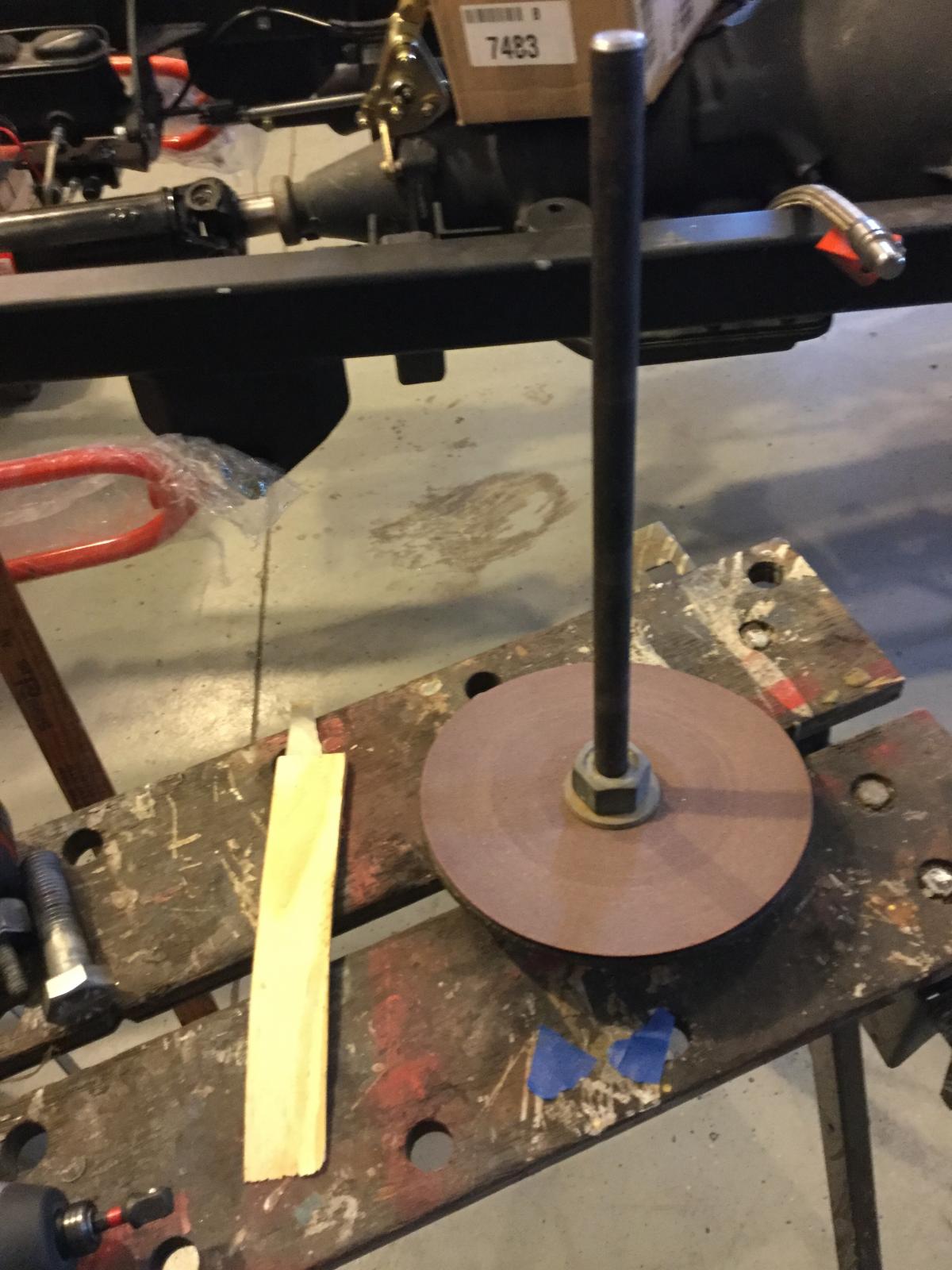

    Tool sharpener
    I built a simple and cheap tool multi use sharpener for shop. I took a long 5/8” bolt and cut the head off. I threaded it into the face of a 7” disc grinding wheel and locked it on with another nut. I use various adhesive backed sanding discs for the finish desired.
