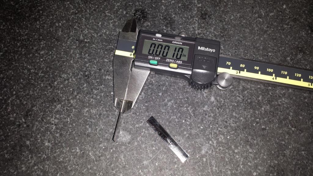

I remember seeing on YouTube or in my reading a reference to using the thin steel parts from RFID anti-theft tags for tool shims. The one I took apart had three 0.001" thick x 0.25" x 1.45" thin steel shims. I am sure the shim thicknesses depends the RFID tag manufacturer.
Attachment 3904
