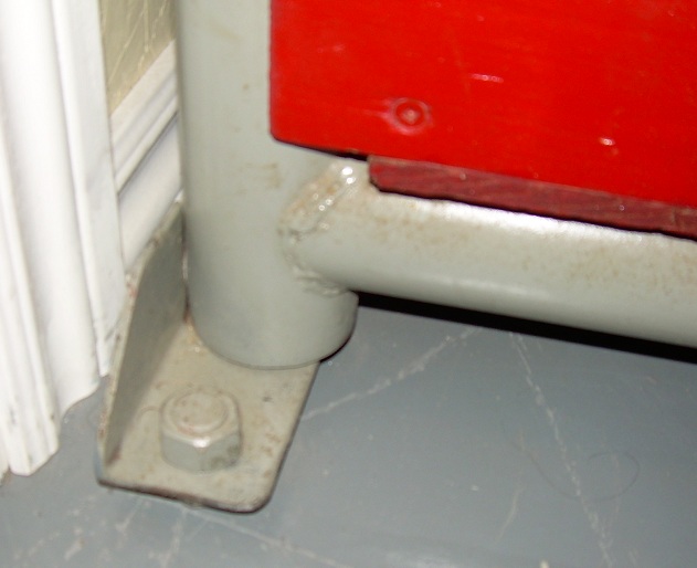

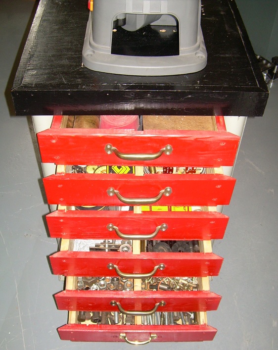

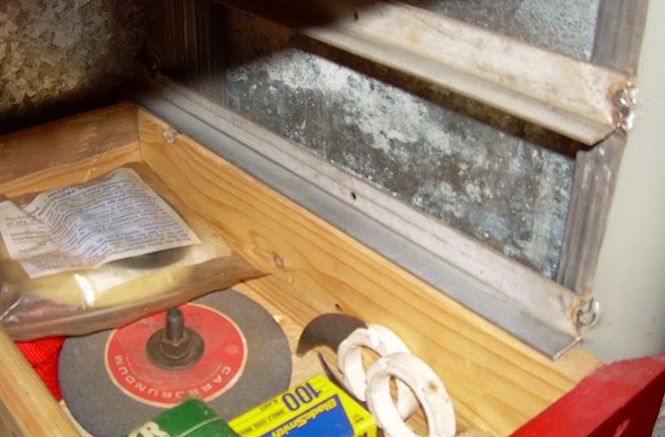

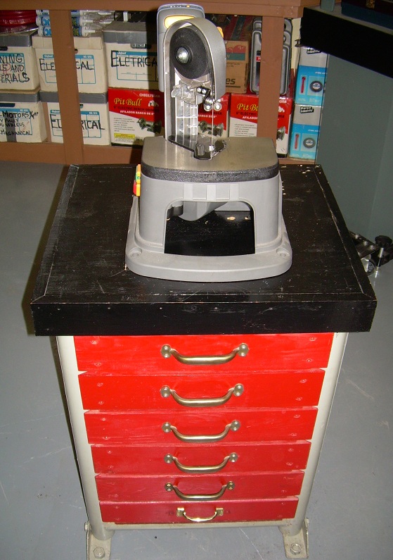

    I built this many years ago. Over the years I have had many tools mounted on it as my shop layouts changed. A drill press, a mini mill etc. Currently I have a mini metal bandsaw in my little home machine shop for preparing small metal stock. It has divided drawers for storing nuts & bolts, bearings etc. It is built very solid with a 2" pipe frame covered on 3 sides with 1 continuous sheet of 18 gauge. The drawer runners are thin galvanized angle and the feet have adjustable bolts for leveling. Very heavy duty.
