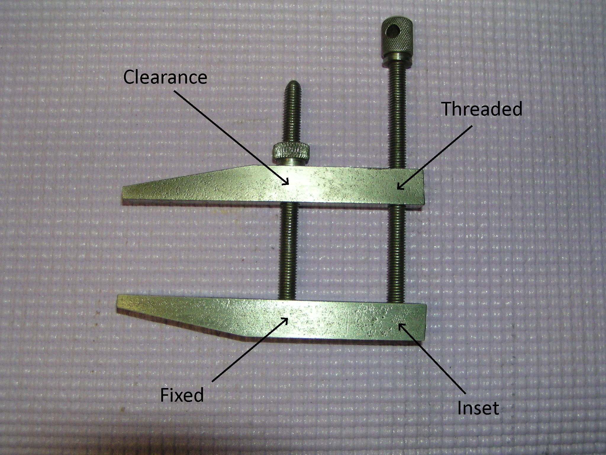

Slightly different configuration to the norm, it can be can be obstructive to have to have a length of threaded rod protruding below something being clamped so I changed things a bit to have both clamp screws on the same side. This has worked much better for me and easier adjust one handed.
Attachment 37001
