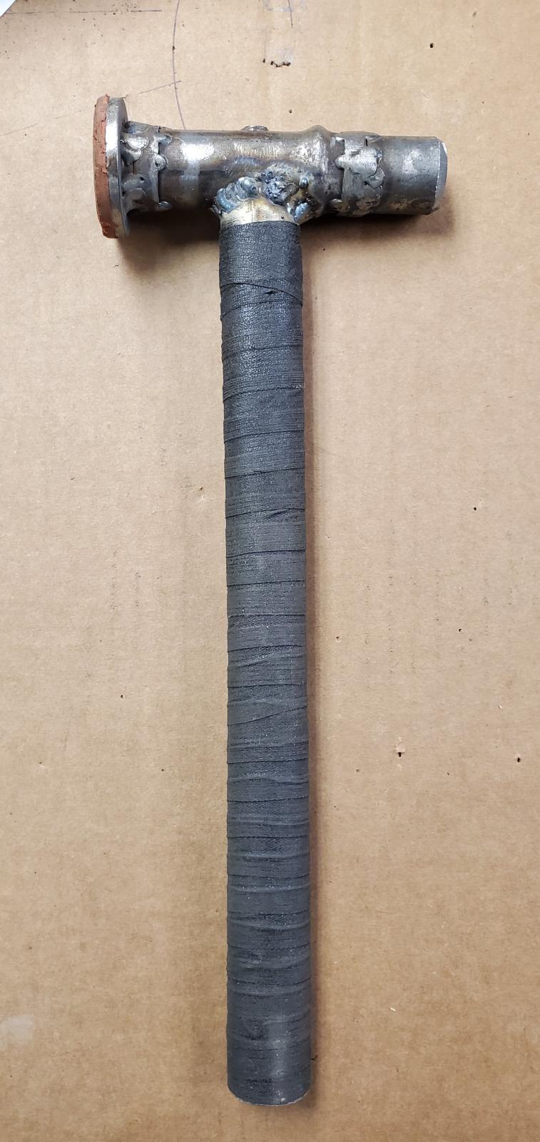

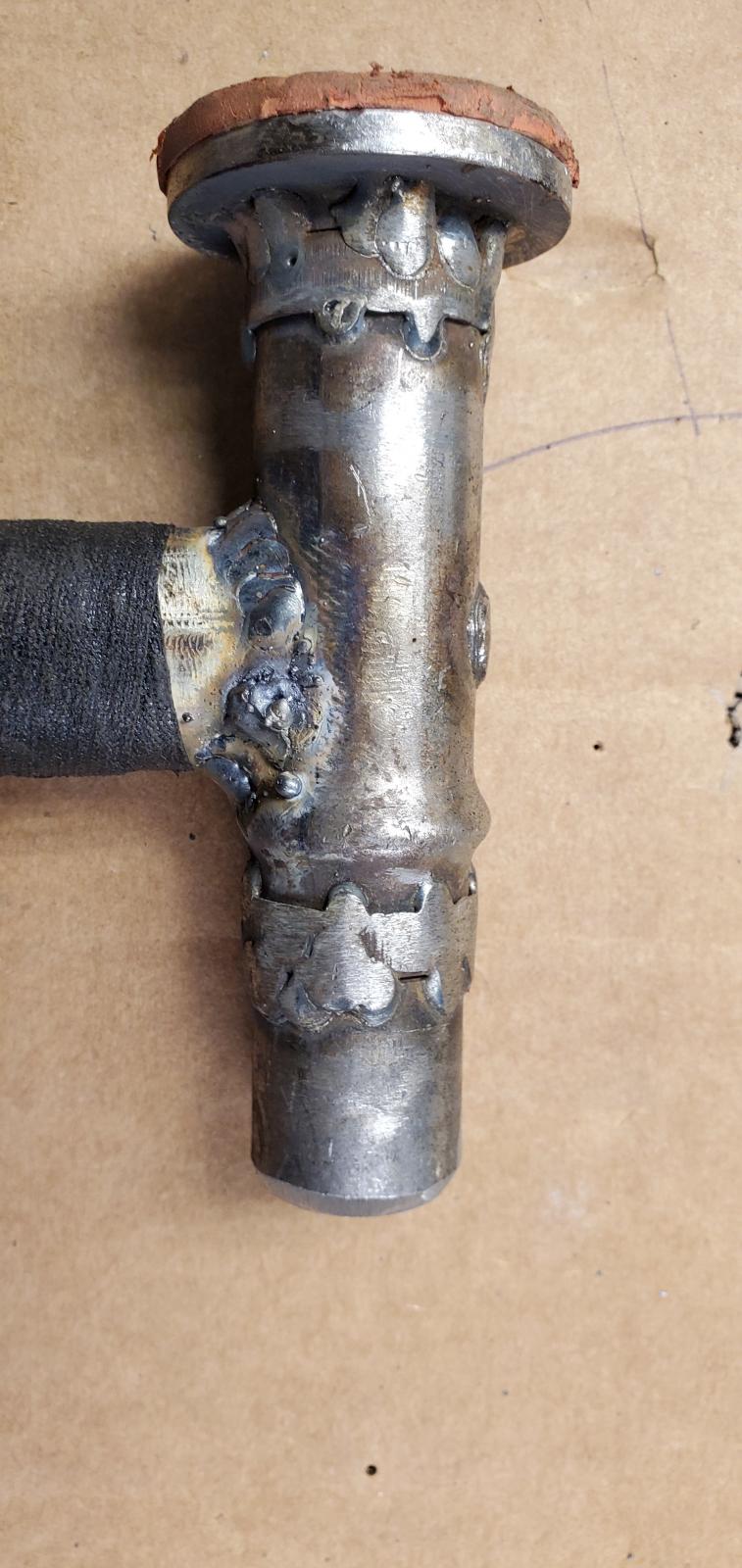

Grumble... grumble . . then . . . a thought!
I broke the rest of the head off and welded on a mild steel chunk on one end and a disk on the other end.
On the disk end I super-glued on some 1/8" clay-filled rubber I've had kicking around for 20 years or so.
The handle was a bit broken so I wrapped part of it with twine and super-glued the crap out of it.
Well, that handle worked for a bout 6 months before it began to disintegrate. Sigh...

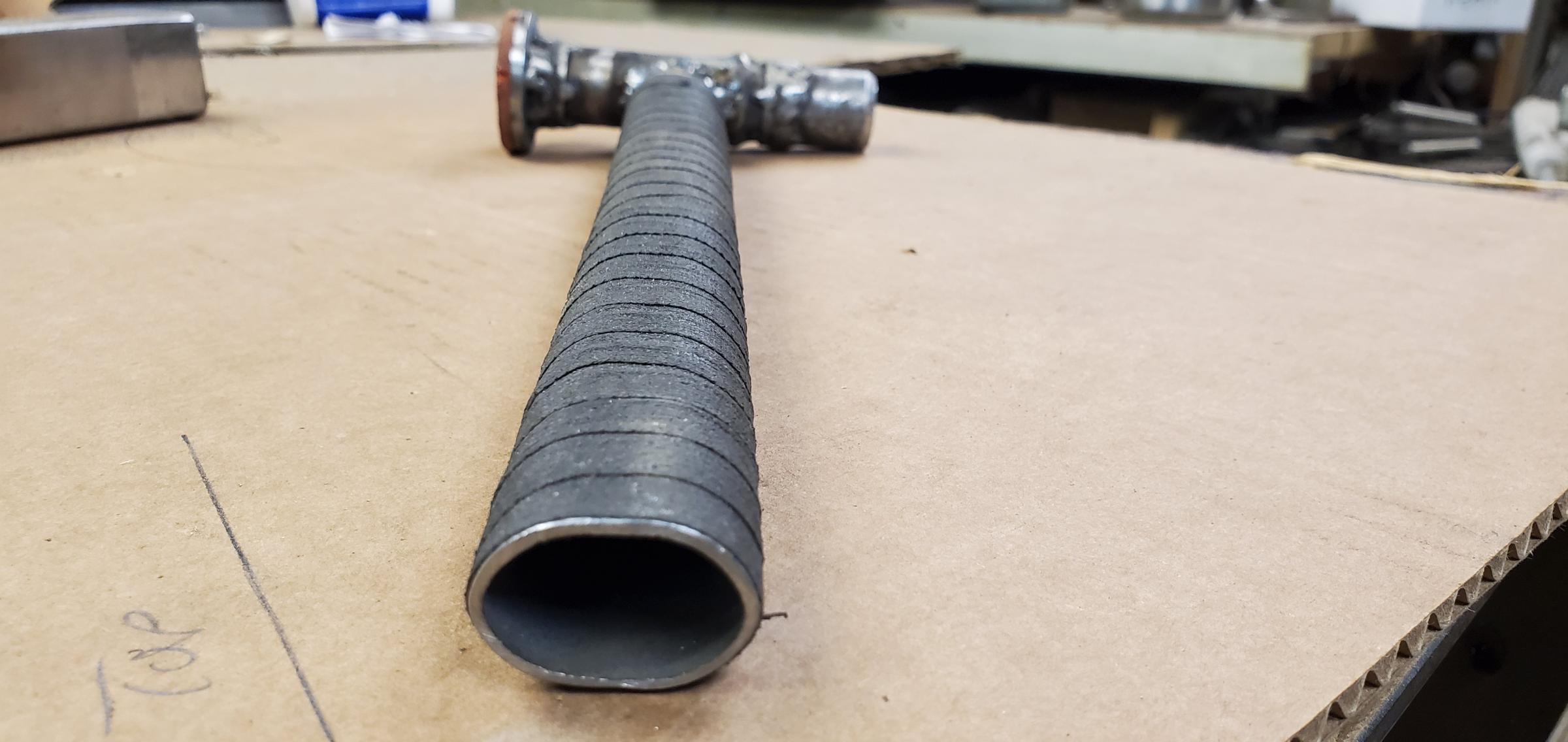

I cut off the entire plastic handle stuff off and replaced it with a piece of 3/4" EMT that I flattened and welded that to the head and wrapped it with that old black tar-covered cloth tape (what is that stuff called?!) to give it GRIP.
Here it is!
Attachment 37541
Attachment 37540
Attachment 37542
I use this more than any other hammer, well, except my Warrington pattern hammer that is so nice and small and pointy.
I really do not care that it looks like my first welding project from junior high school - IT WORKS!

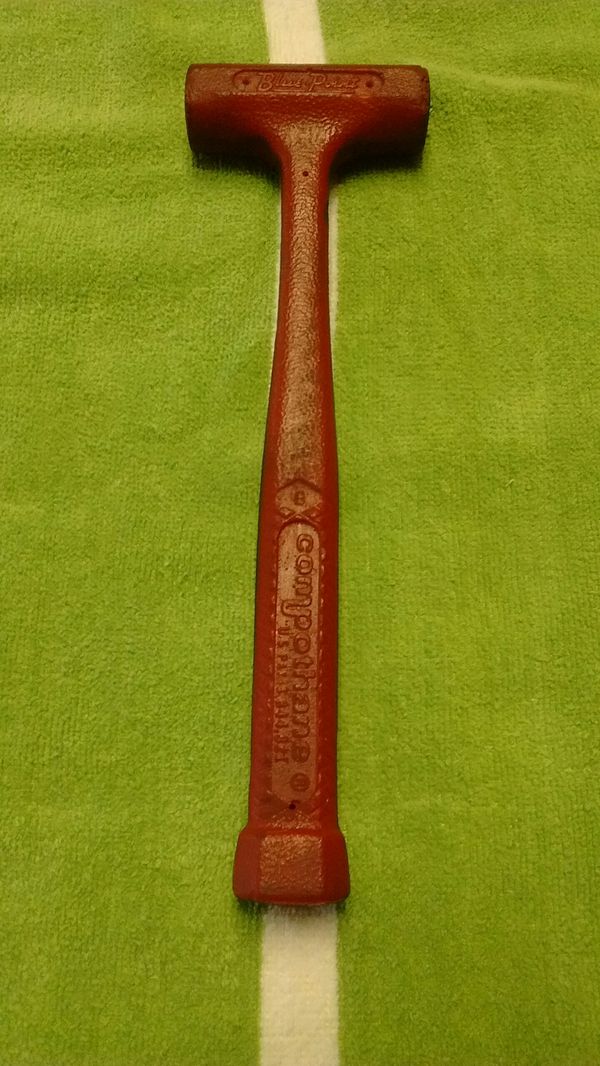

Here's what the garage-sale hammer looked like (from an online ad for a used hammer).
