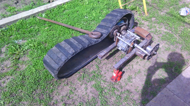

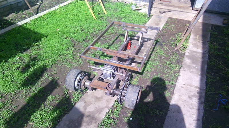

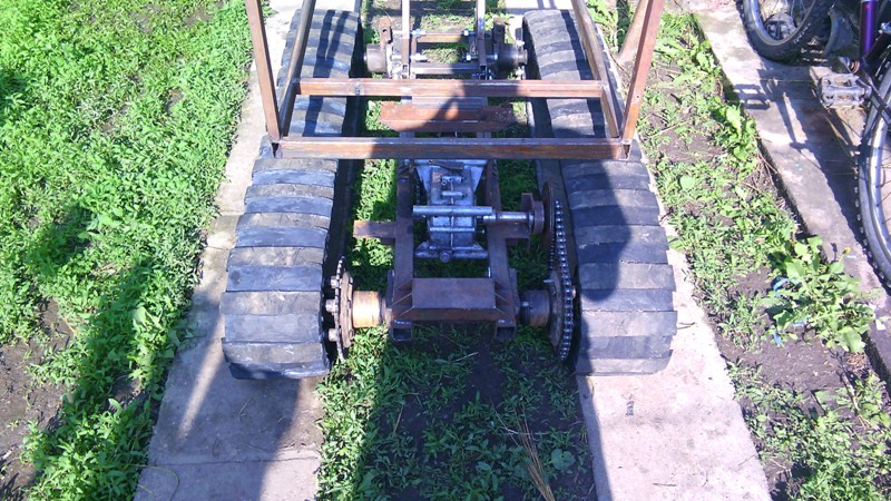

    Tracked mini dumper

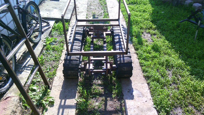

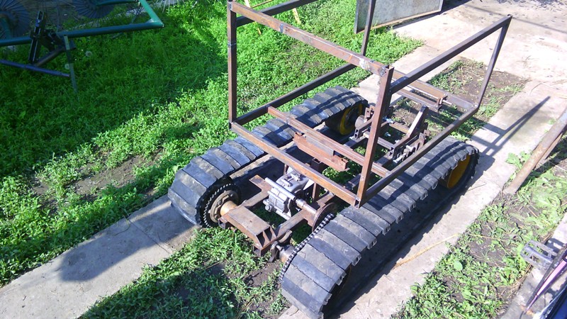

    My new project tracked mini dumper. It will be used for working in the garden. Advantages of tracked vehicles is its maneuverability, can pass and turn around using the small space. To rotate I use differential and single disc brakes on each track. Gearbox has forward and reverse, from cargo motorcycle.
    Tracked mini dumper-img_20160429_115603.jpg Tracked mini dumper-img_20160429_122508.jpg Tracked mini dumper-img_20160429_135554.jpg

    Track made from old truck tires. Cut out the treadmill and cut a new tread.

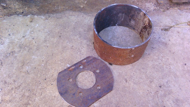

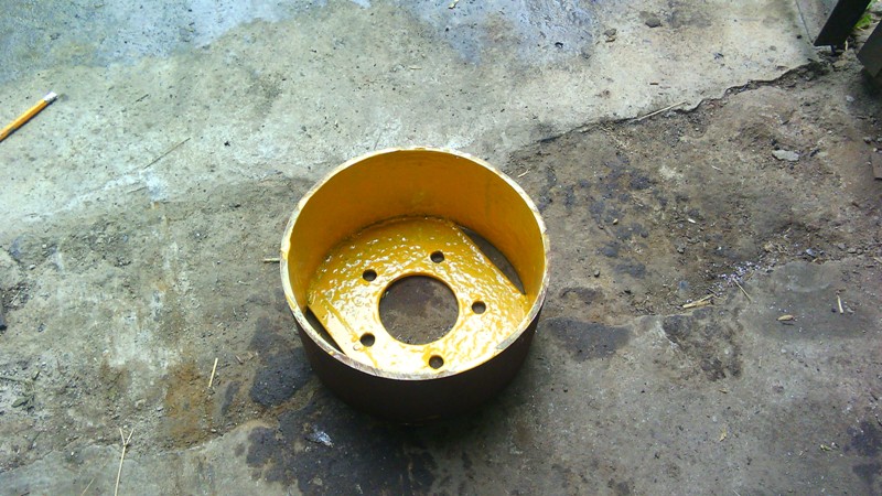

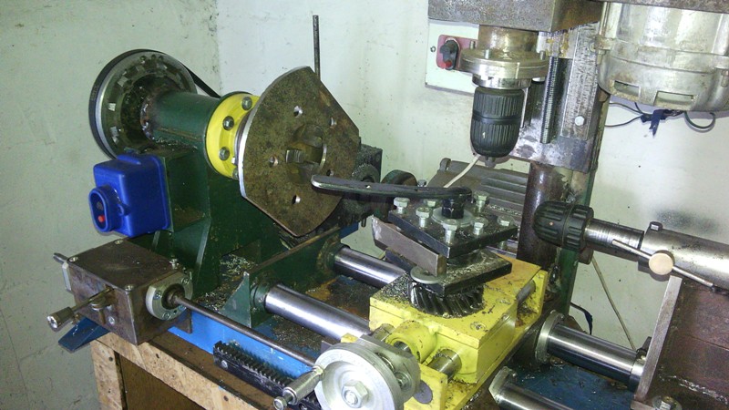

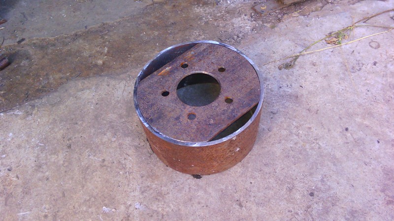

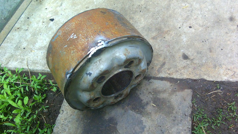

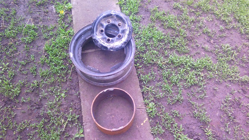

    Wheels Manufacturing
    Tracked mini dumper-6.jpg Tracked mini dumper-7.jpg Tracked mini dumper-8.jpg Tracked mini dumper-9.jpg Tracked mini dumper-10.jpg Tracked mini dumper-11.jpg Tracked mini dumper-12.jpg

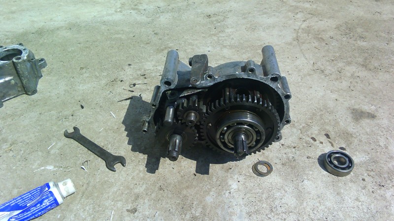

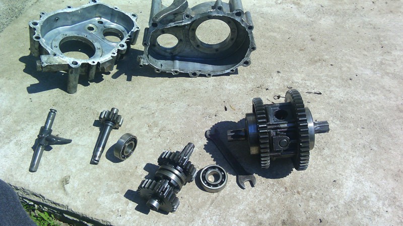

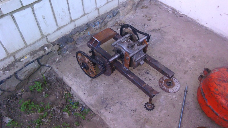

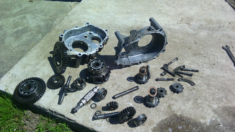

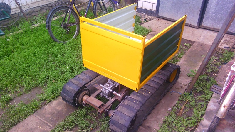

    Now I'm creating gearbox and search engine. Photos will be later.
    Tracked mini dumper-13.jpg Tracked mini dumper-14.jpg Tracked mini dumper-15.jpg Tracked mini dumper-16.jpg

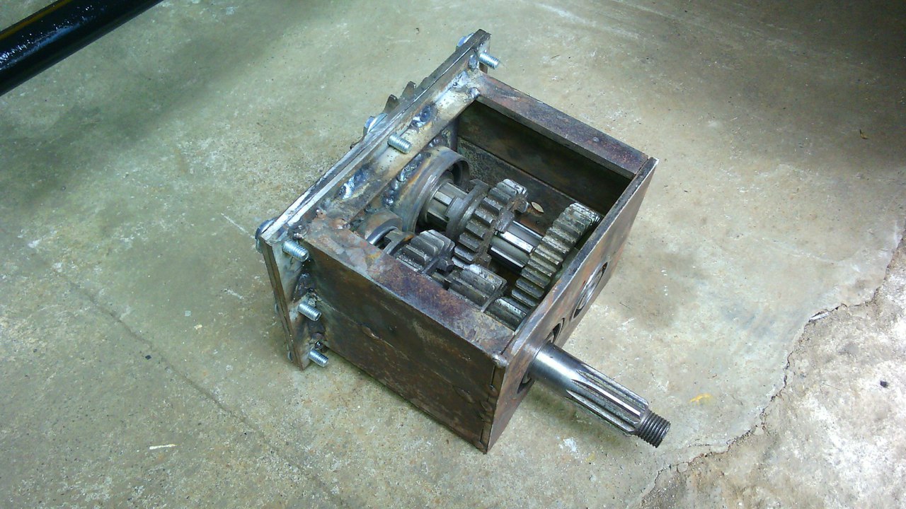

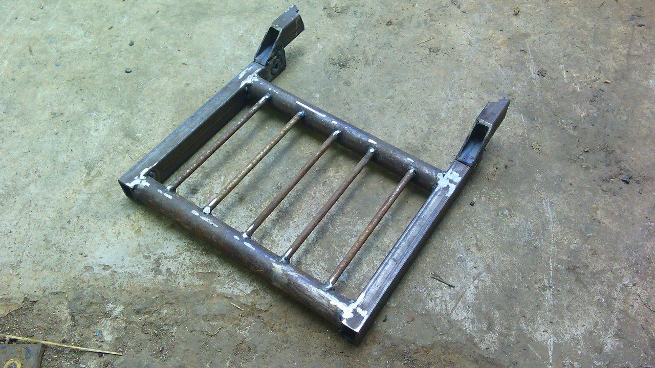

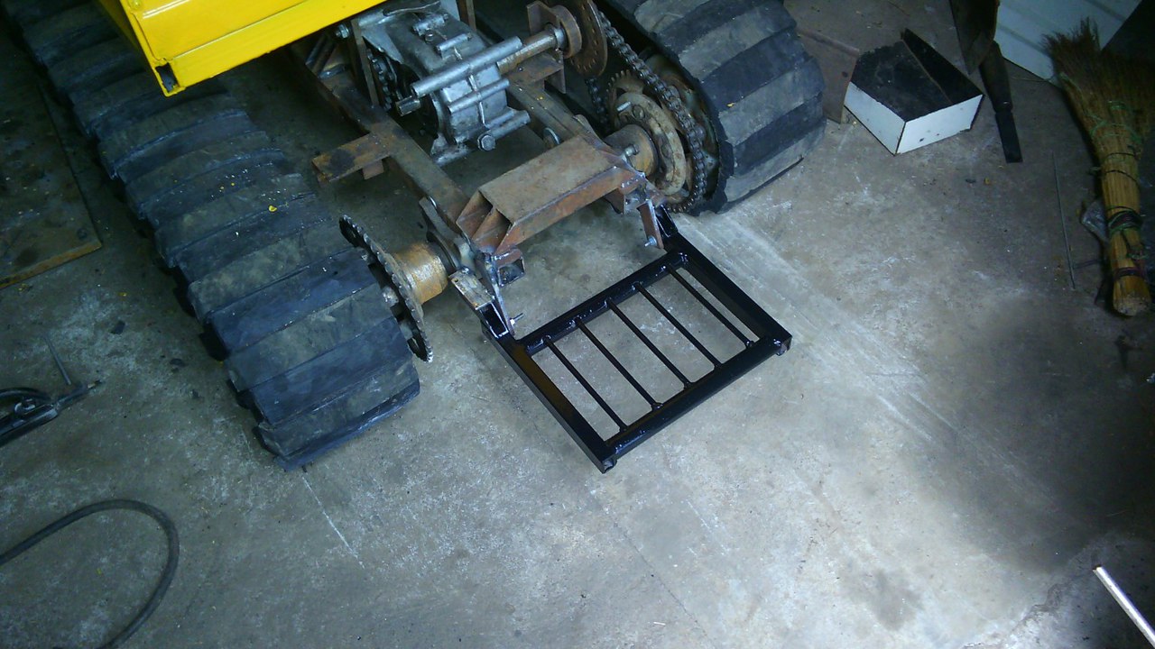

    When driving a mini dumper і can go along. In order to be able to stand I made just such a platform.

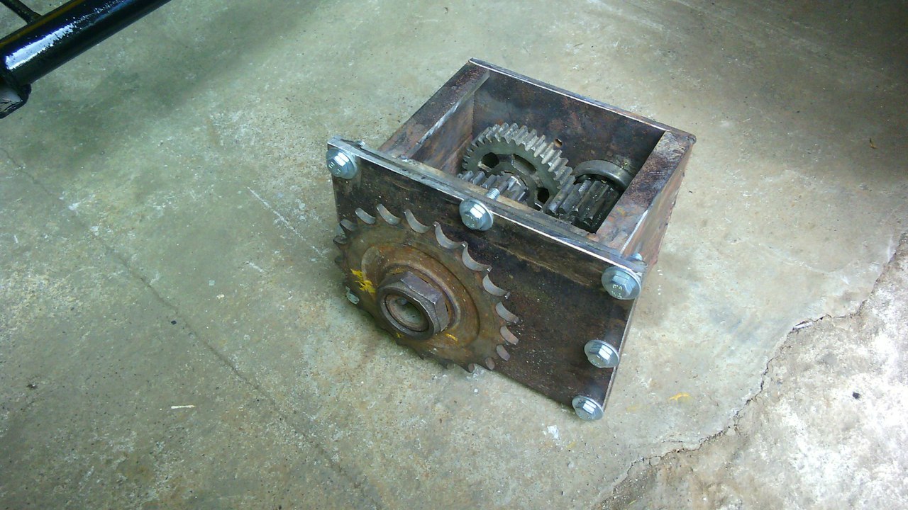

    This homemade gearbox, it has 2 speeds. It is in the process of creation.

    Brilliant, like it very much, have one question, if you have done four flat profile wheels for the rubber tracks to run on. How will you stop them from slipping off when you rotate the vehicle.
    Keep the pictures coming
