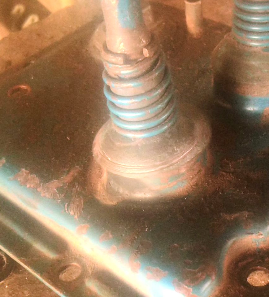

However the ford had a gear shift problem we noticed while unloading it and there was water contamination in the transmission oil.
the gear shift lever just needed a bit of weld build up to fix that problem, And while I had it apart I decided to cure the water getting in the transmission problem by making a new cupped cover to replace the missing one on the gear shift lever.
I started with a fat of about 1/8" thick heated it up and bet it to about 1/16" thick then heated it up and shaped it into a cupped shape with the punch and die I made for that purpose
Attachment 40595
Attachment 40596

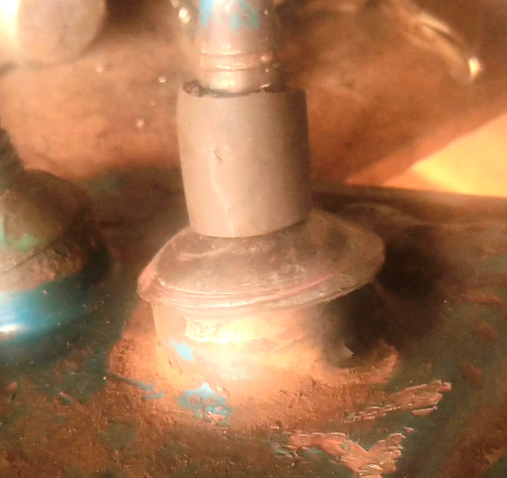

I pushed a rubber sleeve down onto the shaft

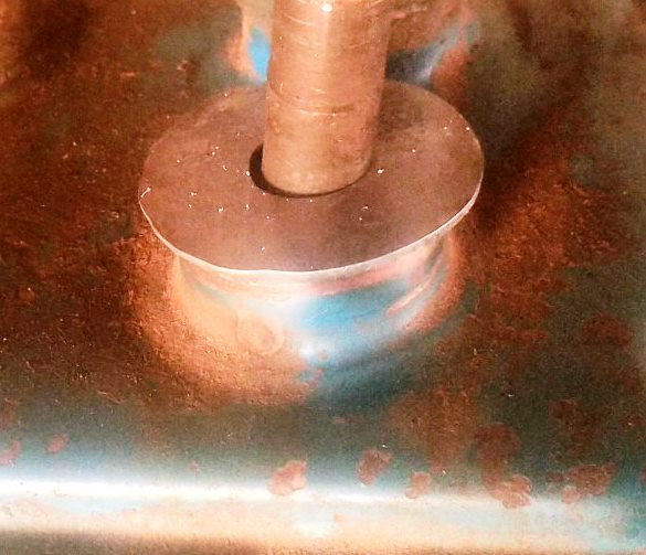

Attachment 40597

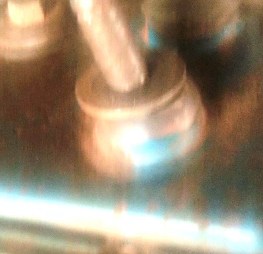

the factory spring keeper forces the shift lever to stay in place but the added rubber sleeve will further prevent water contamination
Attachment 40598
