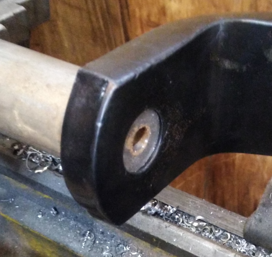

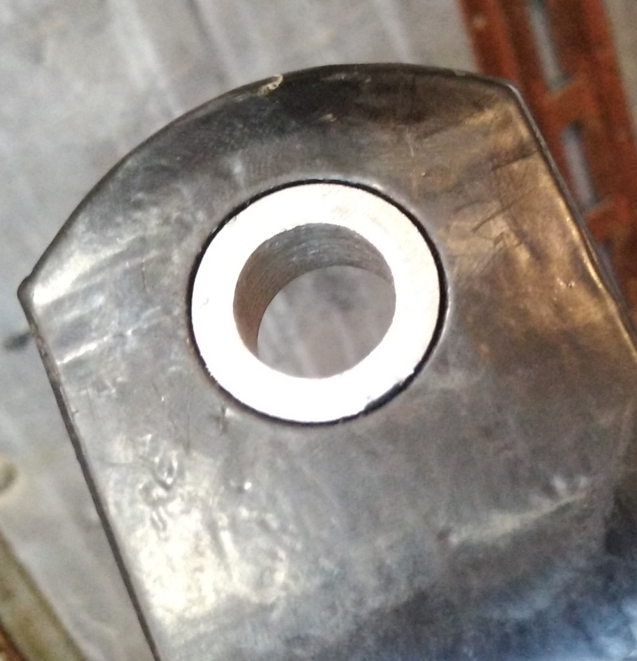

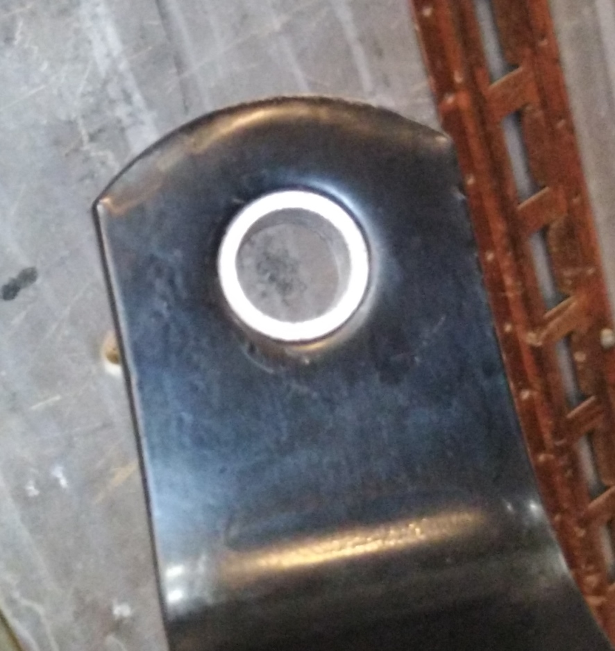

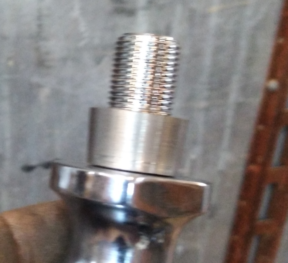

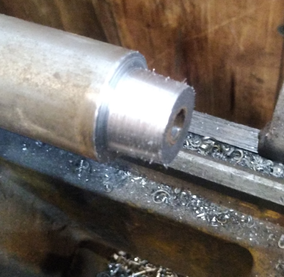

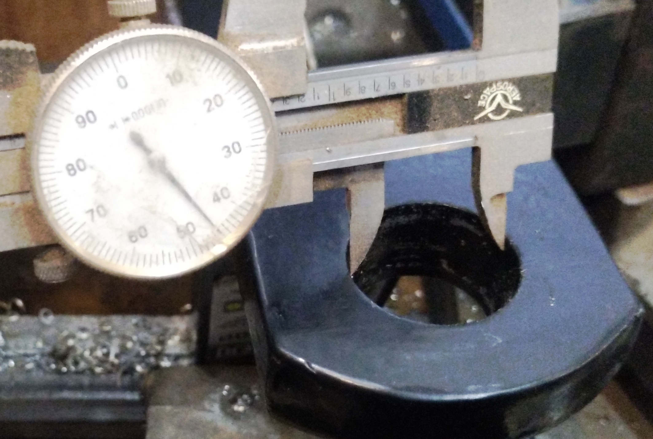

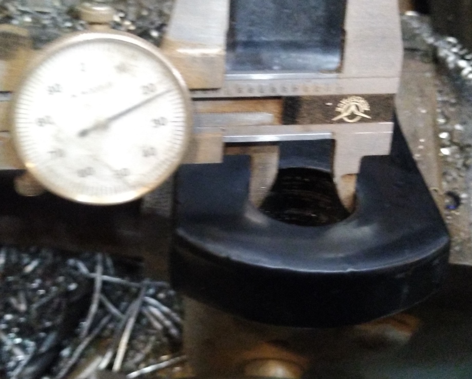

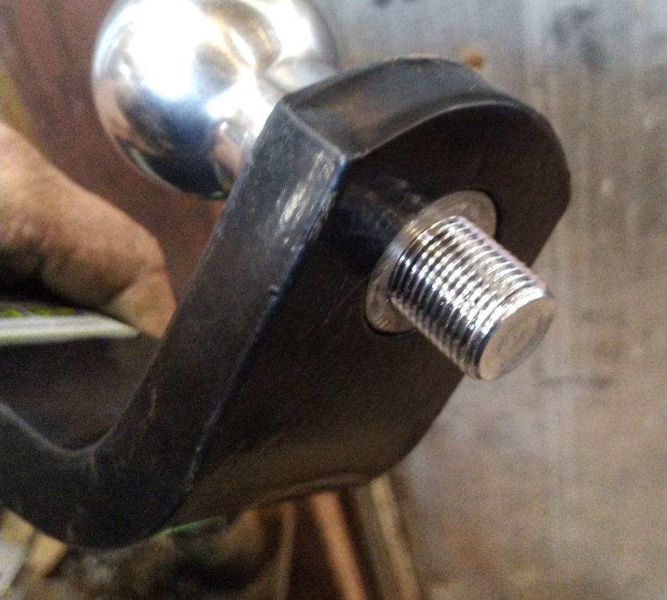

He returns with a ball that has a 3/4" shank and a drop adapter with a 1" hole. This was all they had he said. No problem I'll just make a bushing for it I told him.
Simple right? Just saw off a piece of the 3/4 ID 1" tubing I have in stock I thought.
NOOOOOO, nothing is ever that simple any more, the hole was a punched hole through 3/4" thick material causing it to have over .100" taper or 1.145" diameter on the bottom and 1.022" at the top. So I made a tapered bushing
Attachment 42460
