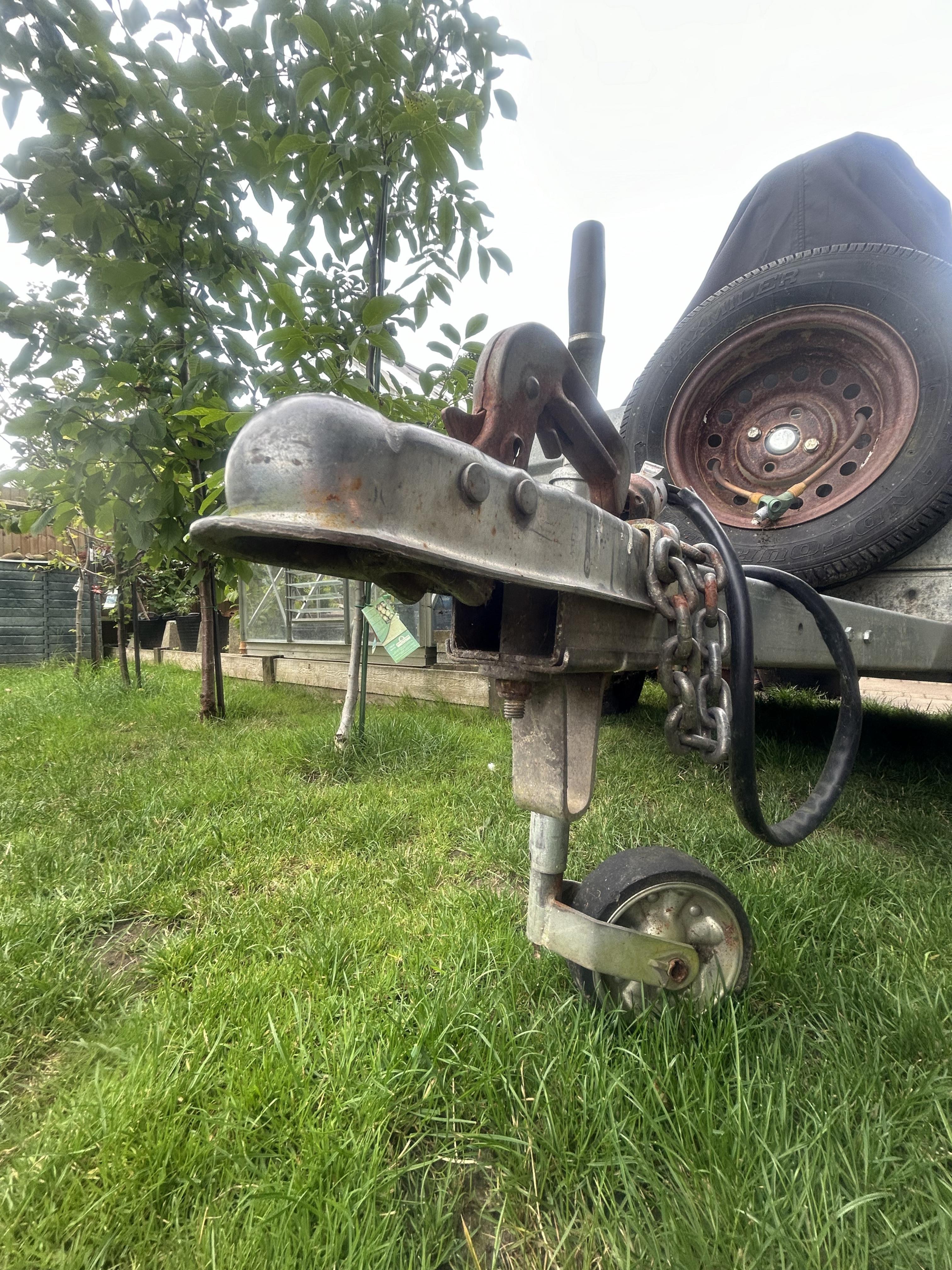

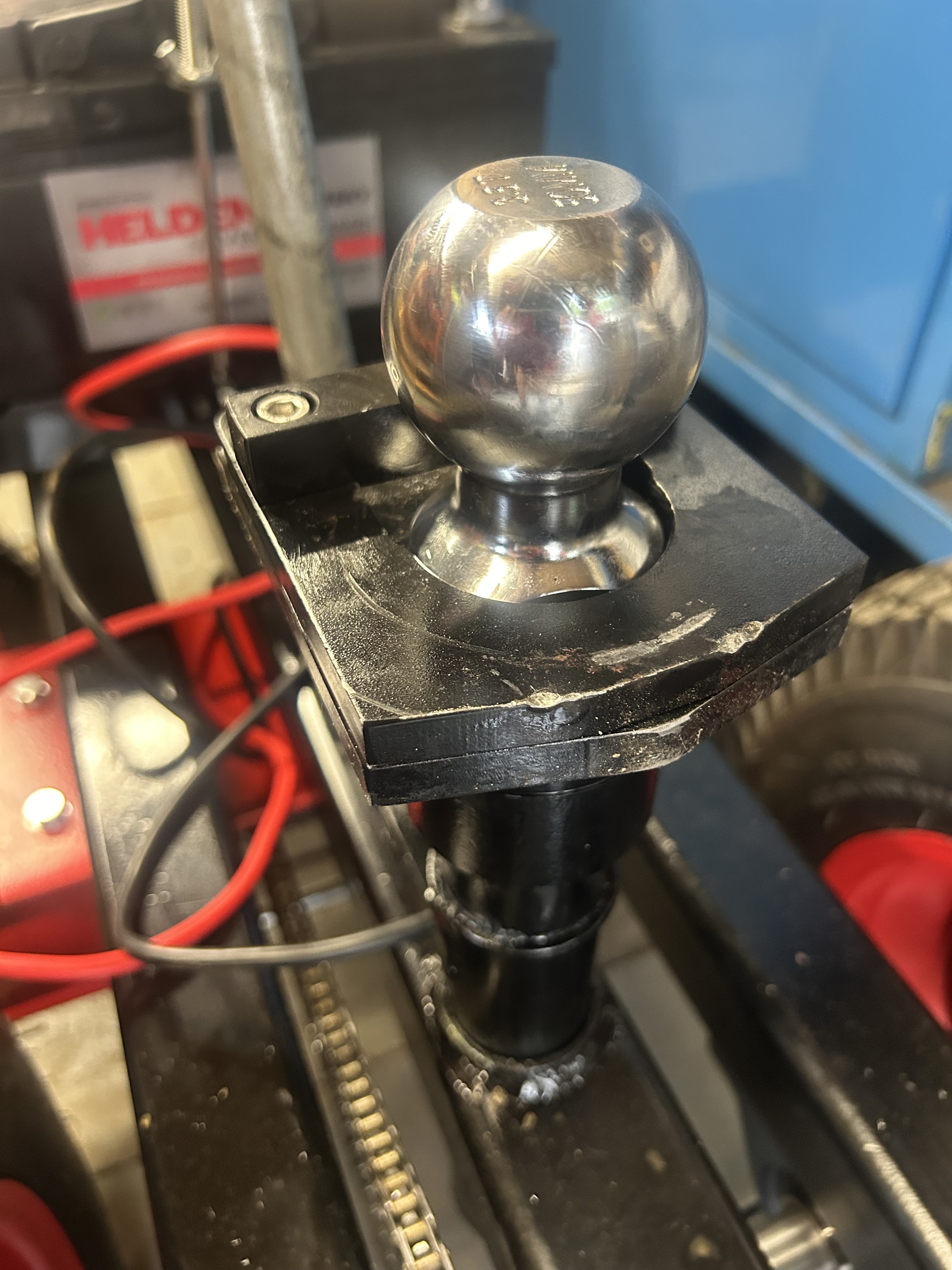

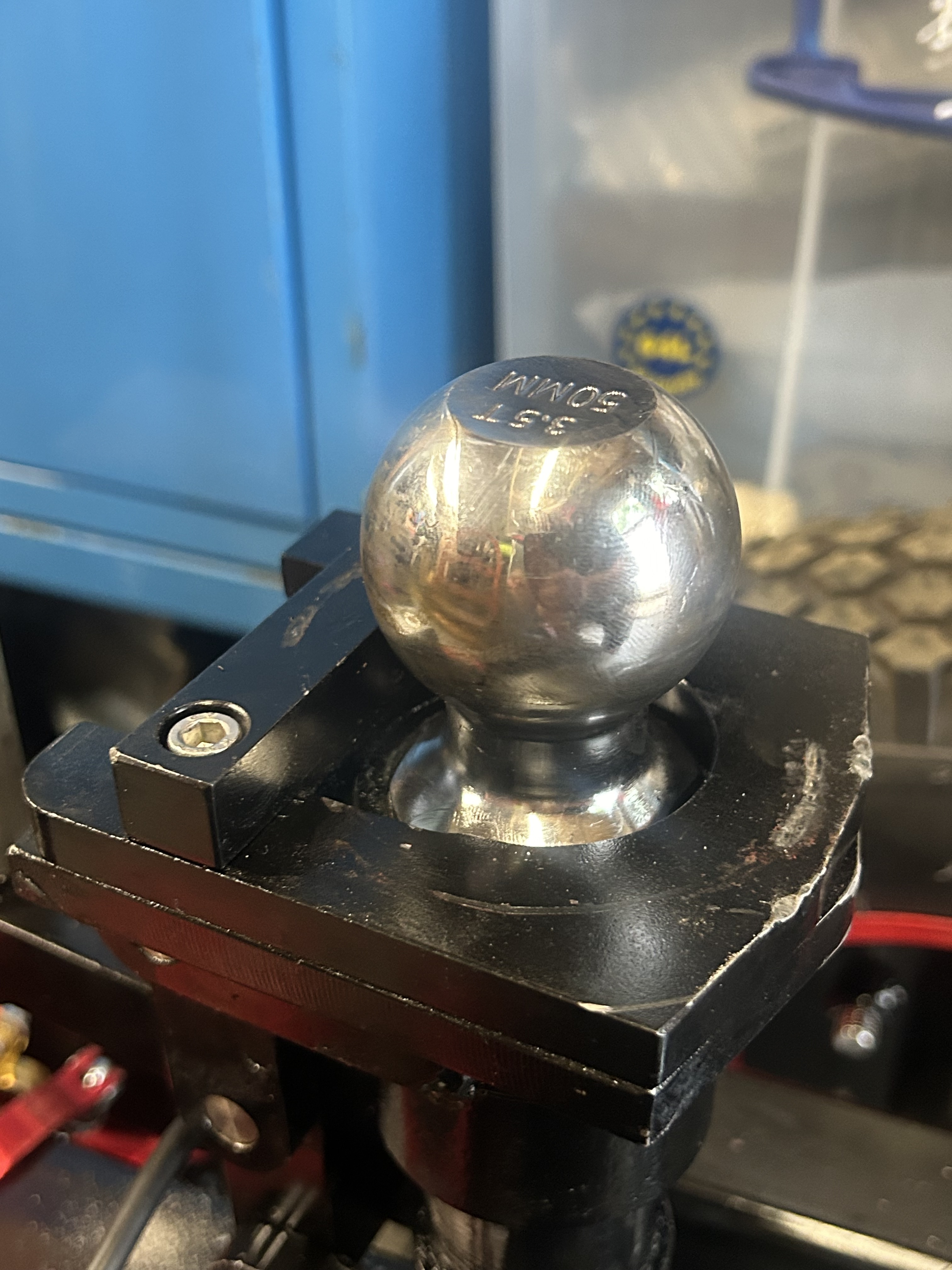

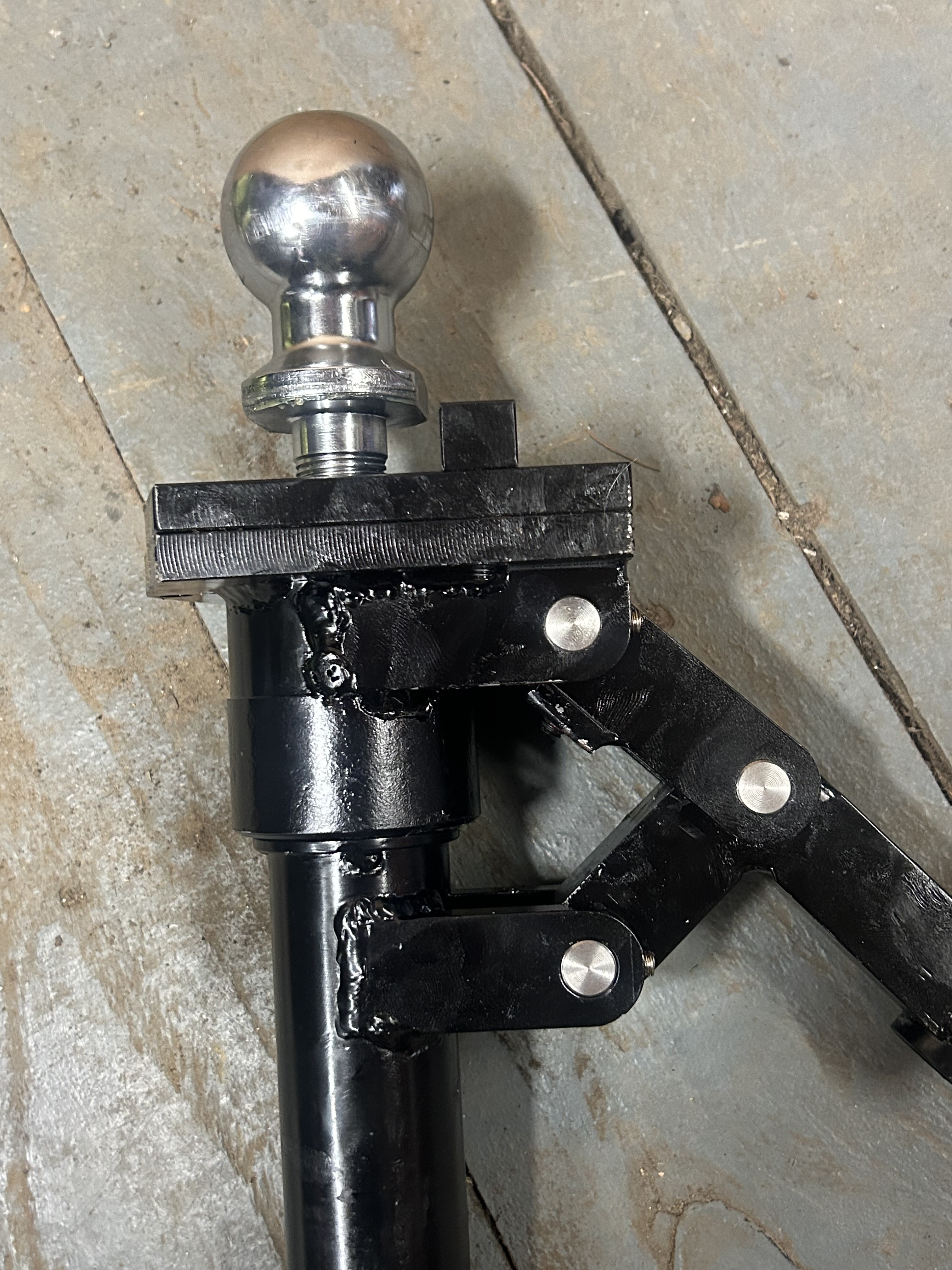

The trailer mover I built has a ball locking mechanism to prevent the mover from slipping out when under power.
The mechanism is based around a commercially manufactured trailer mover sold in Canada and the USA.

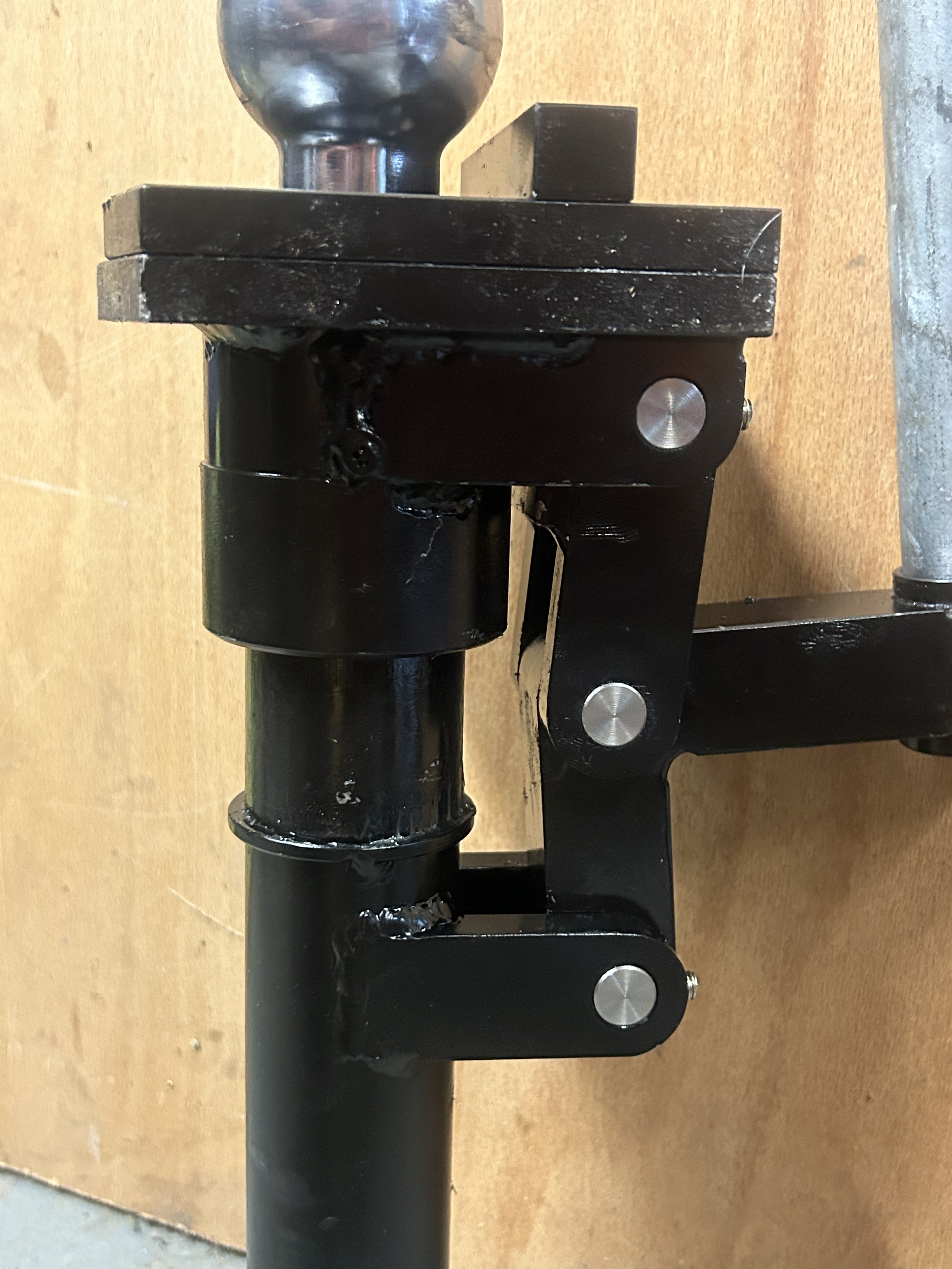

The system is a toggle lock over centre clamp. To maintain correct pressure the tow ball can either be screwed up or down and clamps to the plate below the ball. To overcome different ball hitches the plate is interchangeable to suit.

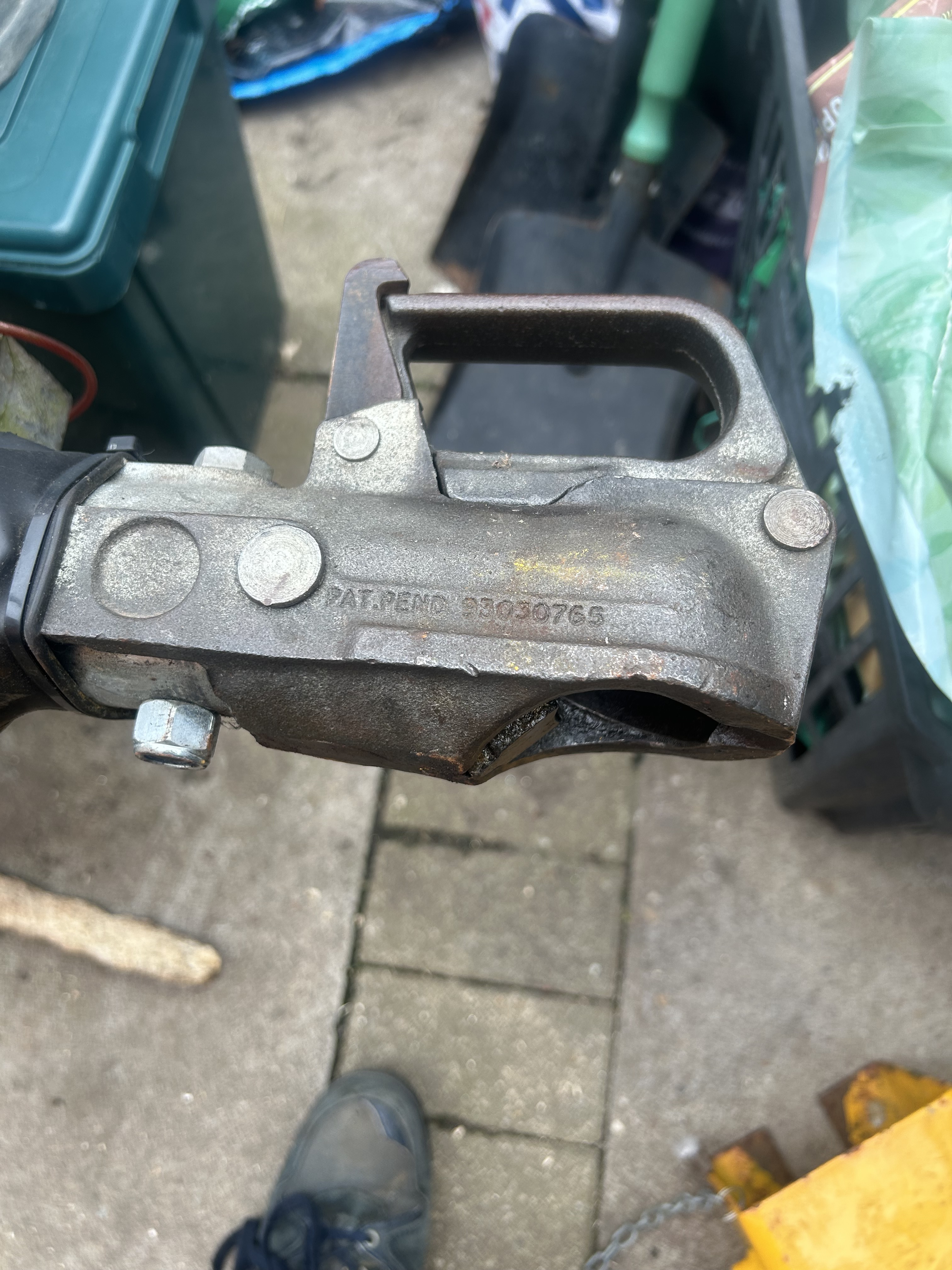

Attachment 47754 Attachment 47755 The different hitches on my trailers

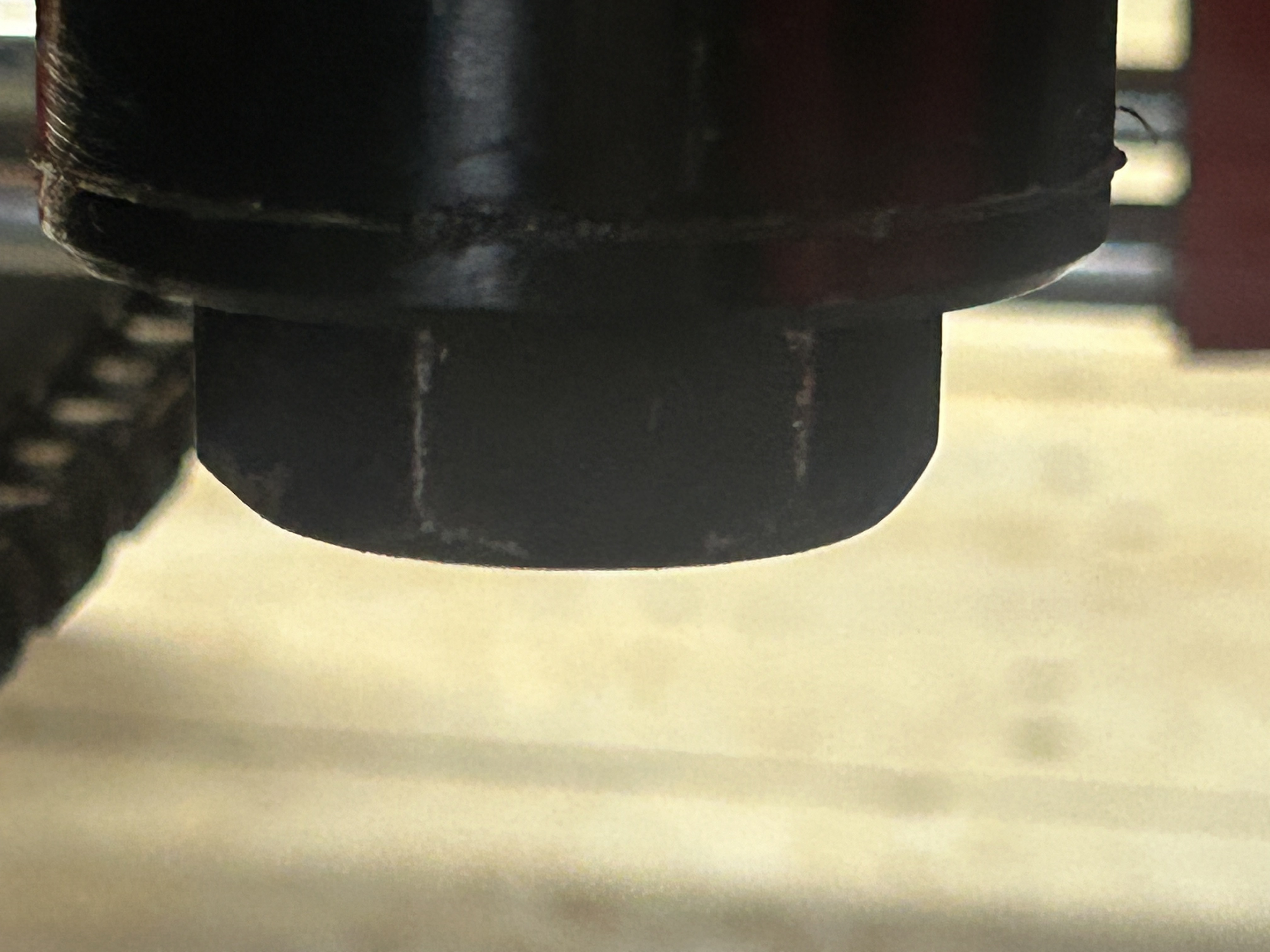

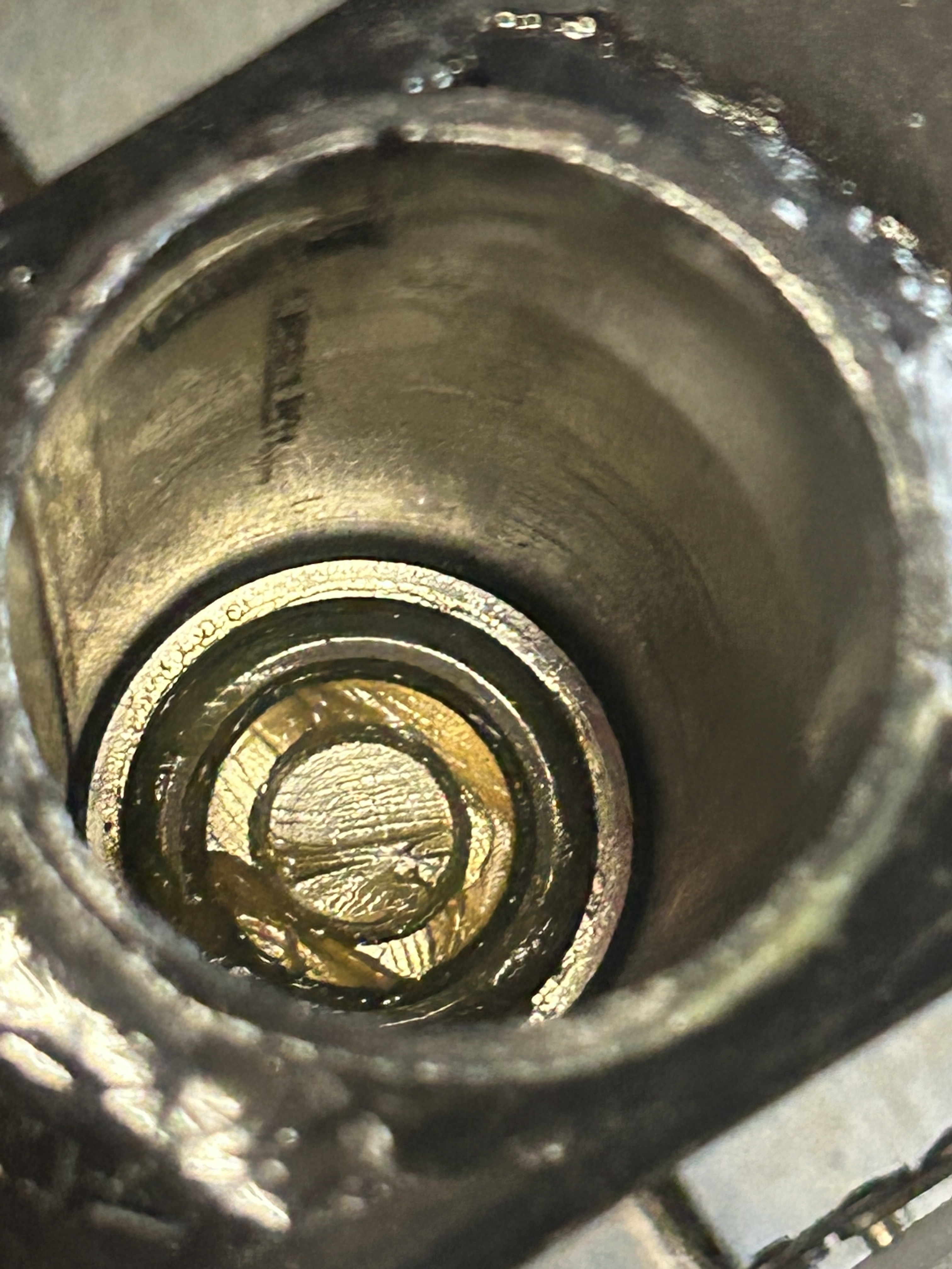

Attachment 47756 Attachment 47757 Taper roller bearing in bottom of steering column to assist turning when ball is locked in place.

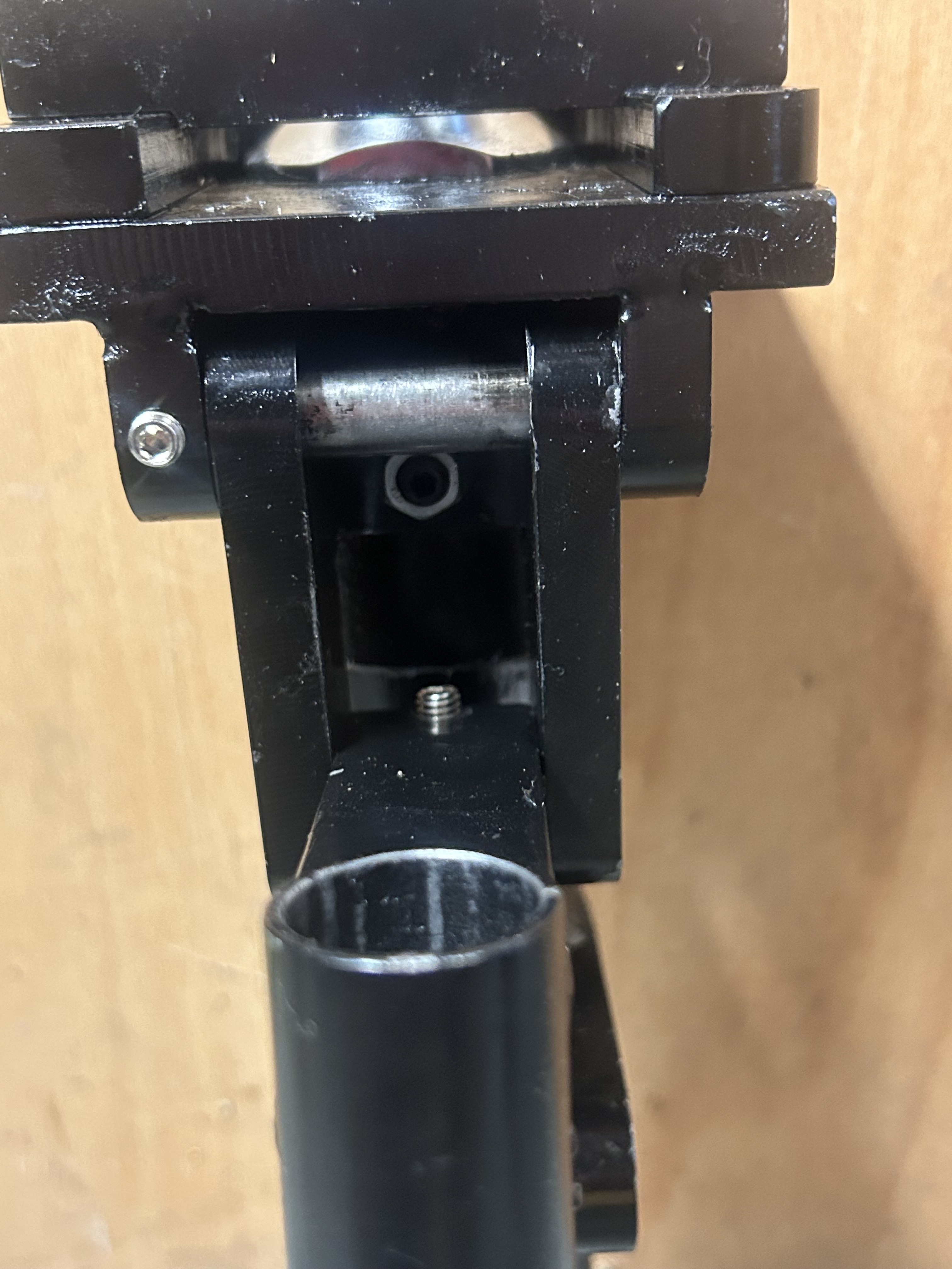

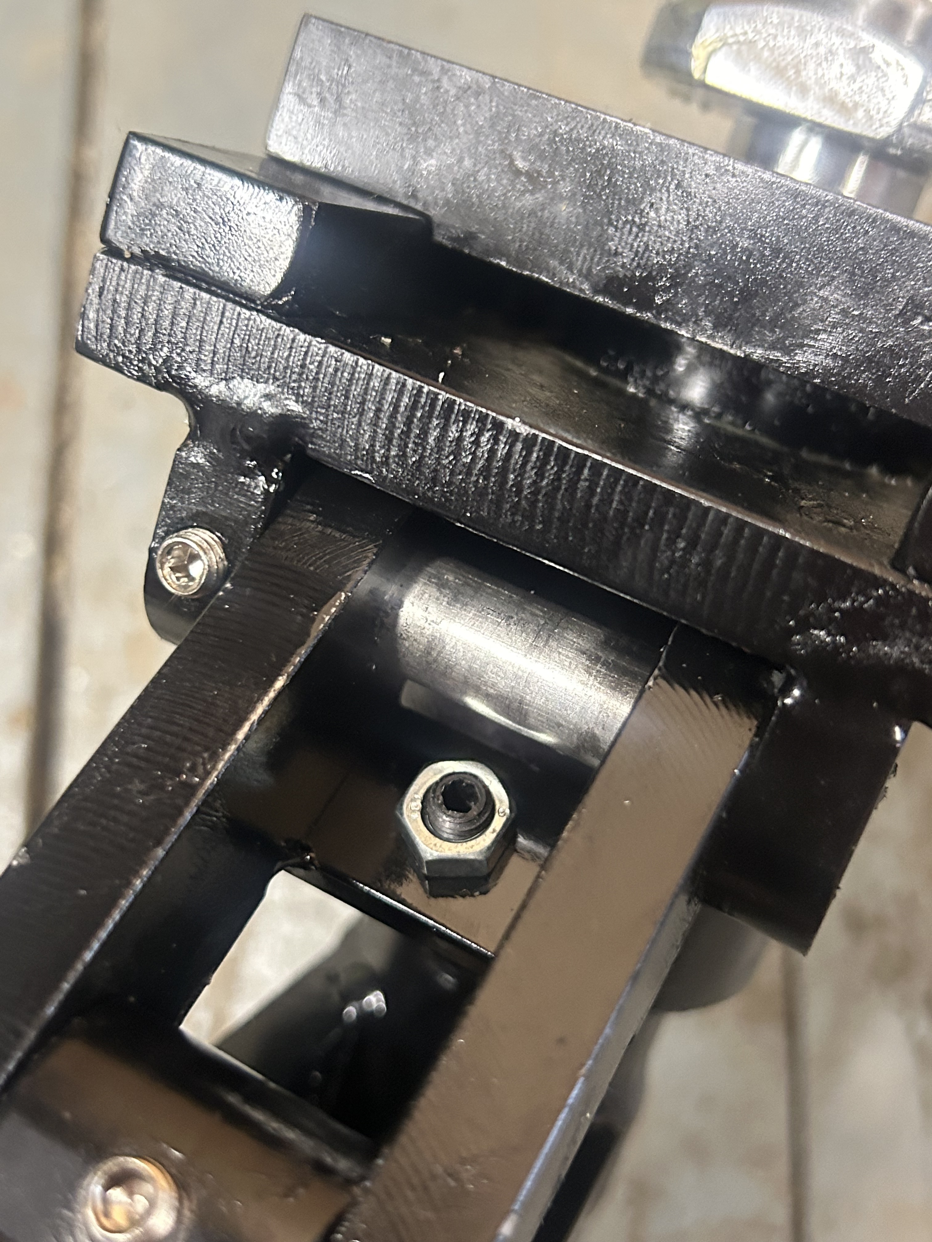

Attachment 47759 Attachment 47758 Attachment 47760 Toggle clamp mechanism.
Attachment 47761 The grub screw and locking nut allow the clamp to be adjusted so it clamps just over centre.
Attachment 47762 Attachment 47763 The plate can be modified by screwing additional parts to fit the hitch on trailer.
