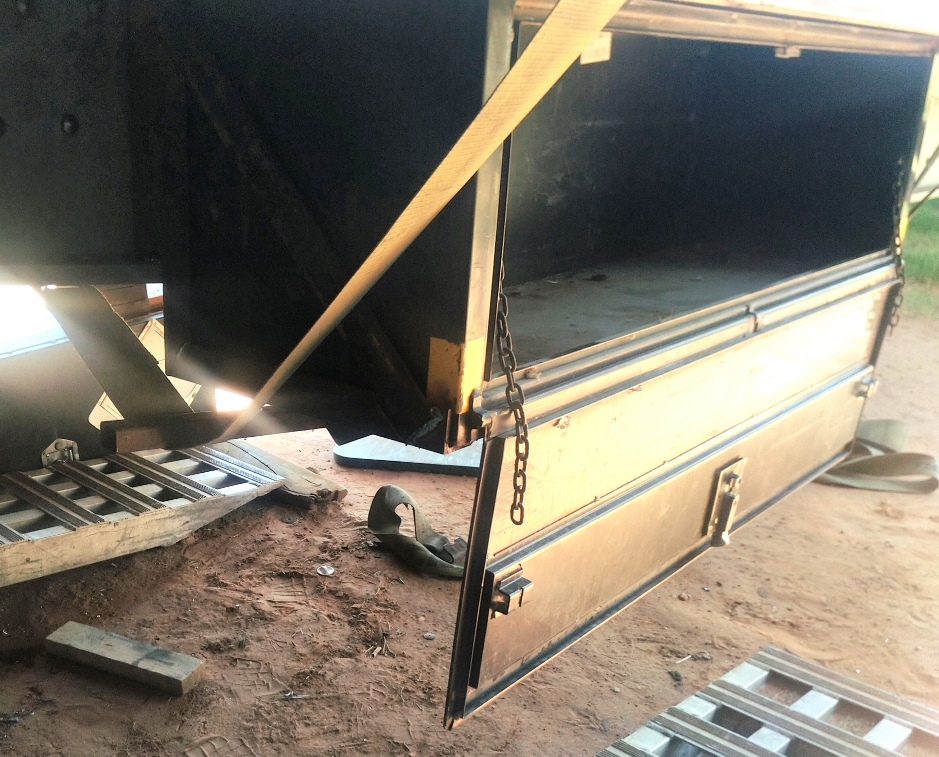

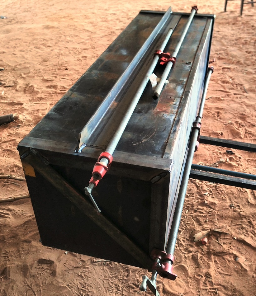

The side mounted tool box on the step deck had finally give up the ghost after 8 years of bounding on the highway so I mounted new boxes with an angle iron frame unlike the previous box had been mounted using only bolts through the box.
Attachment 46043

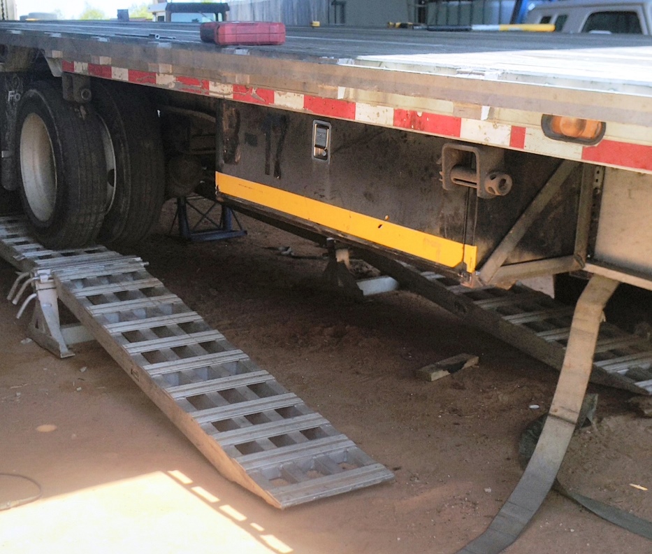

I used ratchet straps to hold it in place until the holes could be drilled and bolted in place.
Attachment 46044
Attachment 46045
