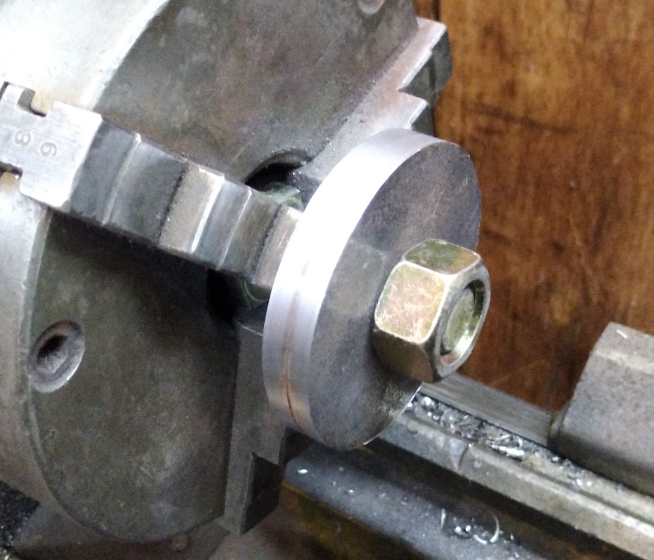

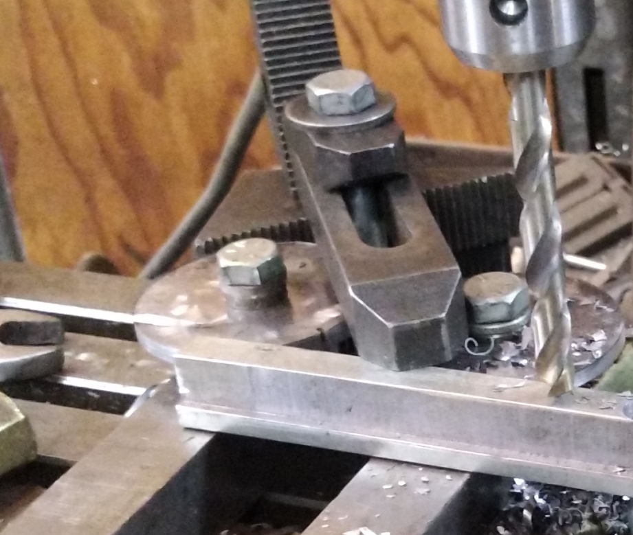

In getting ready to make a batch of T nuts I decided that I wanted to make a pair of stand offs to slip over the tramming posts of my riser blocks this would allow me to key off of the milled edge rather than the bottom of the T This was more for clamping convenience than anything else while drilling the holes.
The stand offs are a simple close ID match washer to the OD of the post and turned to the same OD to allow themilled bar to be positioned directly over a slot in the mill table More on that in another thread.
