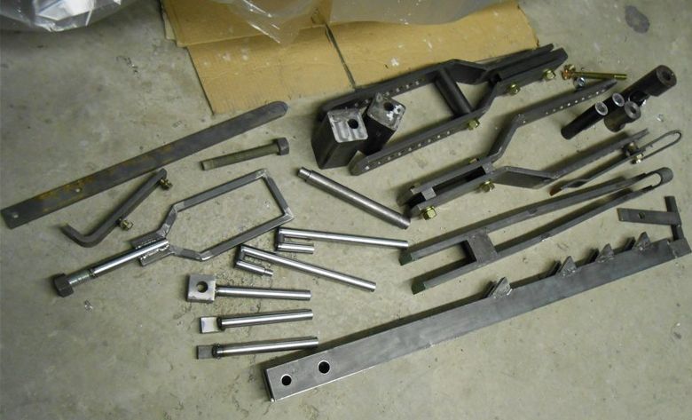

Using some plans I found online, I'm nearing the completion of a reasonable facsimile of a Hossfeld No 2 bender. Those plans are here: Bender Similar to the Hossfeld #2 A few mistakes I found but overall it's been great!
I've made many of the normal tools for it already but thought I'd ask about this one for bending flat stock edgewise.
It uses the 50B and 51B2-1 tools (and some smaller parts)
I'm looking for any dimensions on these to help me build them. They are cast pieces from the factory but I'm making from steel.

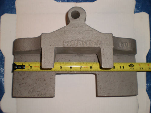

This is a pic I found of the 50B:
Attachment 18849

Also, would love to get any dimensions for other bits and bobs they have for this. I did make the basic stuff but lots I can still do.
