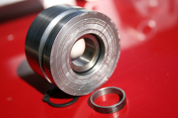

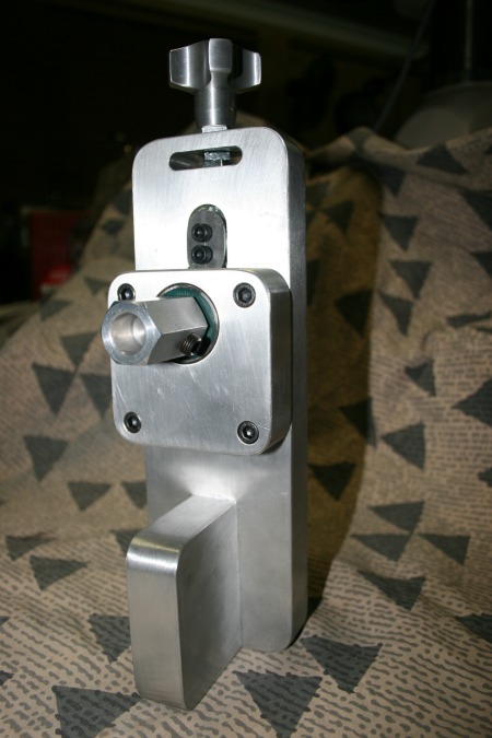

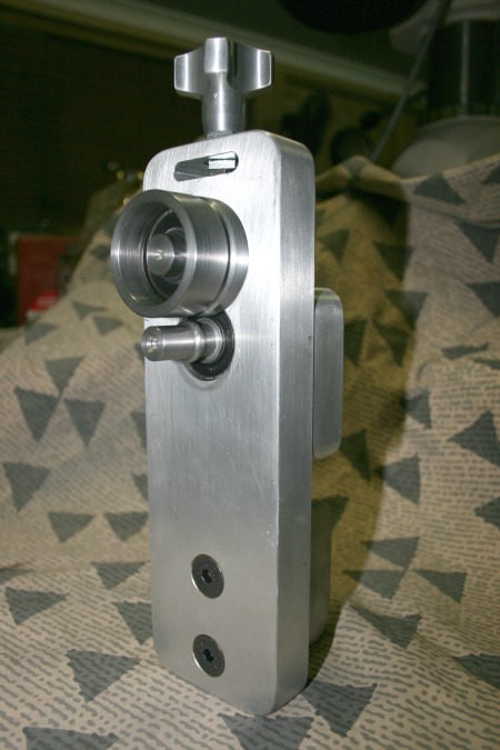

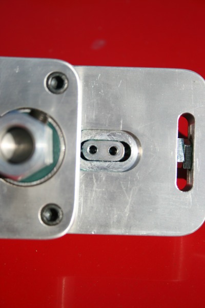

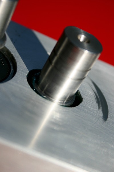

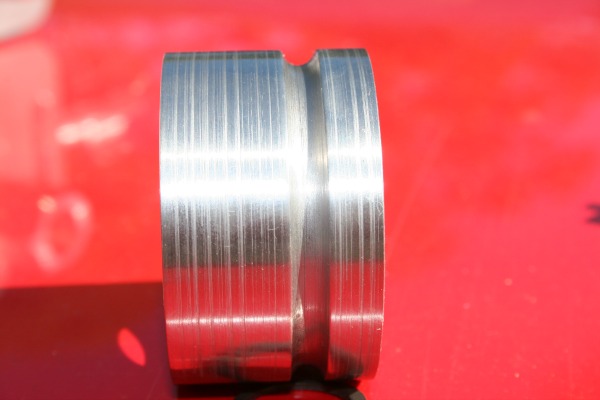

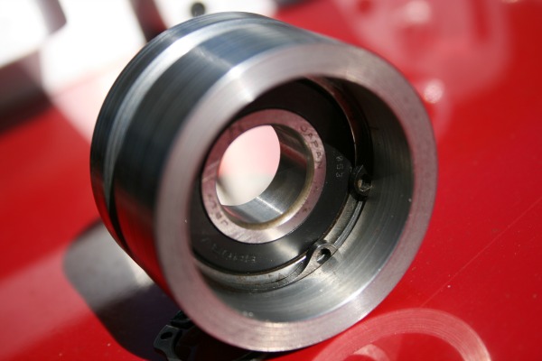

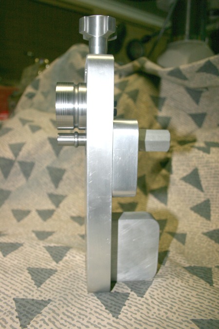

My latest tool project is a bead roller for forming a bead on the end of a tube. I need to use this tool to make new engine coolant tubes for my racecar. It could also be used to make intake tubing for turbo applications.
I saw the design concept on the net, and made my own version.
Attachment 3583
Attachment 3584
Attachment 3585

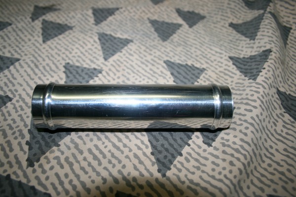

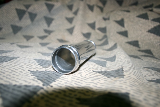

This is a small test piece to show the results.
Attachment 3586
Attachment 3587
