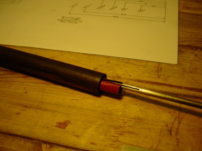

Once the bore hase been reamed, or after the tone holes have been drilled, you may need to smoothen the bore.

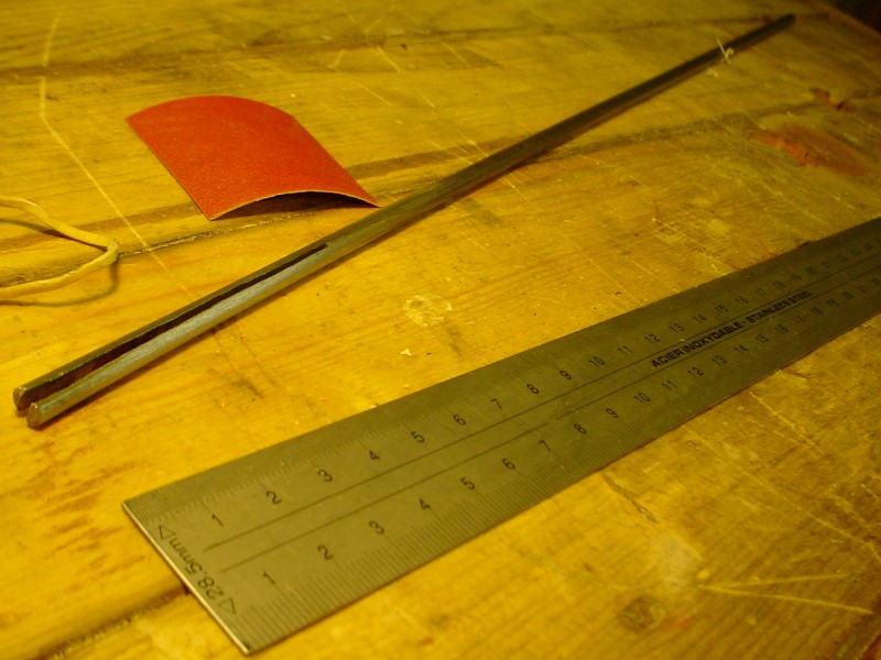

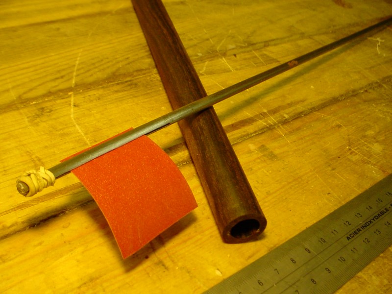

This tool is called a "mouche" in French (means a fly), this is a very old trick, to hold a piece of rigid sand paper at the end of a shaft, powered by an electric drill
http://www.labellenote.fr/file/homem...s/Mouche_1.JPG
http://www.labellenote.fr/file/homem...s/Mouche_2.JPG
http://www.labellenote.fr/file/homem...s/Mouche_3.JPG
