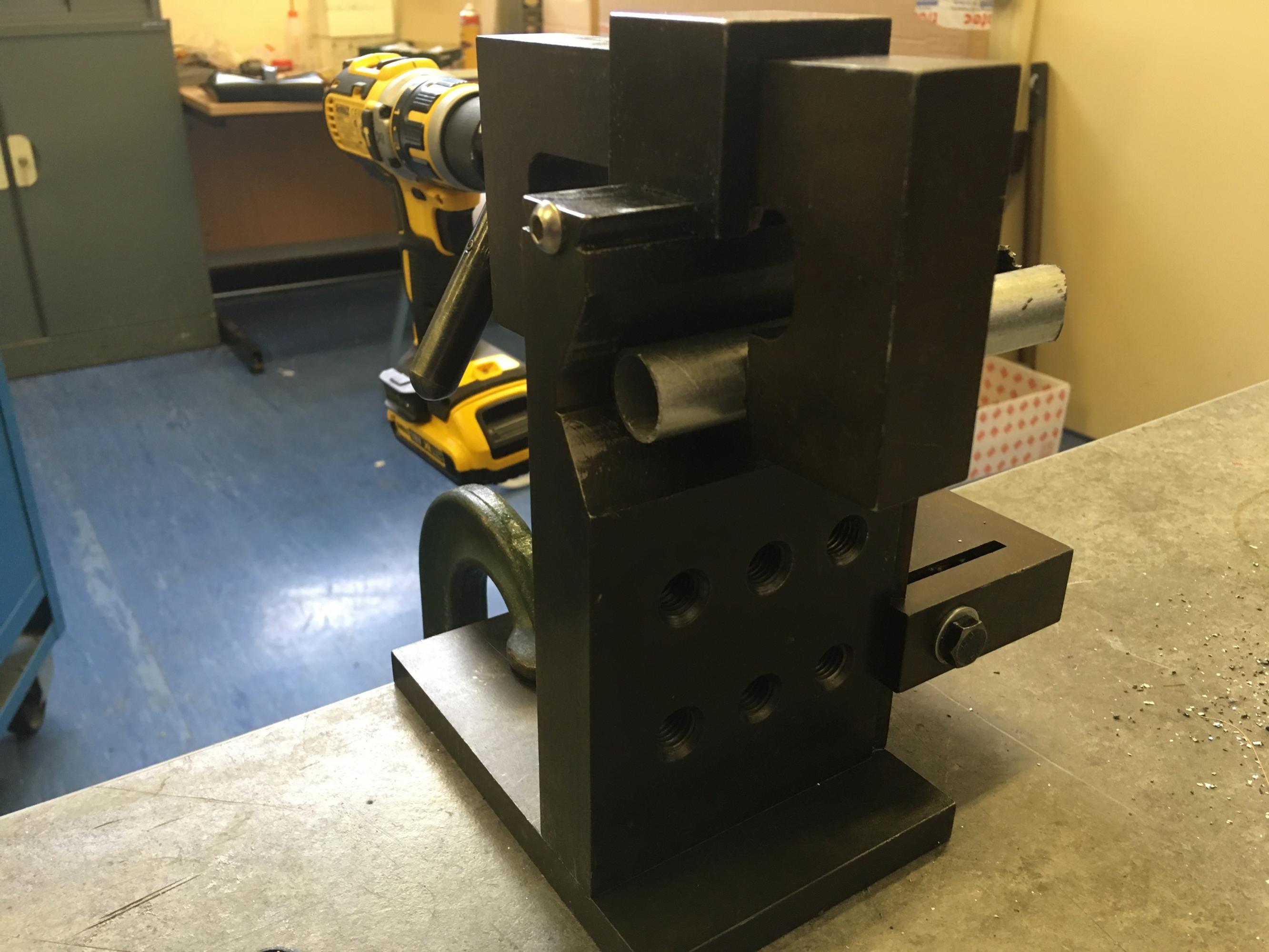

Hi All

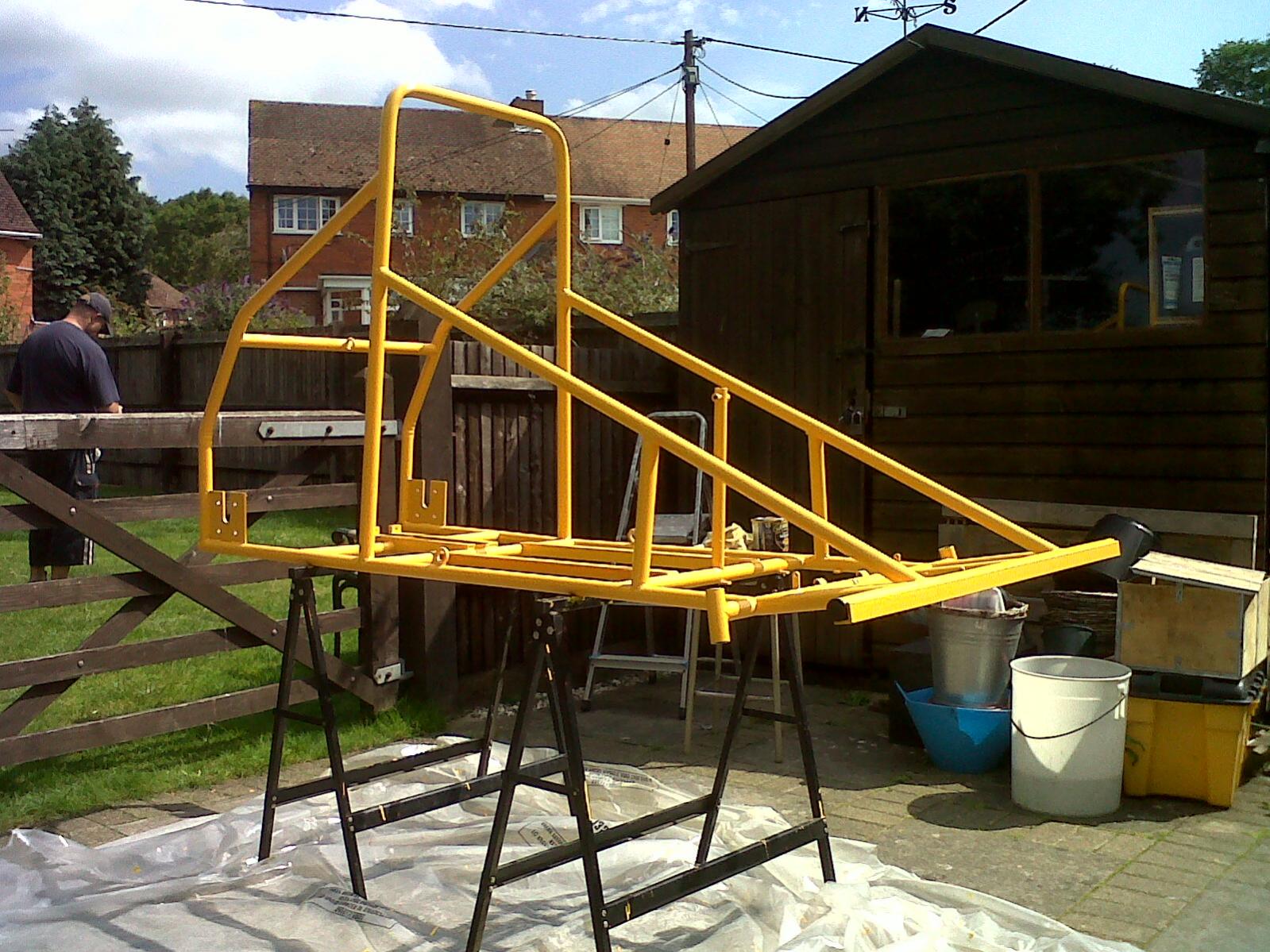

This is a tube notching jig I made about 7 years ago based on the Notchmaster Hole Saw Tube Notcher, but at £350 plus pounds at the time I decided to make one. I also wanted to be able to notch square stock tube,angle iron as well as round tube.
Initially I made it to make a go-kart for my son to notch the tubes for the chassis.
Attachment 23281
Since this project, a friend borrowed it to make a roll-cage for his mini and it has supported other projects I have been involved with.
Today I have used the notcher again as I am helping a friend build a petrol yard brush for leave clearing and I am building the chassis for it.
Below are some photos of the notcher.

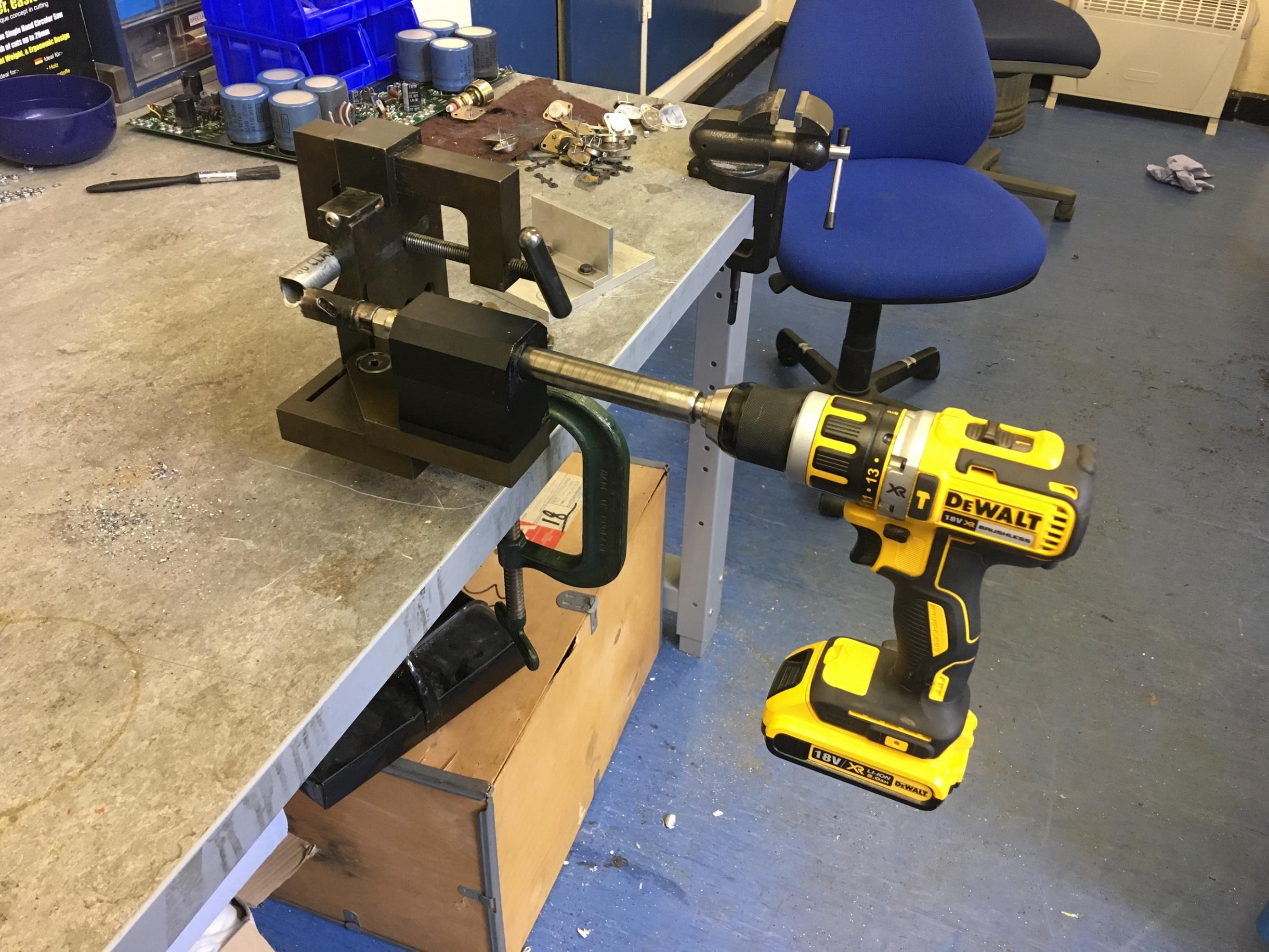

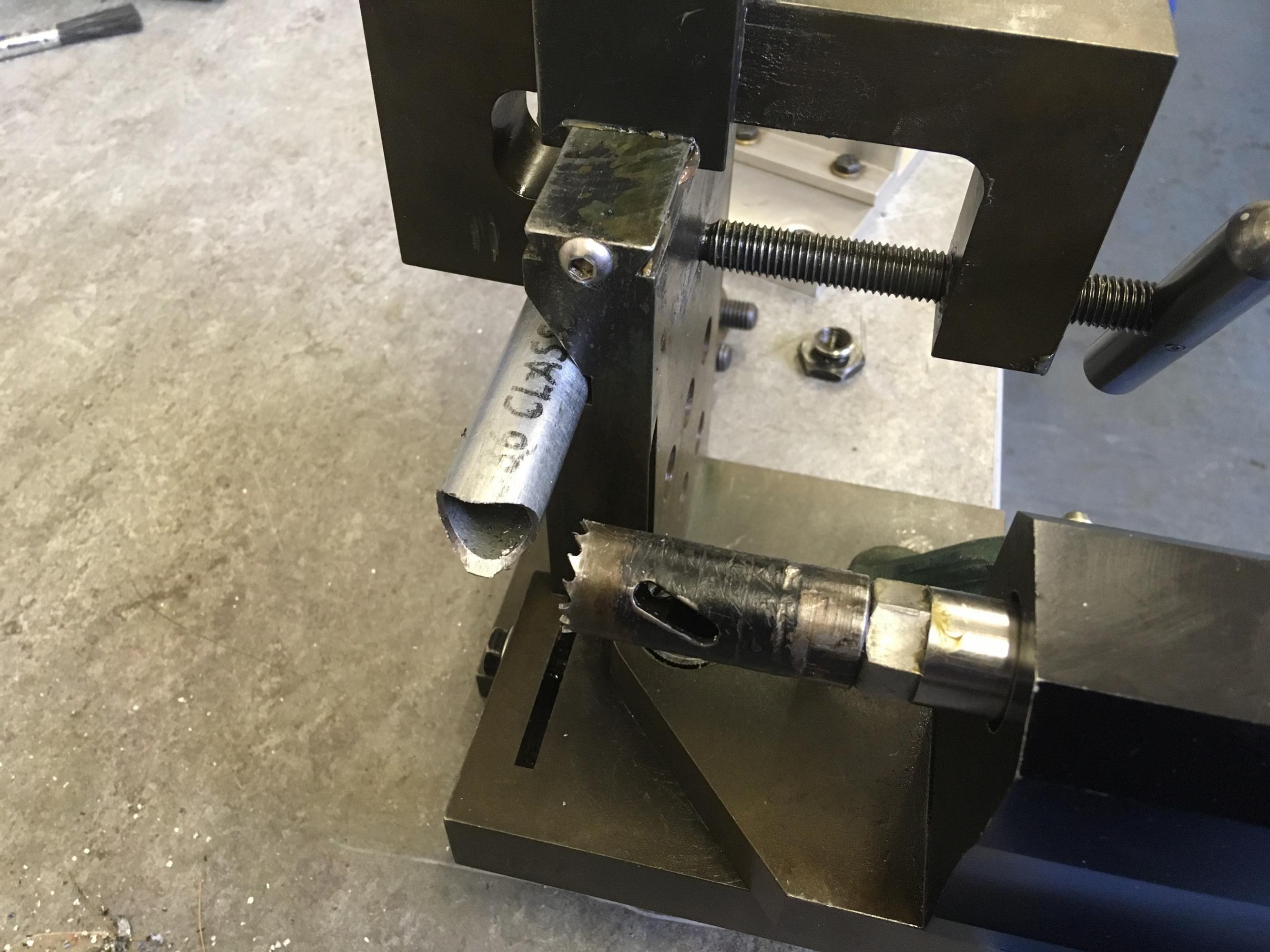

Notching round tube
Attachment 23279 Attachment 23283 Attachment 23282

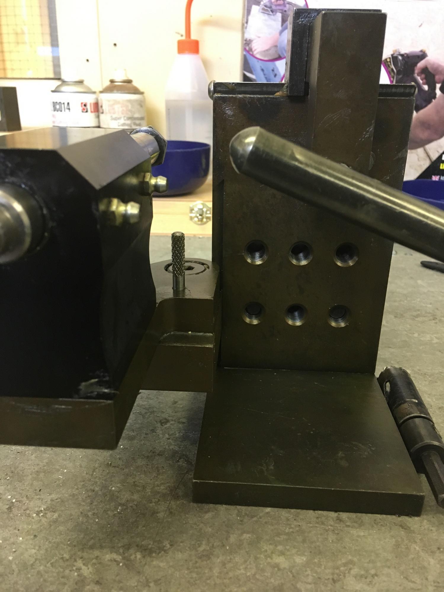

Front and rear view of jig

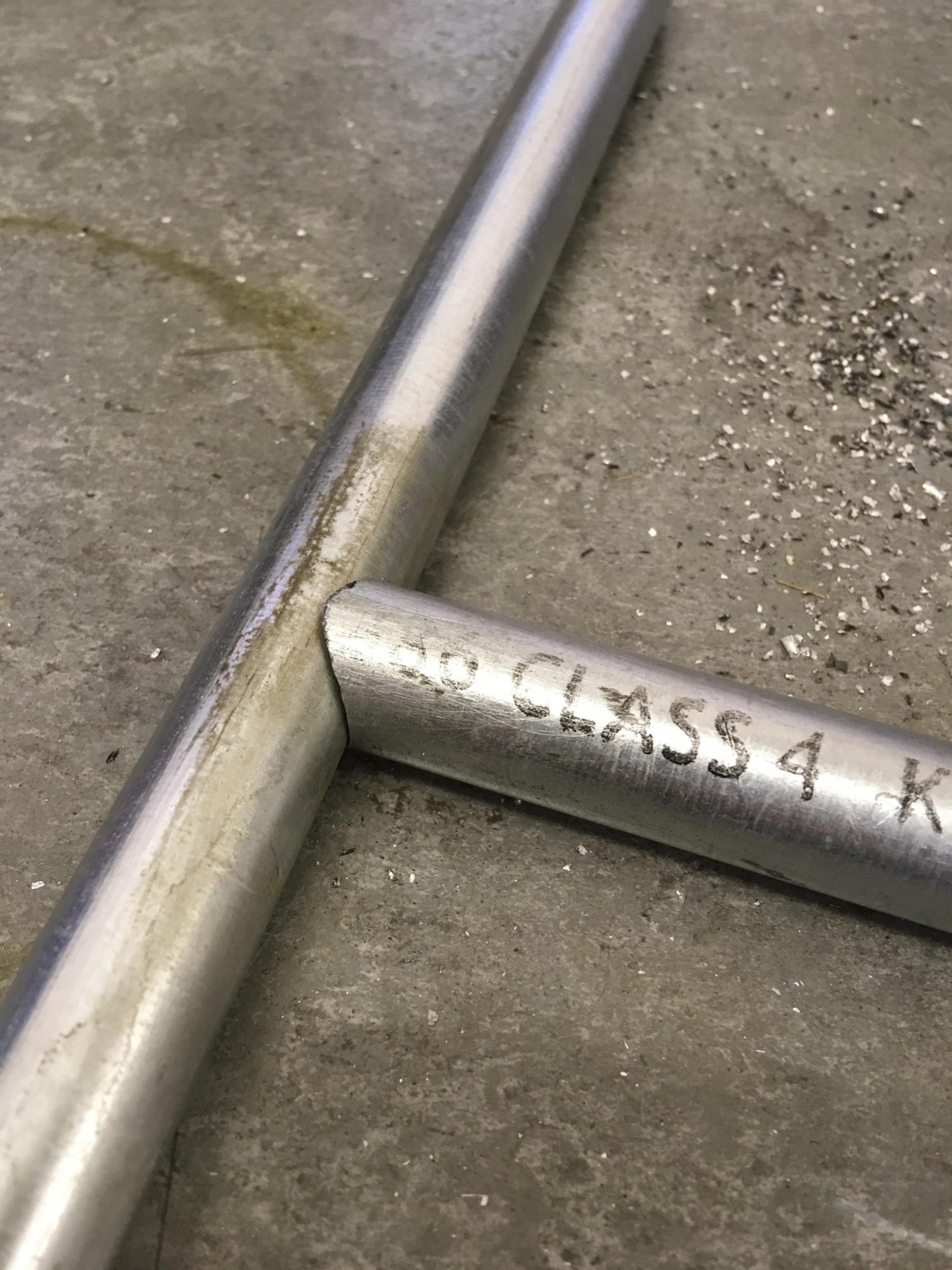

Tubes ready for welding

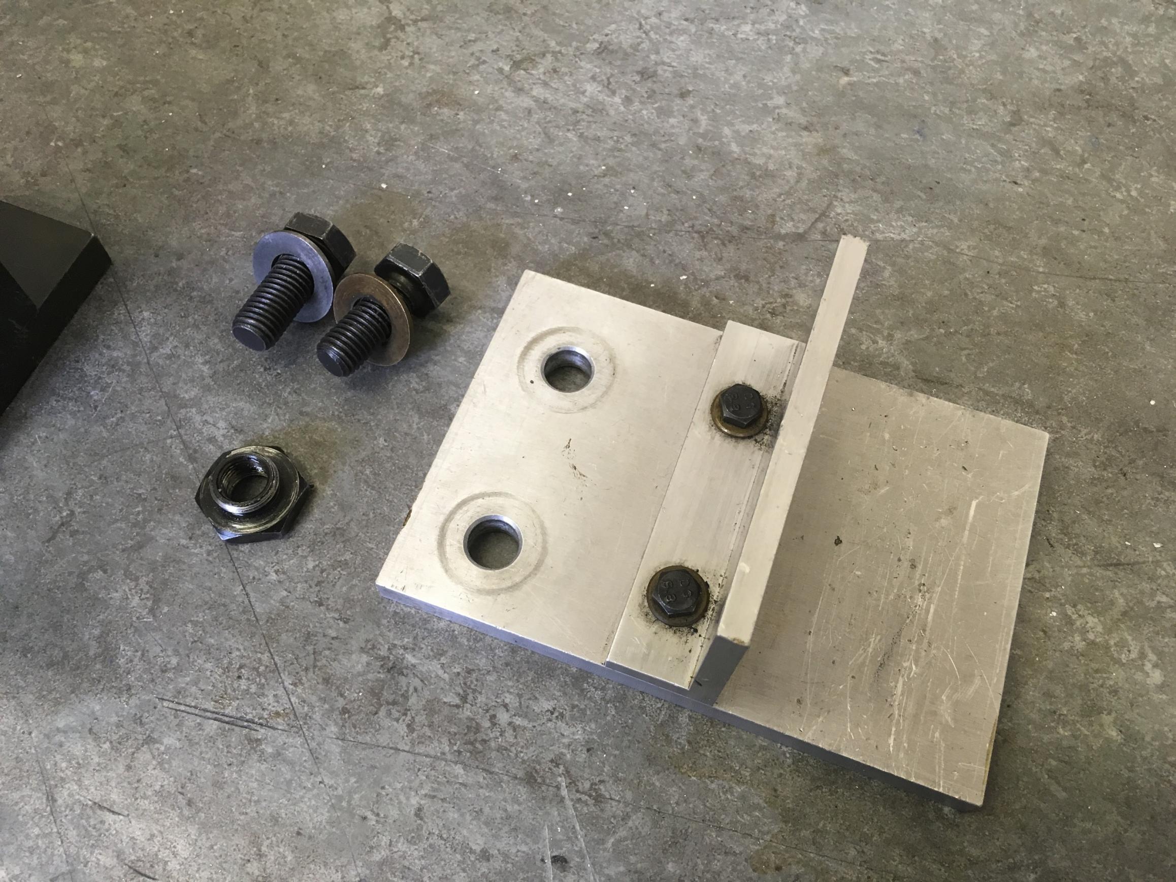

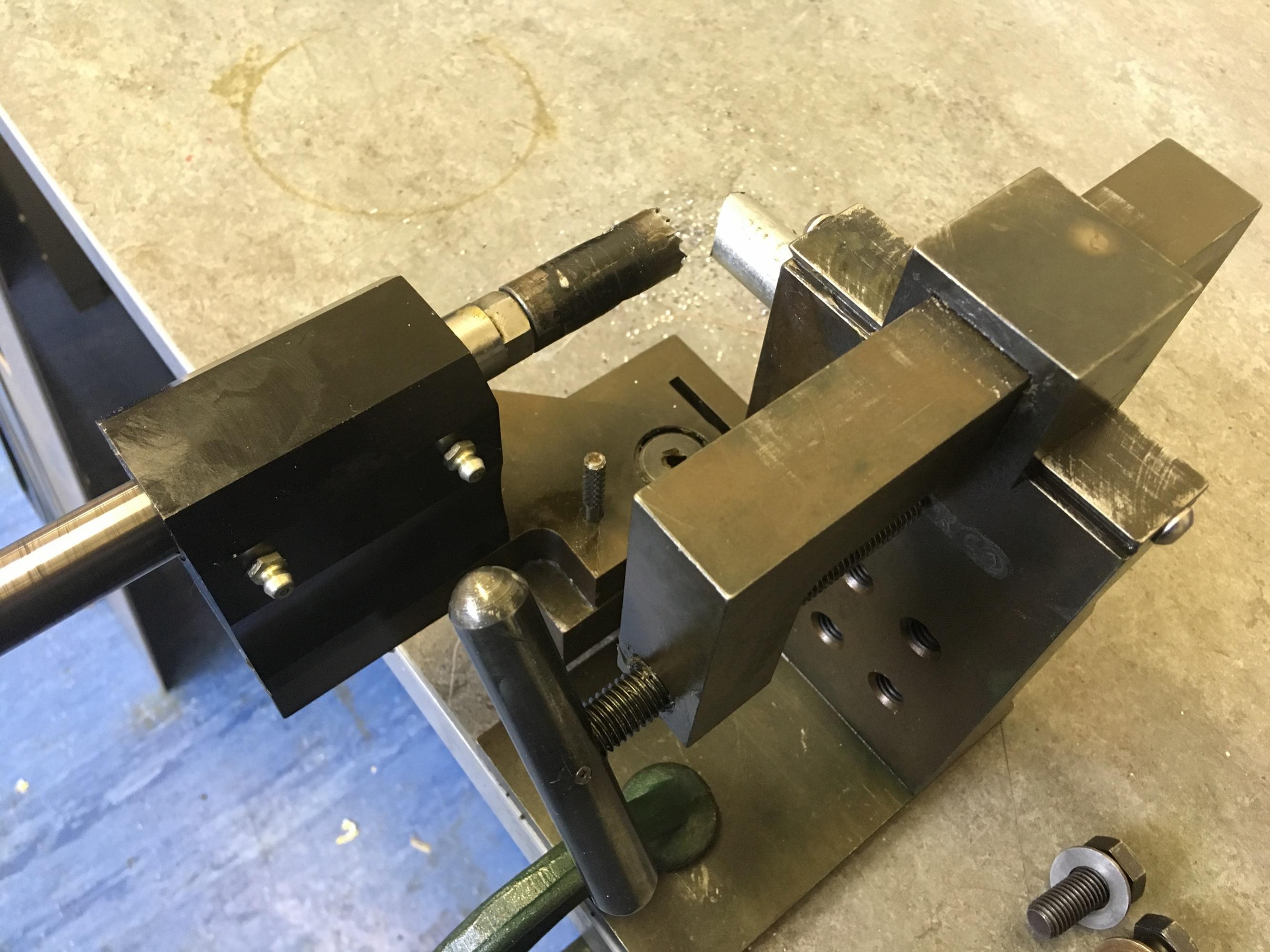

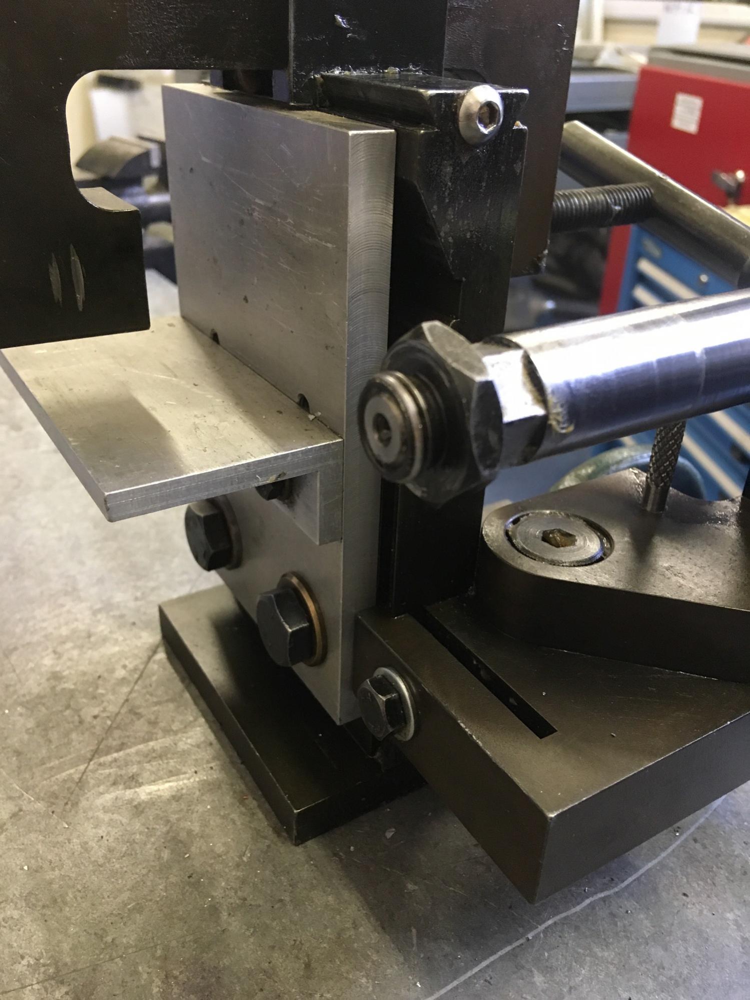

Square tube and angle iron attachment. Also adapator nut on the end of hole saw shaft to accept larger hole saws
Attachment 23278 Attachment 23286
