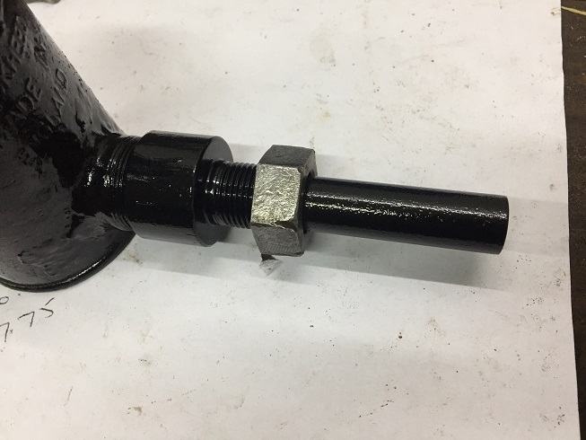

Today is fitting the brakes the the '48 MG TC.
I ran into a problem right from the start. I needed a tube socket to fit it. On top of that it was no standard imperial size.
Attachment 28729
Attachment 28730
Attachment 28731

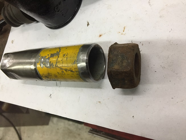

I could not find the right size pipe to heat up and persuade over the nut to form a tube socket so had to make 6 cuts, persuade the pipe to take the shape of a nut and then weld up the corners. Initial idea was to add a thick walled pipe to the back and simply drill a couple of holes for a bar to be fitted to turn the socket.

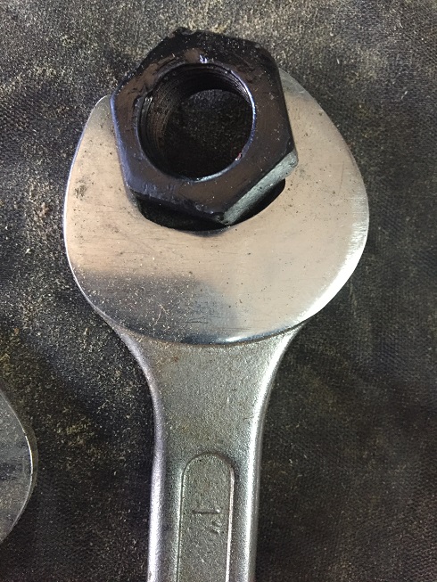

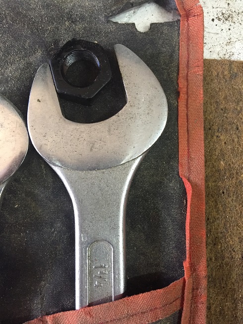

But the scrap bin revealed a nice large stripped nut....Inch and a quarter once cleaned up to stay with the imperial theme.

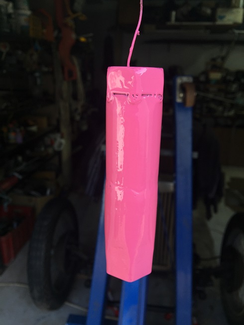

And finally with my grand daughter pink to stop rust and to make finding the tool easy.
Attachment 28733
