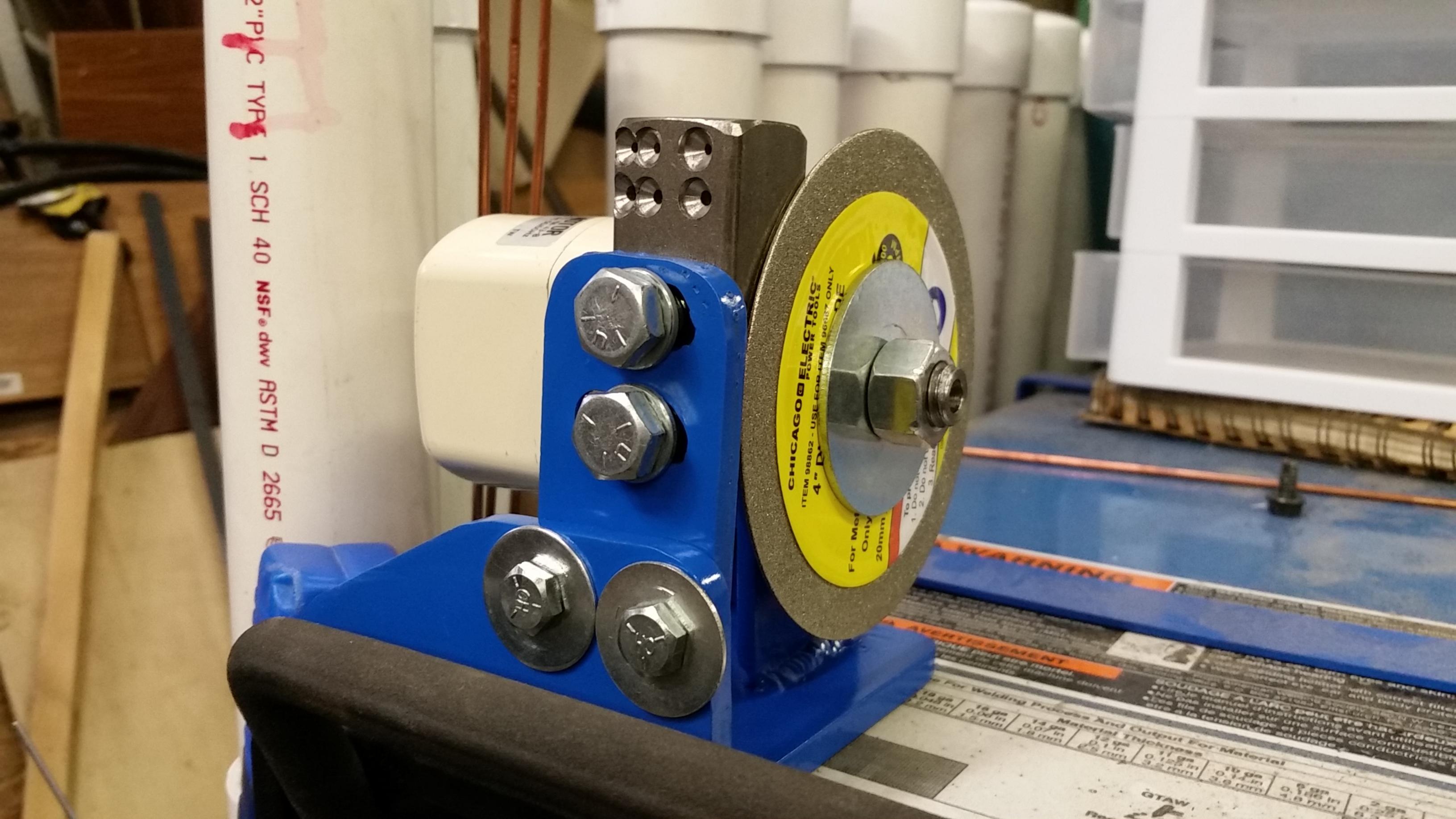

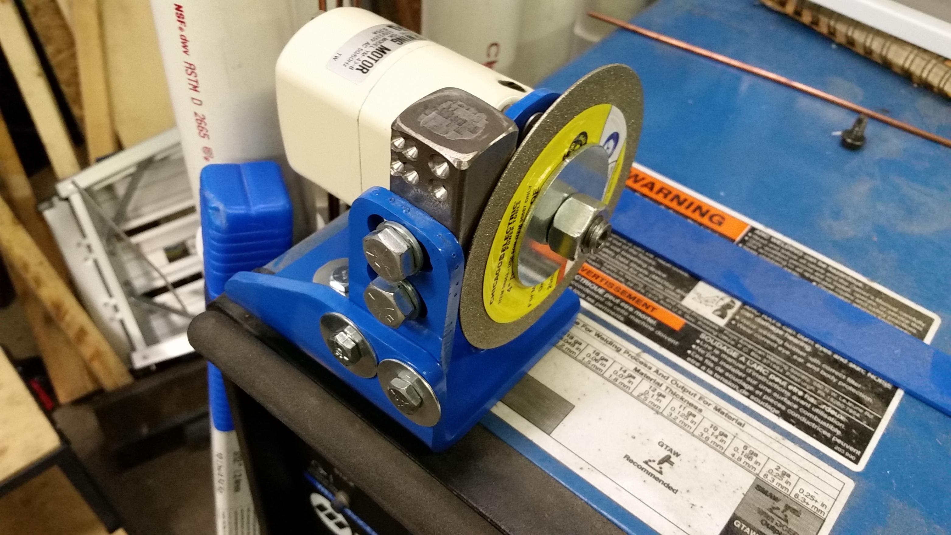

Made from a re-purposed Sewing machine motor. Machined a 1" thick block with the correct angle for Tungsten tapered point, for both 1/16" and 3/32" Tungsten. Using a HF Diamond wheel.
Works Awesome!Attachment 13192Attachment 13193
