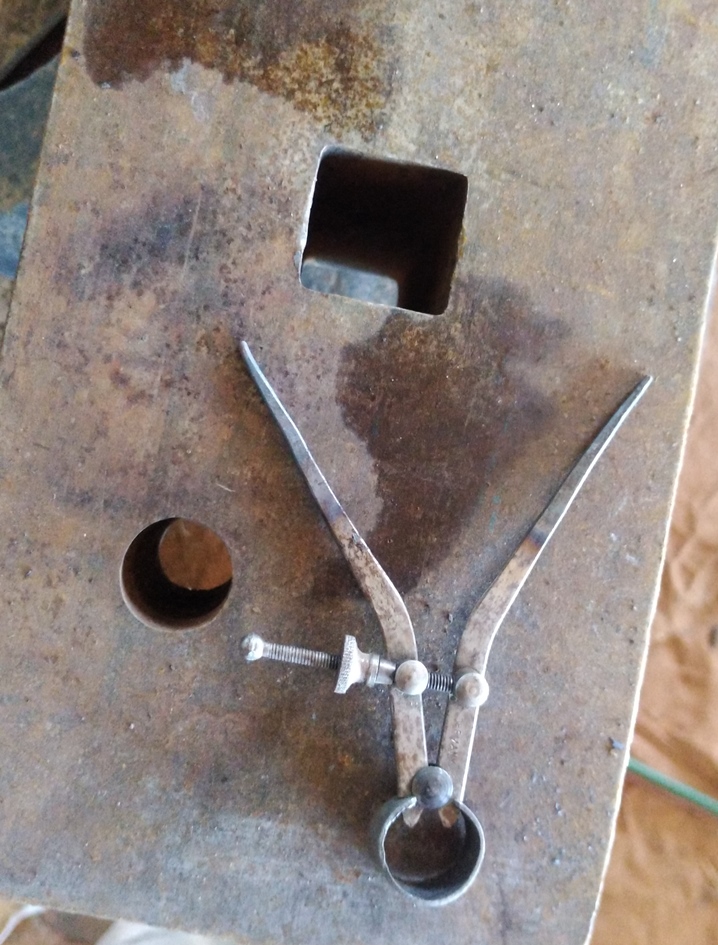

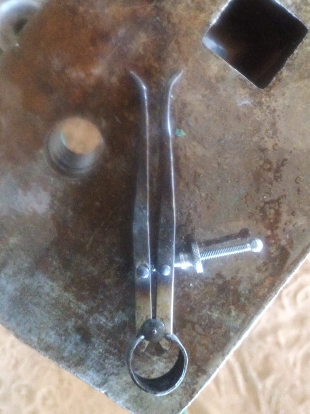

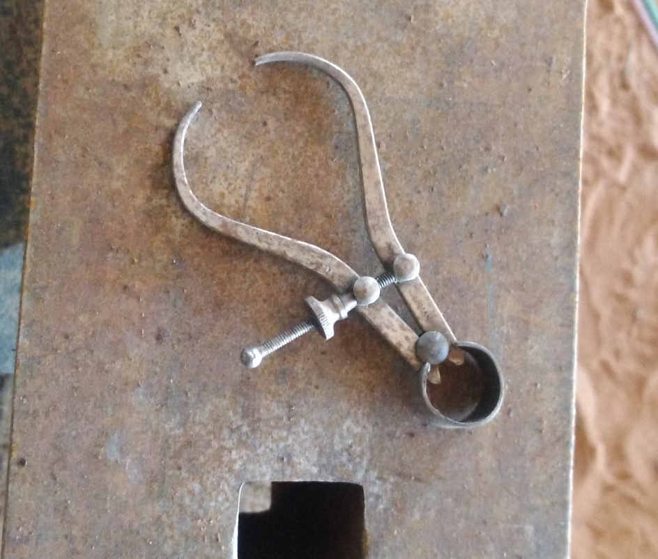

Turning outside calipers inside
My smallest inside calipers could not even be forced into a 7/8" ID tube and I needed to verify a 1" counter bore about an inch inside the opening
So I modified an old pair of outside calipers to be inside.

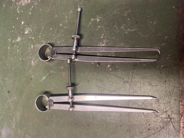

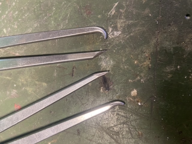

2 Attachment(s)
Odd leg Jenny modification
Hi All
Frank I hope you don’t mind me high jacking your post. But one of the best modifications I made, was to a set of odd leg Jenny’s. I use these all the time for marking out. Often there is a need to mark off from a shoulder, tipped sheet metal edge, flanged edge and casting etc. The main reason I opted for this modification was to aid marking out flanged edges from templates on copper boiler plate’s.
So I simply inverted the leg so it could run along the opposite side. Hopefully the photos below will make this clearer.
Attachment 41558 Attachment 41559
Many thanks again Frank for the original post
Link to original post https://www.homemadetools.net/forum/...185#post195737
