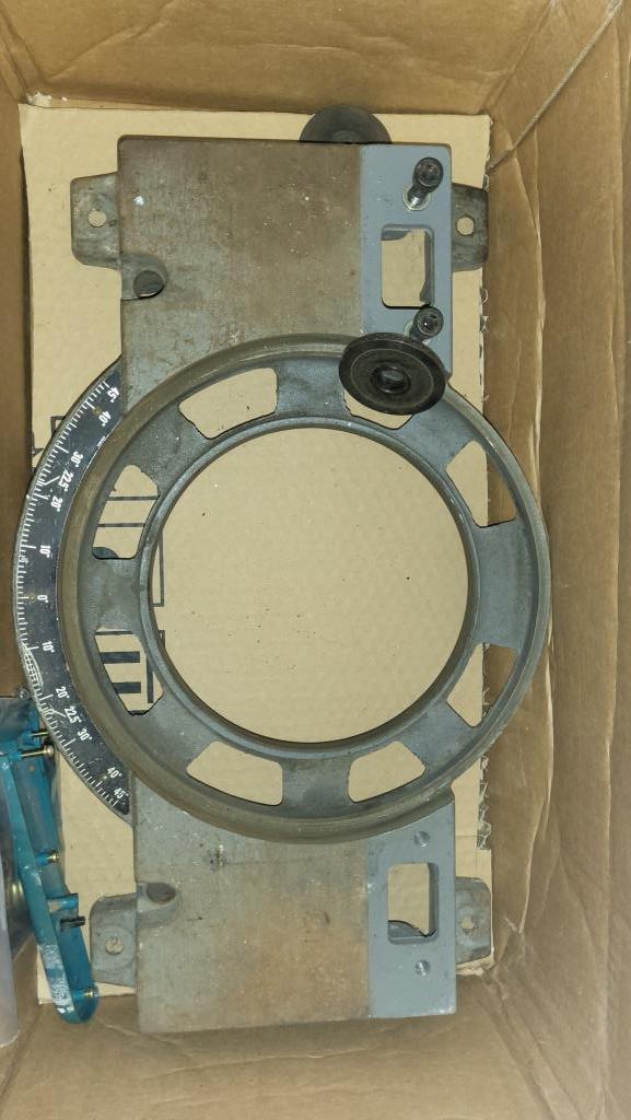

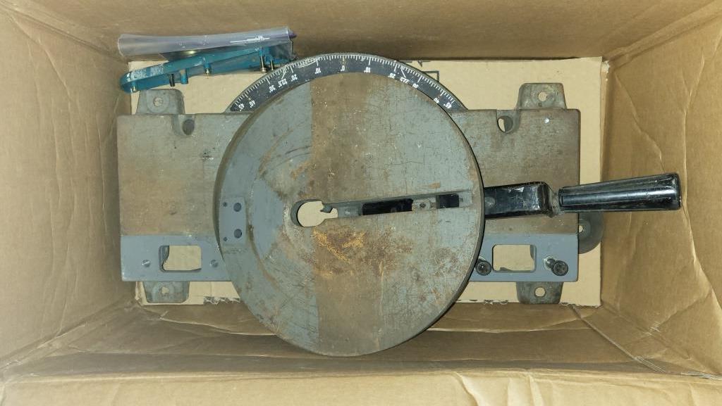

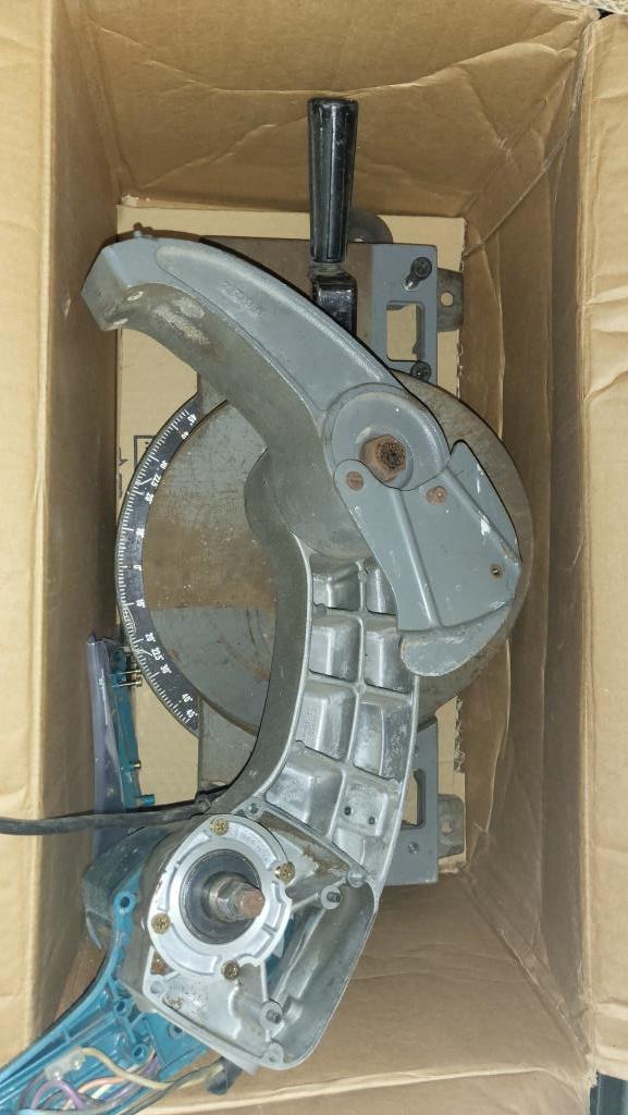

A very worthwhile project. Something I have been trying to get to for a while now. In a small shop, pivoting the saw and not having to maneuver the long stock is a huge benefit. I plan on having a wall rack for the stock and incorporate the pivoting saw in a roller table all part of the wall rack. I found a complete Makita cut-off saw on Craig's List for free. It had bad motor bearings but I only want the swivel base assembly. I will adapt my existing dry saw to fit this setup. Sorry about the incomplete nature of the pictures. I just wanted to reinforce your idea and hemmjo's post about using an existing system.

Yes I have also been thinking along the same lines , it would be much easier to modify an existing pivoting system. I will have to keep an eye out on the internet market places . As for the clamping system I would probably have that mounted more to the left and remove the existing clamp set up . Unless someone has different ideas on dealing with this problem?
I believe if cutting long stock, the vise does not need to be so close to the cut. Most miter saws have a clamping system mounted on the backside of the fence that presses down on the stock. The stock bears against the back fence, the clamp presses it down. The most difficult stock to cut would be rounds, where they try to spin, so they must be securely clamped.
