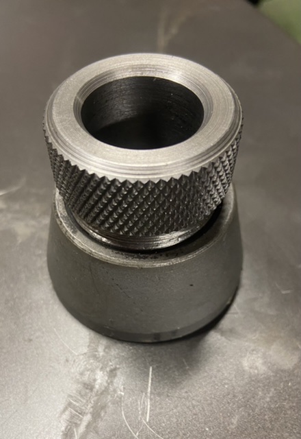

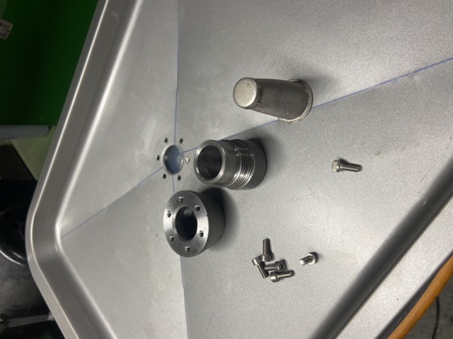

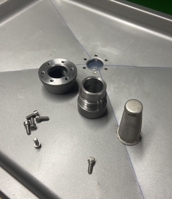

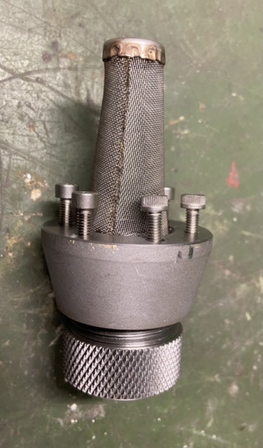

    Finally completed the coolant system on my 4x6 bandsaw.
    The system was in need of a filter to protect the pump from the swarf created by the saw.Many years ago I made some filters for a job and had a few spares left over. So off to the “one day I might use it,draw.” and there was two basket type filters.
    The only issue was as a basket filter they would quickly fill with swarf and would need constant cleaning. To over come this I decided to use the filter upside down this not only would prevent constant cleaning but a good visual view of the filter, so when a build up of swarf forms around the filter it could be easily cleared away with a brush and dustpan.
    The filter can also be removed from the housing if extra cleaning is required or if a replacement filter is needed due to wear and tear.
    The photos below show the filter housing, tray and filter in place.

    Very flash. Being a poor bugger I went with a shallow dish shape with cut-outs around the edge held down by Neodymium magnets. worked well so I made one for the lathe as well.

    Hi NortonDommi.
    Thank you.
    Luckily I had the filter so just needed to turn up the housing.
    The Drip tray is a cheap baking tray which I have made removable, for cleaning purposes, so I didn’t want a large surface area filter to drain the coolant back to the tank. As this would create the need for a large funnel type catcher under the tray or something attached to the tray which I felt would make it harder to remove the tray, so luckily the extra filters I made have finally got a use.

    Nice, having the drip tray removable must make dumping swarf a breeze.
