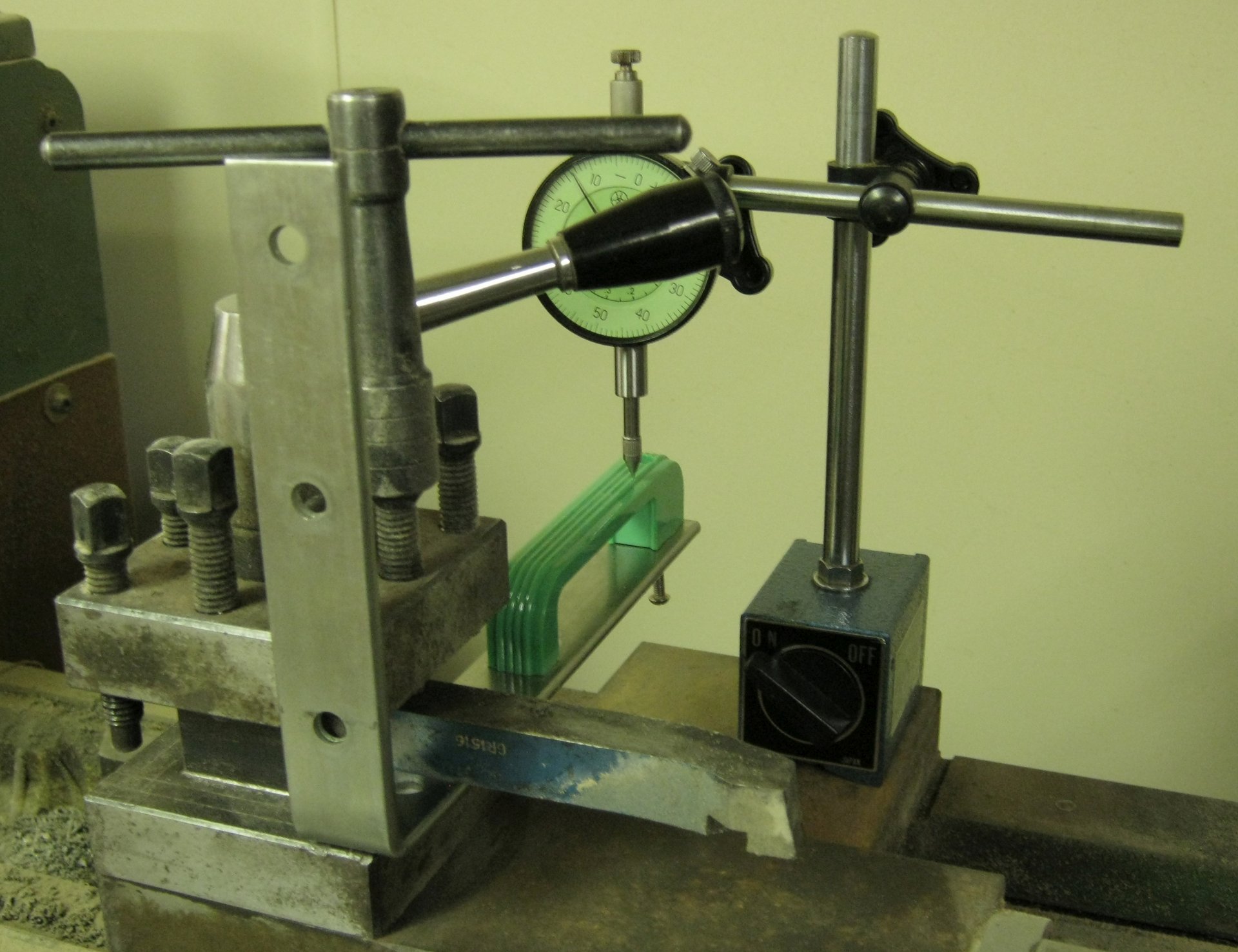

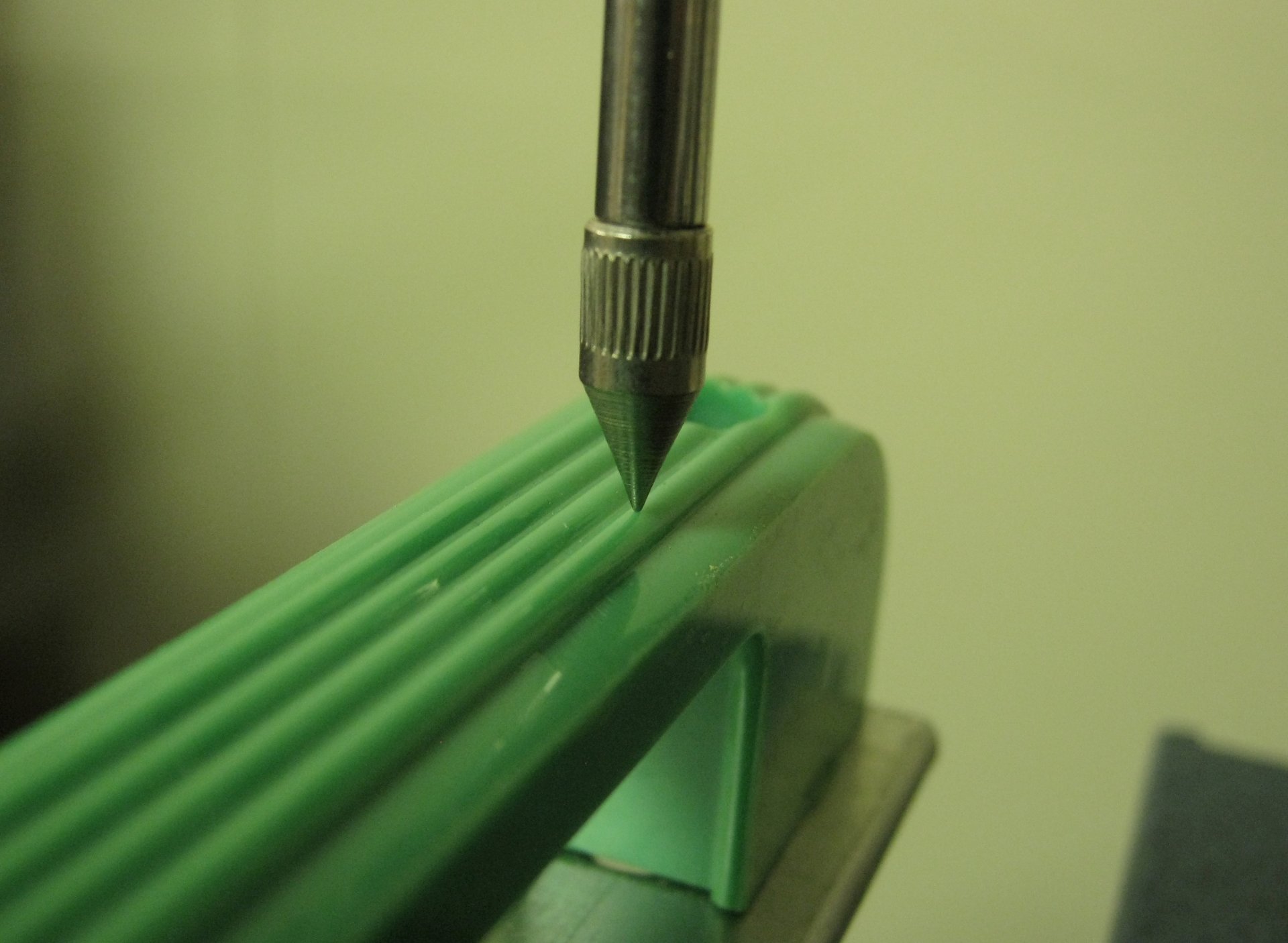

I needed a way to measure the shape of a cupboard handle and managed to do it with a dial indicator and lathe topslide. It take a while but gives great results.
Attachment 12742 Attachment 12743
