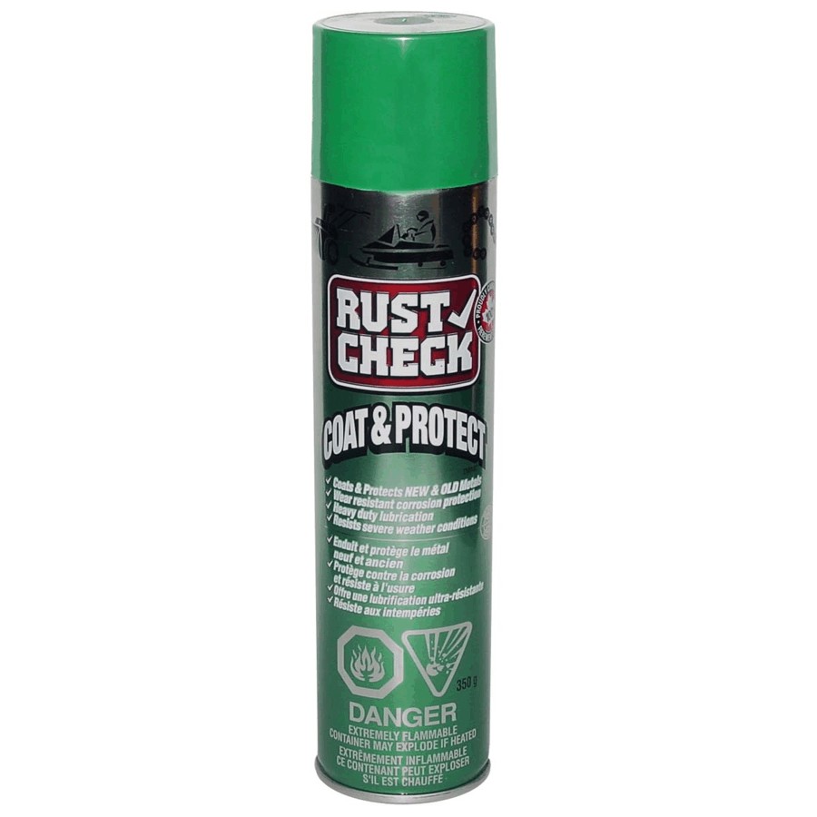

I used to use WD40. Stuff stinks, gets everywhere and doesn't stay on the material you're cutting. My current favorite is a can of green rust check. It has absolutely no smell and comes out very thick and sticky. It works amazingly well. If you like WD40 you'll love this stuff.
Attachment 42722
