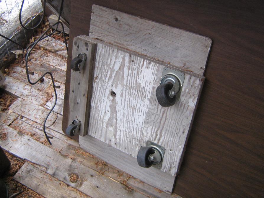

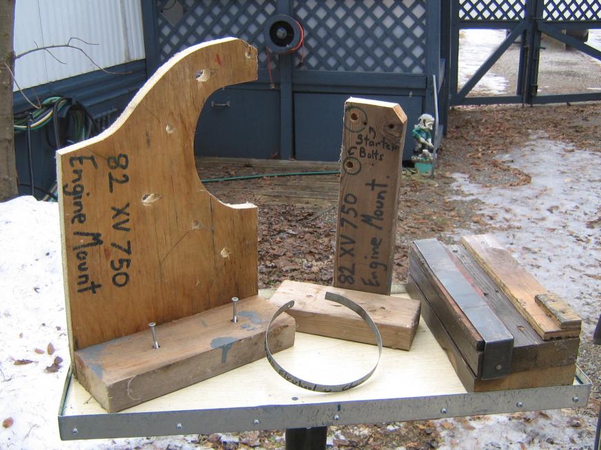

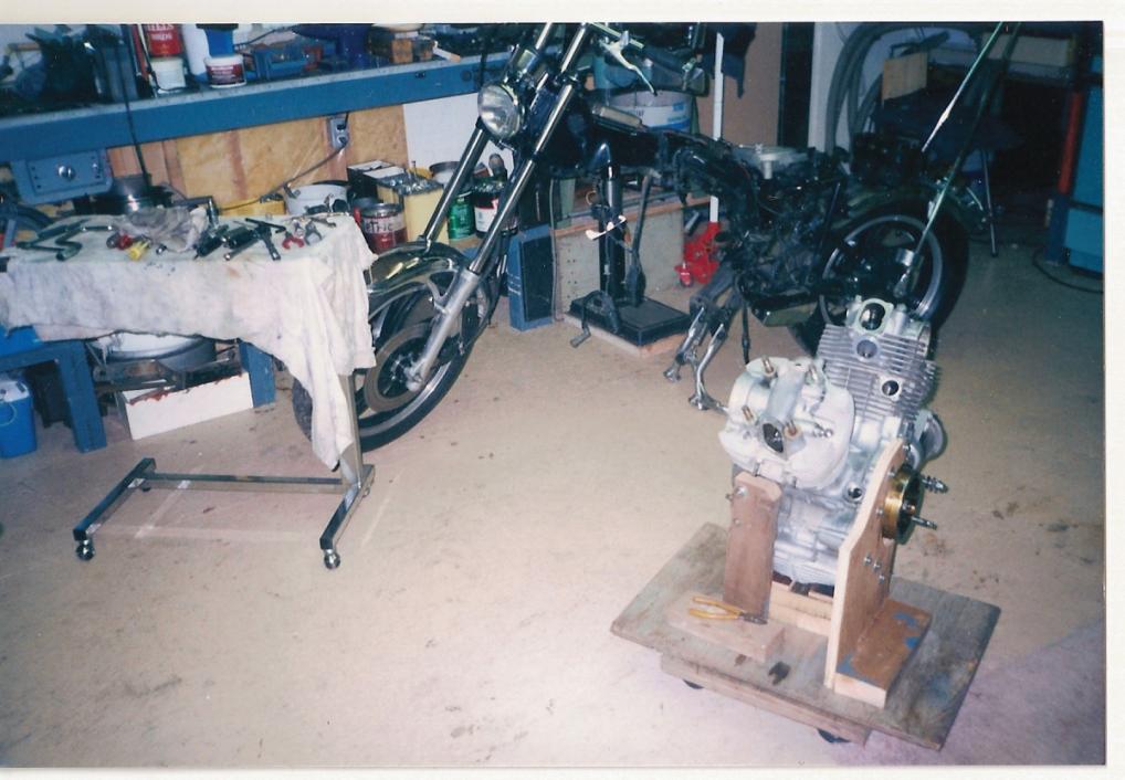

    I had to do some out of frame engine work on my Yamaha XV 750
    and had to find a way to secure the engine while wrenching on it,
    first thing was to sit the engine level and make some cardboard
    templates which are transferred to ¾" plywood and various wooden
    blocks, these are then secured to a small wooden trolley so the
    engine can be easily moved around.
