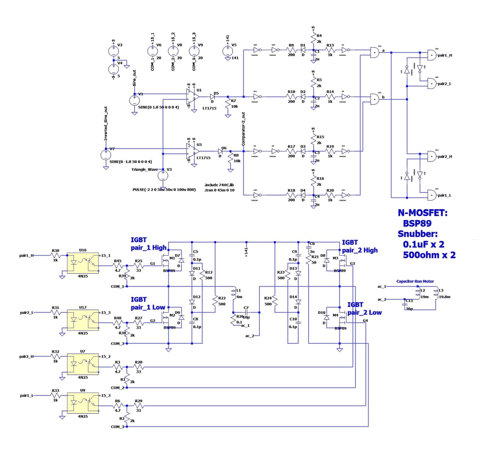

Schematic after the power unit is as follows;
Attachment 36013
showing a LT-spice view, where the triangle, sine wave generators are replaced with a simple built-in parts of LT-spice.

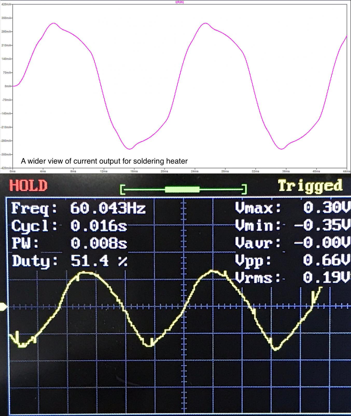

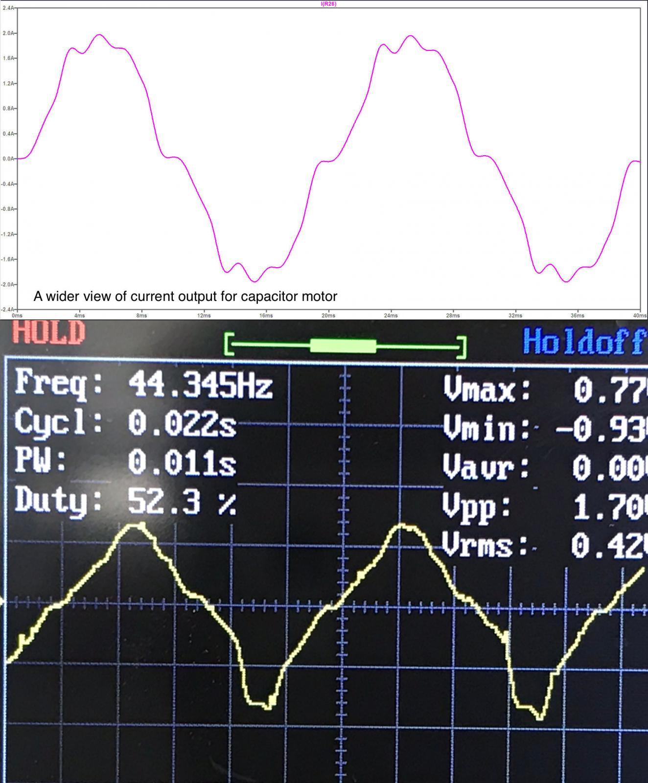

Output wave in LT-spice simulation (red lines), and a couple of real ones (oscilloscope views) here;
Attachment 36014
Attachment 36015

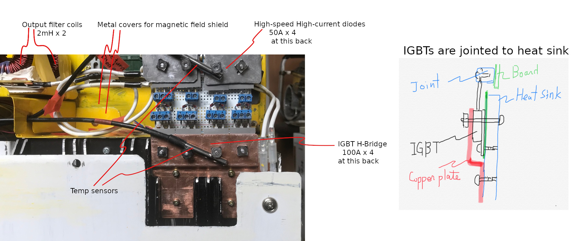

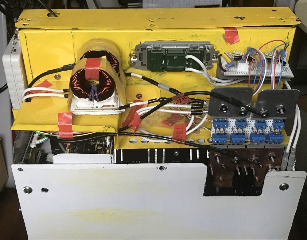

IGBTs, High Speed Diodes, and Output Filter Coils are placed in the metal shield room;
Attachment 36016
Attachment 36017

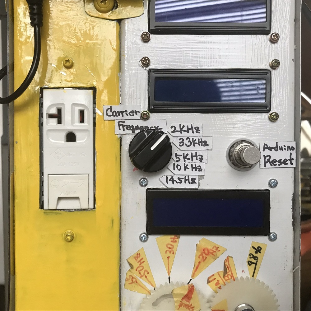

For an observation and study use, I added several kinds of carrier frequencies from 2kHz to 14.5kHz;
Attachment 36018
Chy

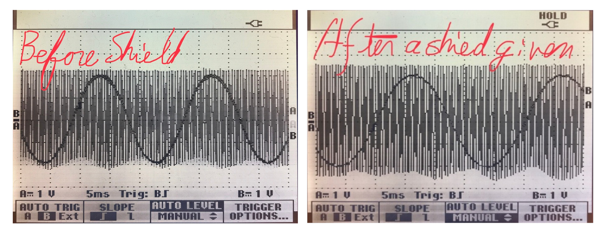

Trigger, I tried to recall my memory and some data on this, and here found a pic showing comparison between the two, before shield and after shield.
Either case bread boards were already replaced with universal boards.
Attachment 36019
Although the carrier wave was not very stable, I know the reason that the center common level was a tad off-set. the thicknesses of the sine waves tell the shield shows effect on it.
This tell us that even PCB board wants some means for cutting noise.
