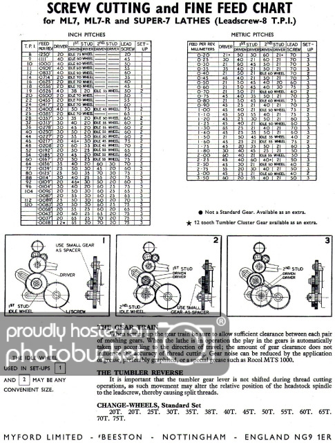

Vertical Grinder for Hobby Mill, to fit my Woodworking Router in with a grinding wheel. can be used for manty applications, but i'v made particularly to make a Single Point Gear Cutting Tool which can be seen in future video's coming out soon after this, cutting gears for Myford Lathe (Metric Threading on an Imperial Lathe using just 1 of 2 change gears at a time.
