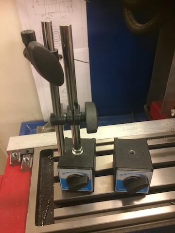

For a upcoming tool grinding rest project (not started yet) I bought two complete magnetic stands as they where cheaper than two magnetic bases that I actually need.
What I also needed for my recently acquired screwless vise was a vise stop. The surplus bars from the magnetic stand were perfect for this. The 12 mm bar only needed a new 10mm thread in one end.
Attachment 24394

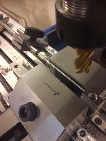

A thick mounting bracket of flat bar left over from my off-road vehicle suspension modification project was perfect for making the sliding clamp. Did the bracket “the easy way” as suggested by Toolmaker51 in an other thread a week ago.
Attachment 24395

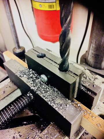

The 4 mm thin end of the other 10 mm bar I made of a piece from a laundry cloth hanger and the clamp tightening knob is from one of the magnetic stand joints.
Attachment 24396
Everything of reused material at a cost of zero euros.
