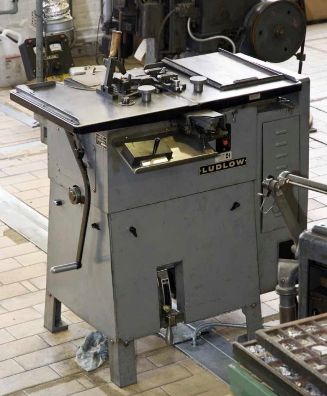

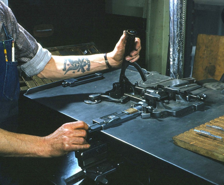

Another common, smaller machine was made by Ludlow. They made smaller units that cast lead into type set by hand.
These were single type line machines known as 'Headliners' and typically used for very large font sizes above 24 point type.
There are still shops turning out work on Ludlow machines for custom work. (expensive work)
Attachment 42185Attachment 42186
