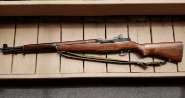

I have always used raw linseed oil on the stock of my M1 Garand. It does have a peculiar smell to it, but I have learned to love it.
Attachment 18951
