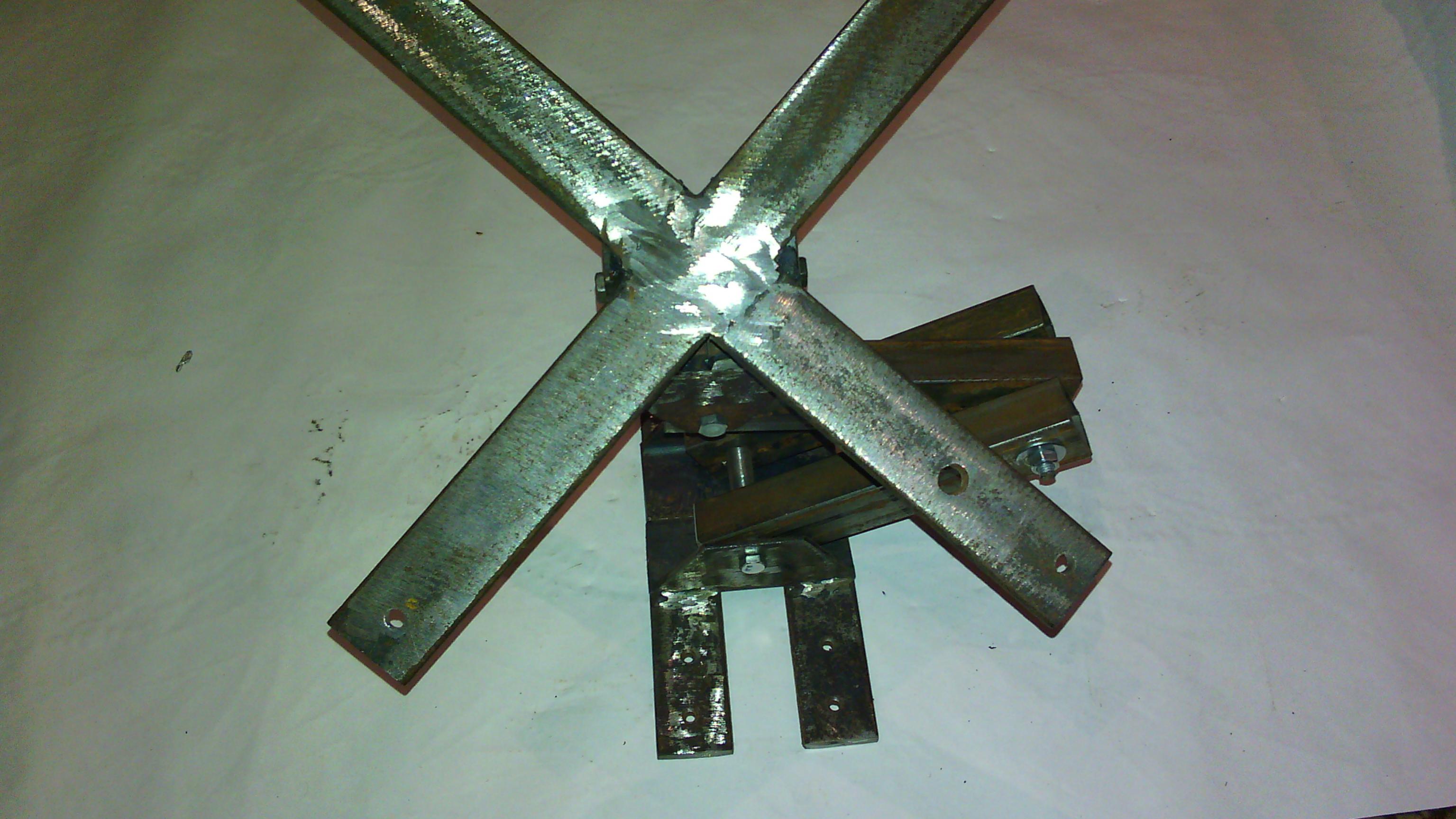

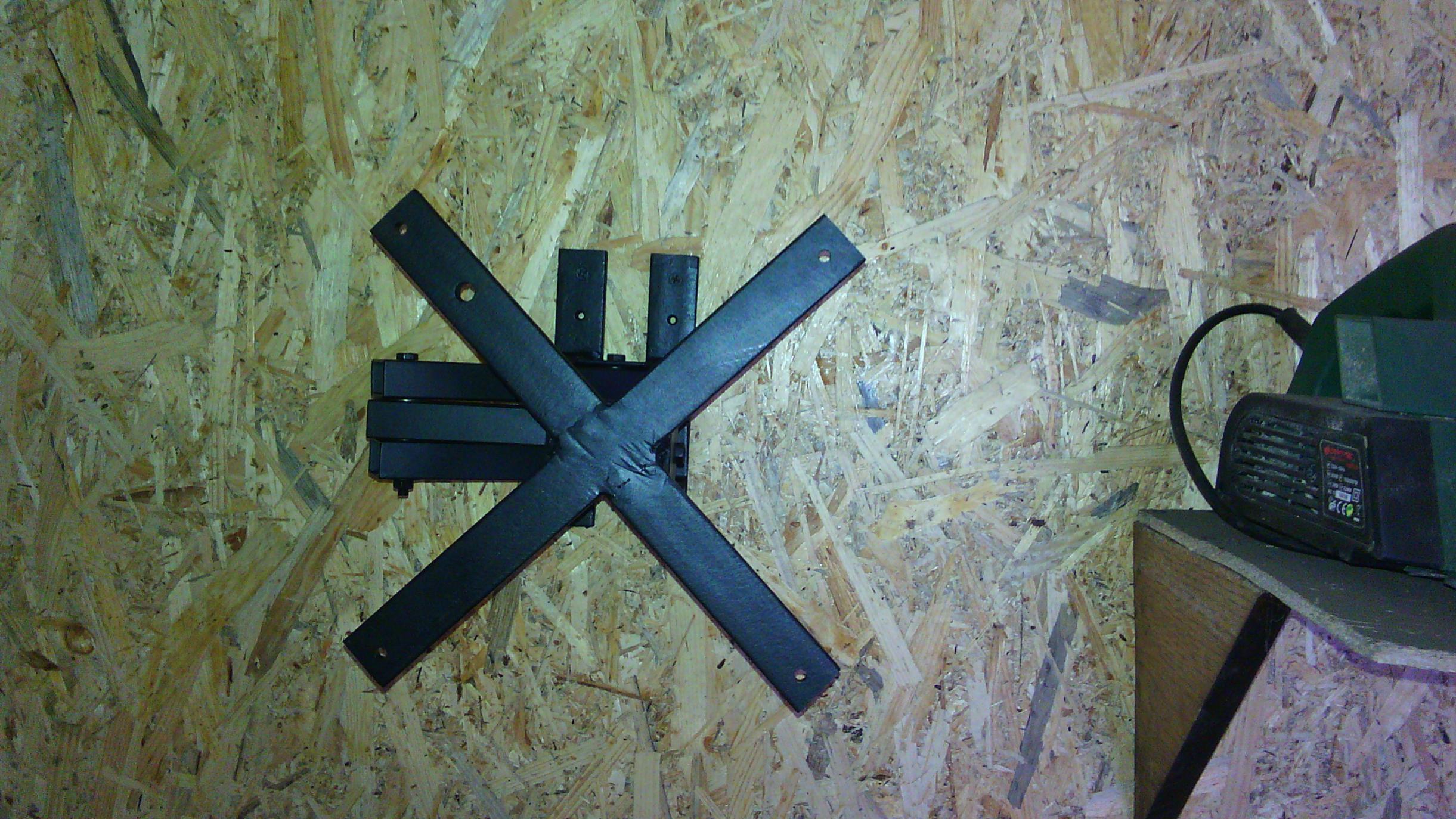

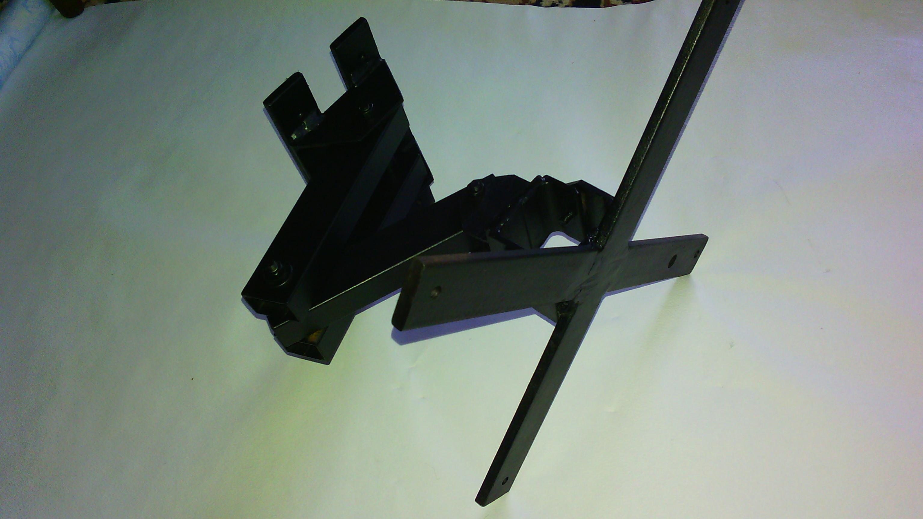

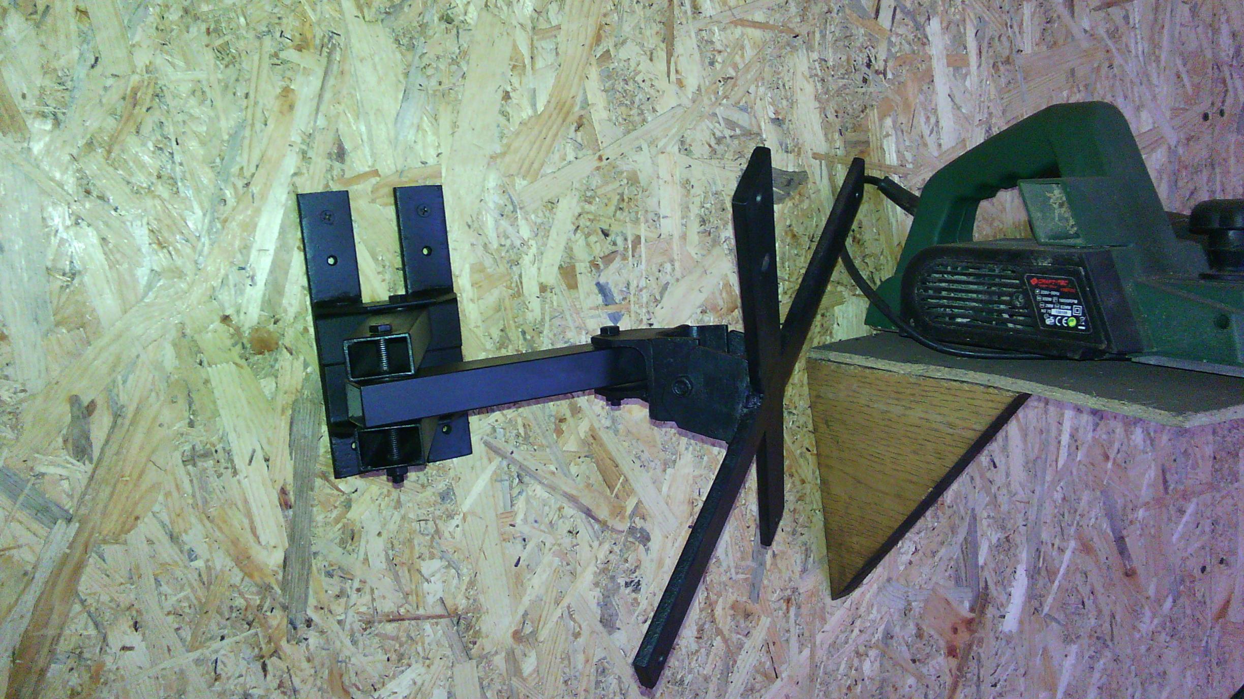

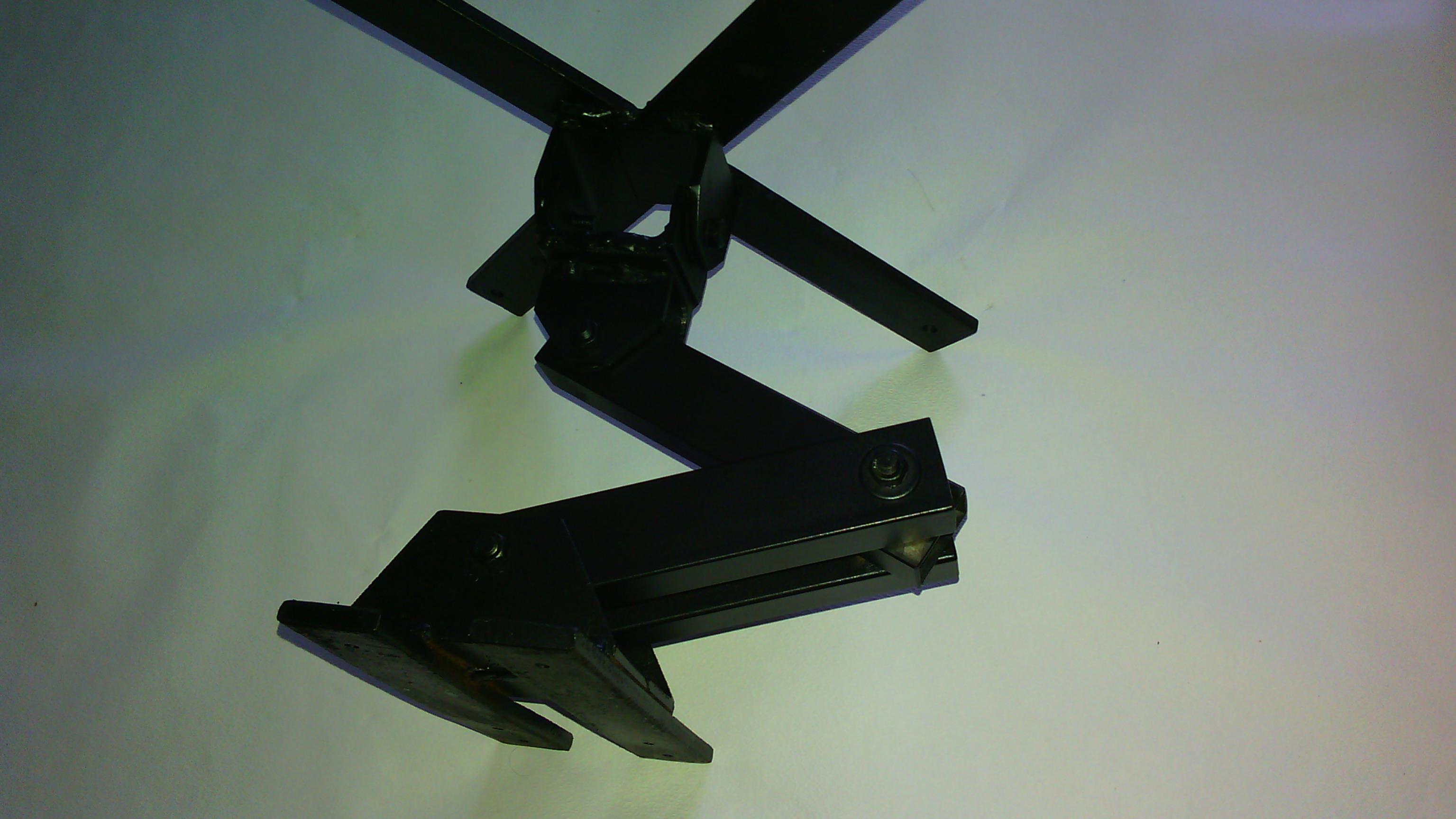

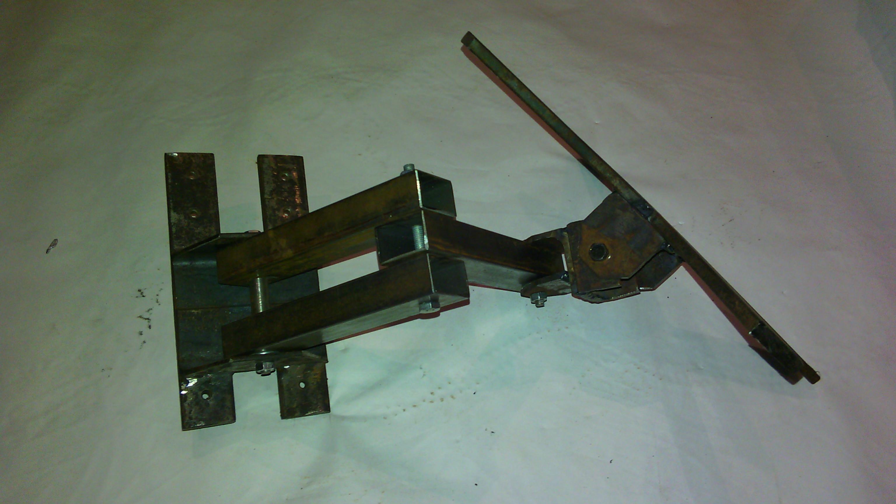

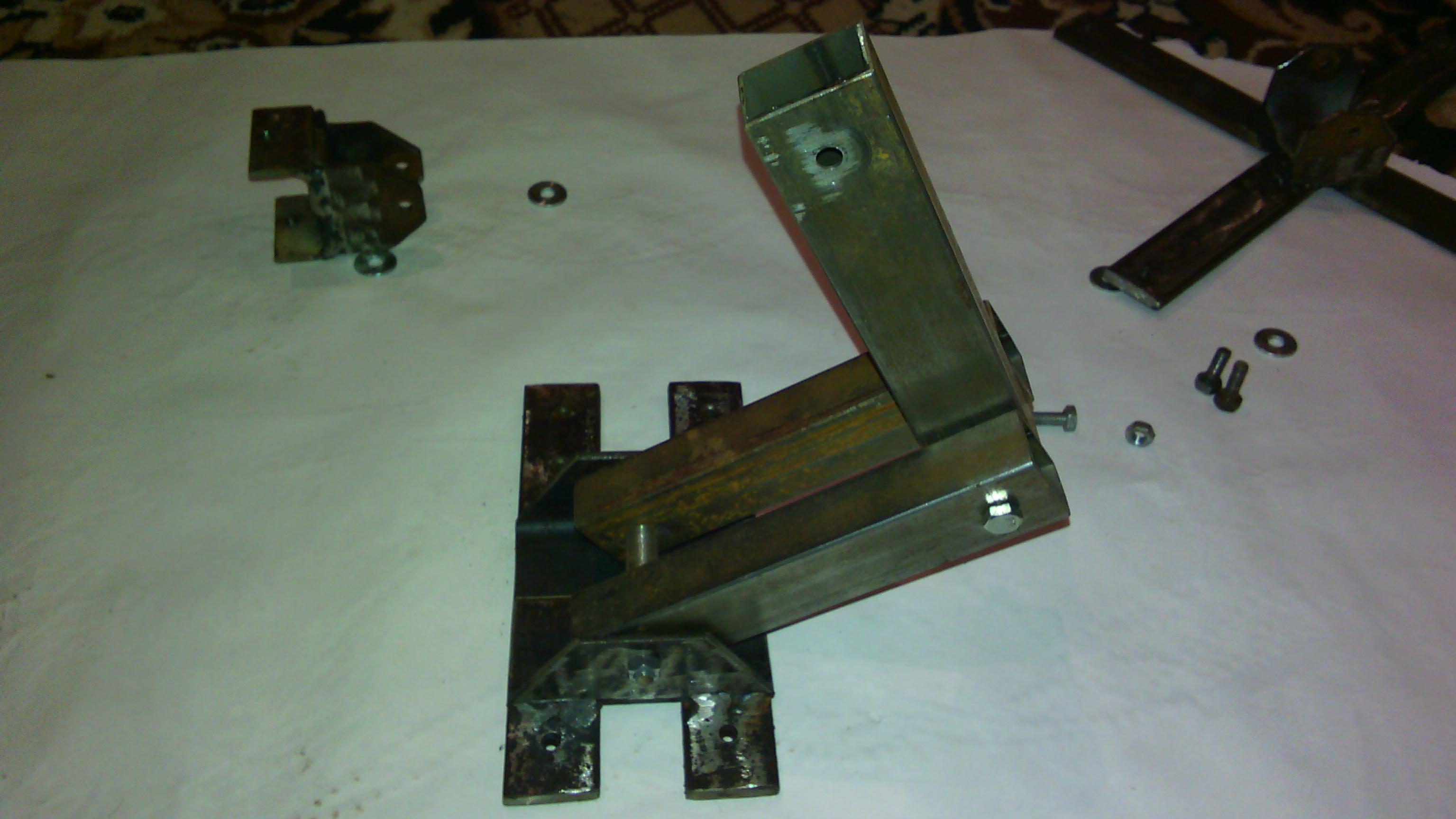

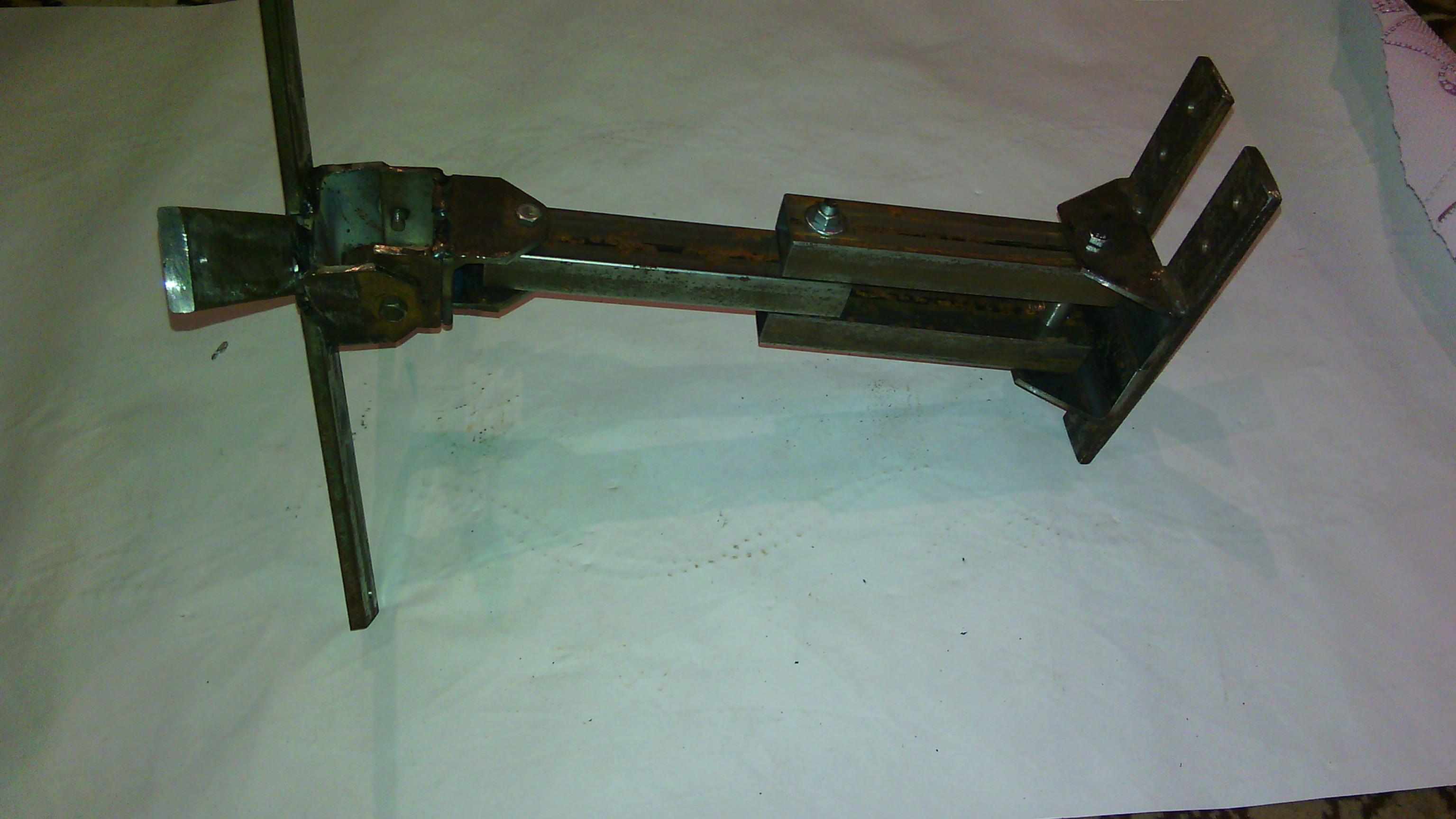

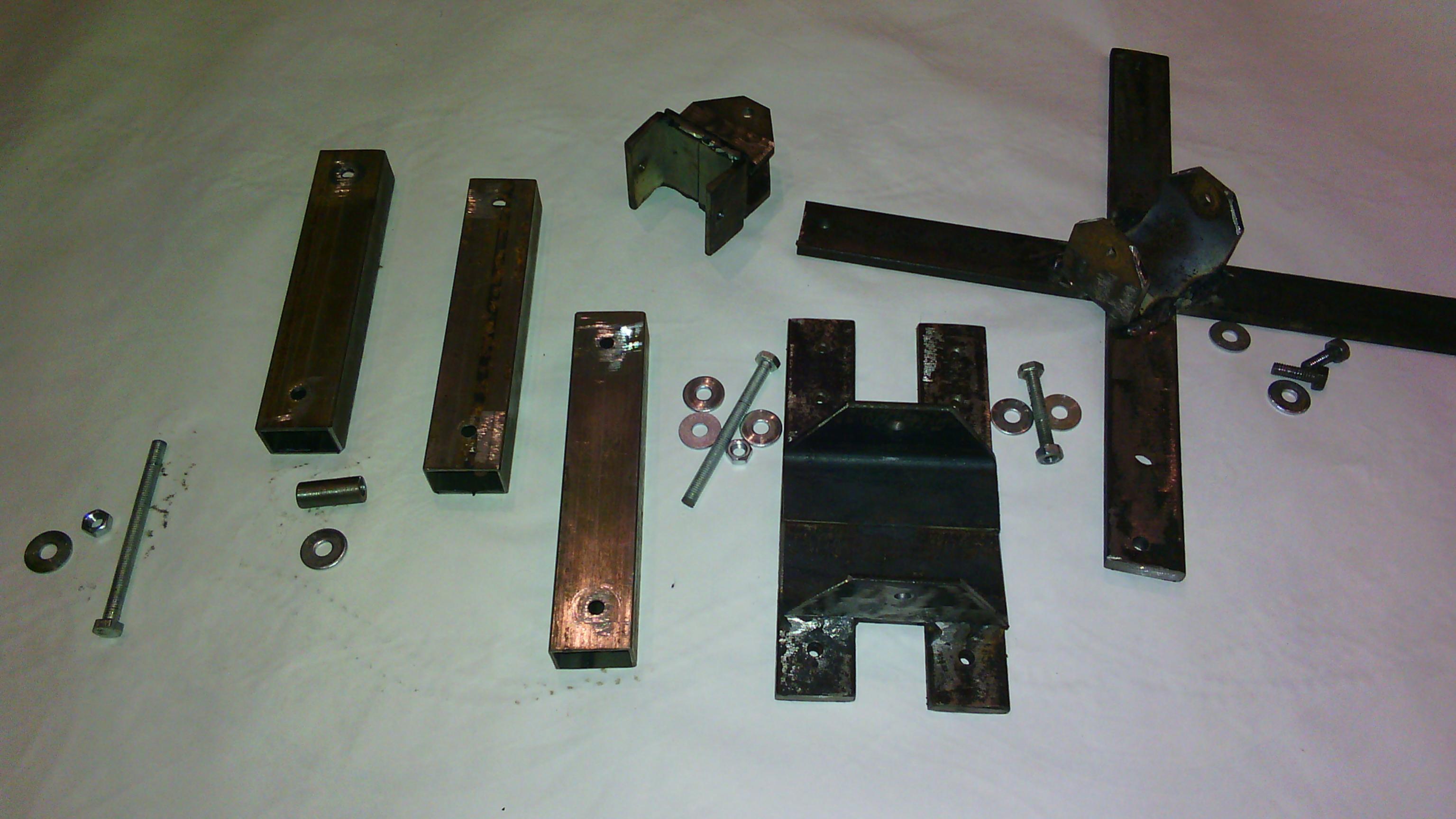

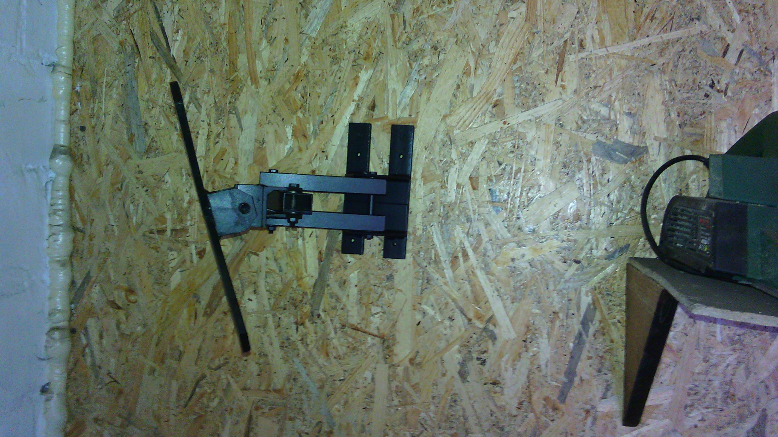

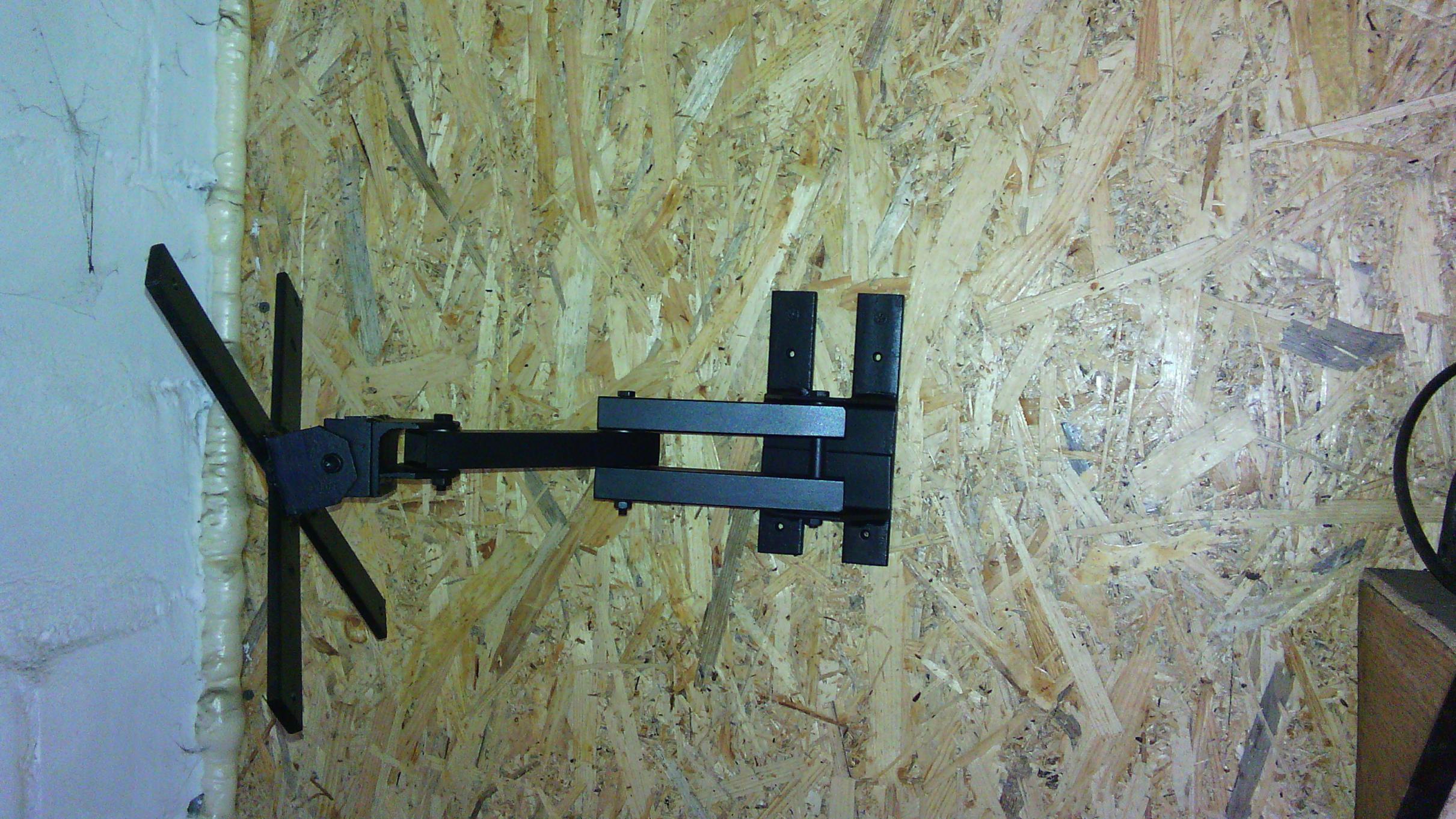

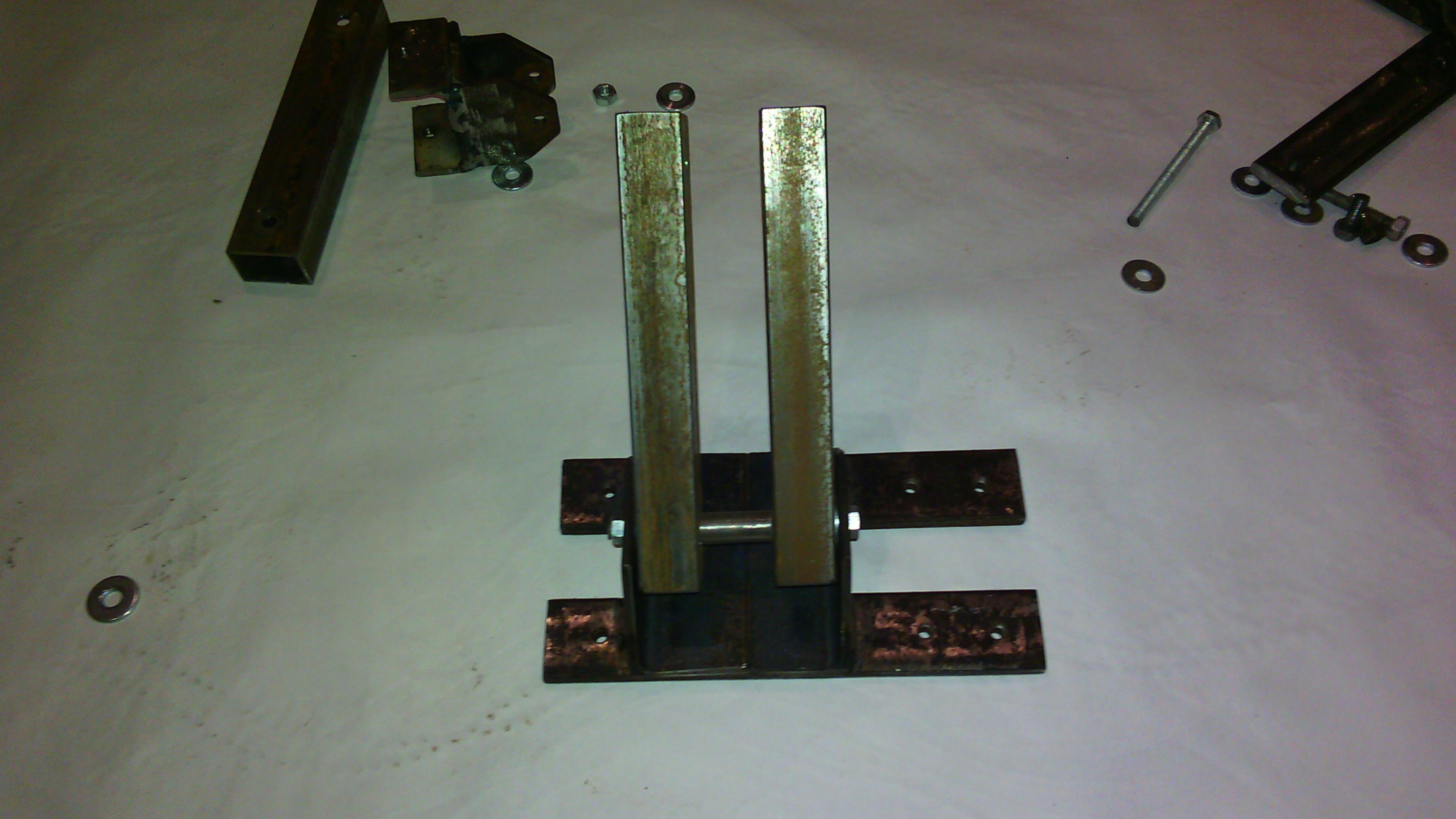

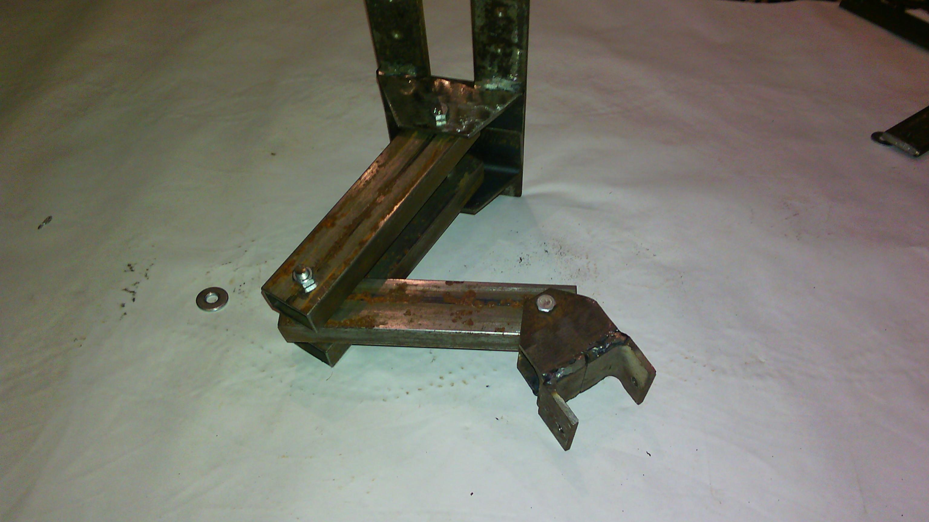

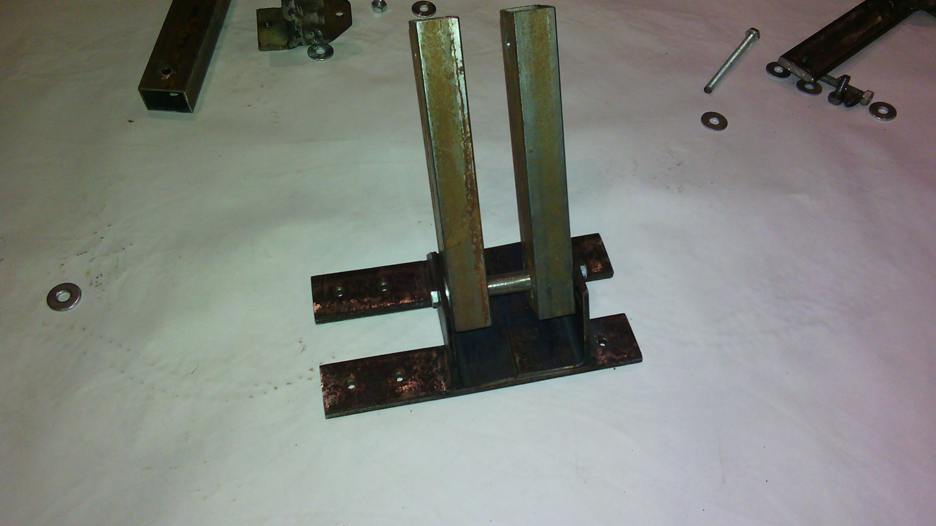

    Wall mount made of profile pipes 20x30 mm and stripes. TV can be mounted in any position.
    Wall mount the TV-img_20150323_185706.jpg Wall mount the TV-img_20150323_190058.jpg Wall mount the TV-img_20150323_190127.jpg Wall mount the TV-img_20150323_190411.jpg Wall mount the TV-img_20150323_190840.jpg Wall mount the TV-img_20150323_192311.jpg Wall mount the TV-img_20150323_192342.jpg Wall mount the TV-img_20150323_192412.jpg Wall mount the TV-img_20150330_141025.jpg Wall mount the TV-img_20150330_141054.jpg Wall mount the TV-img_20150330_141458.jpg Wall mount the TV-img_20150330_141521.jpg Wall mount the TV-img_20150330_141537.jpg Wall mount the TV-img_20150330_141557.jpg
