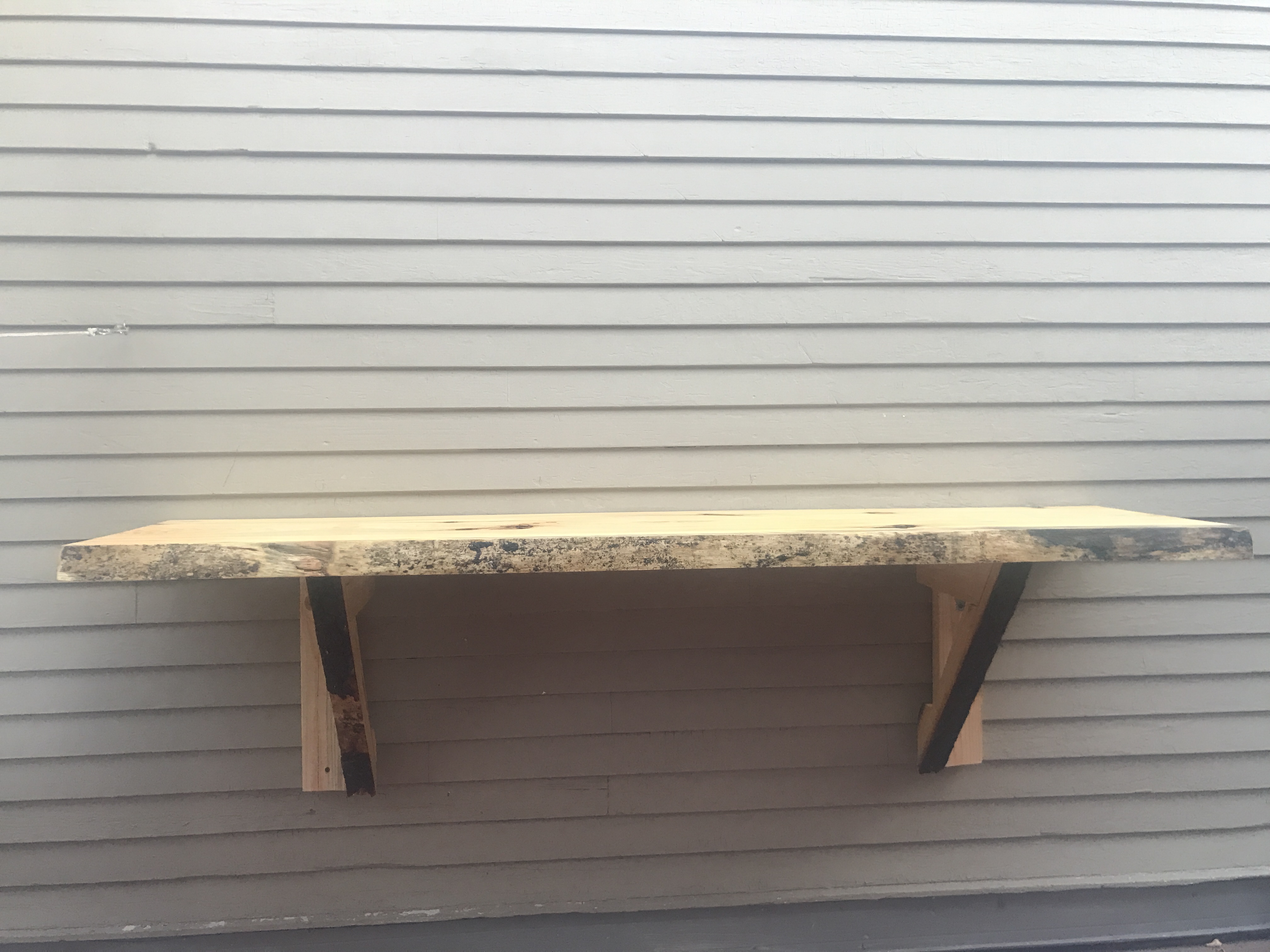

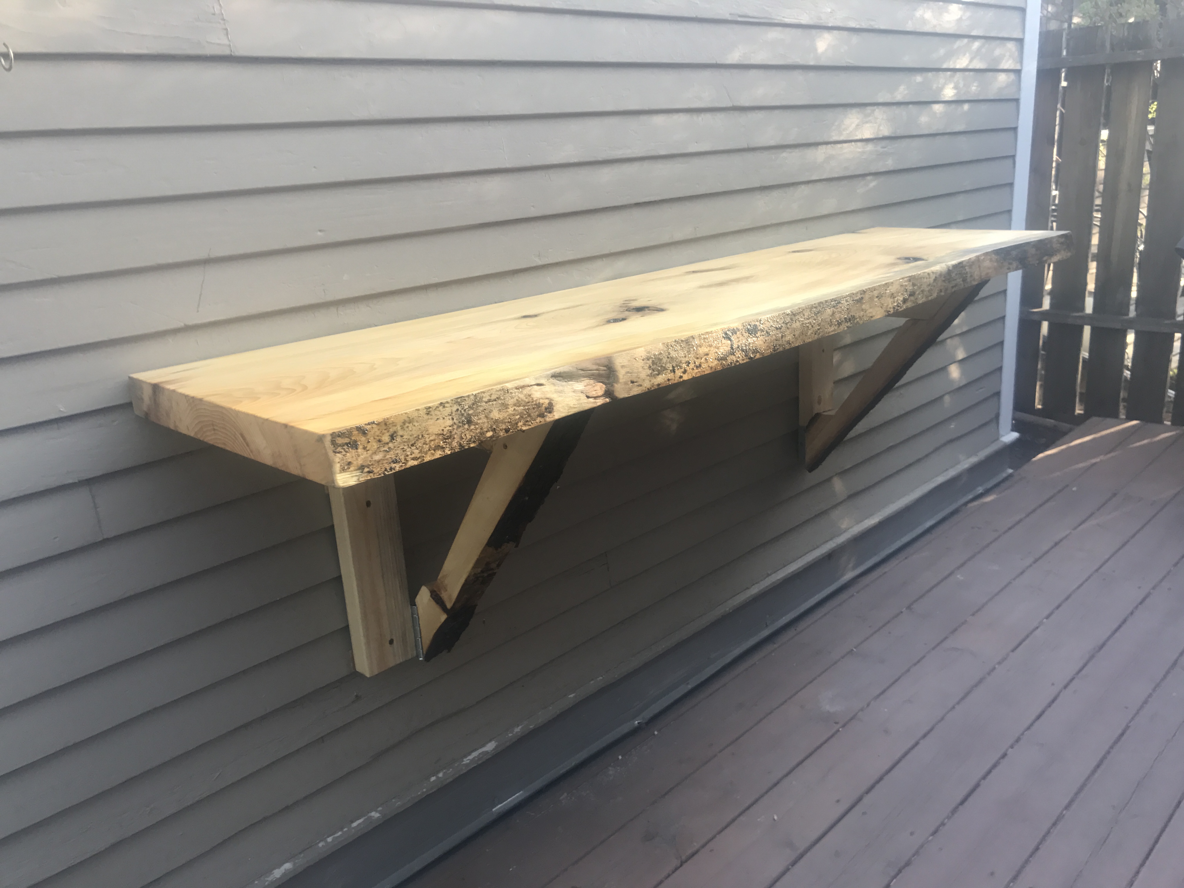

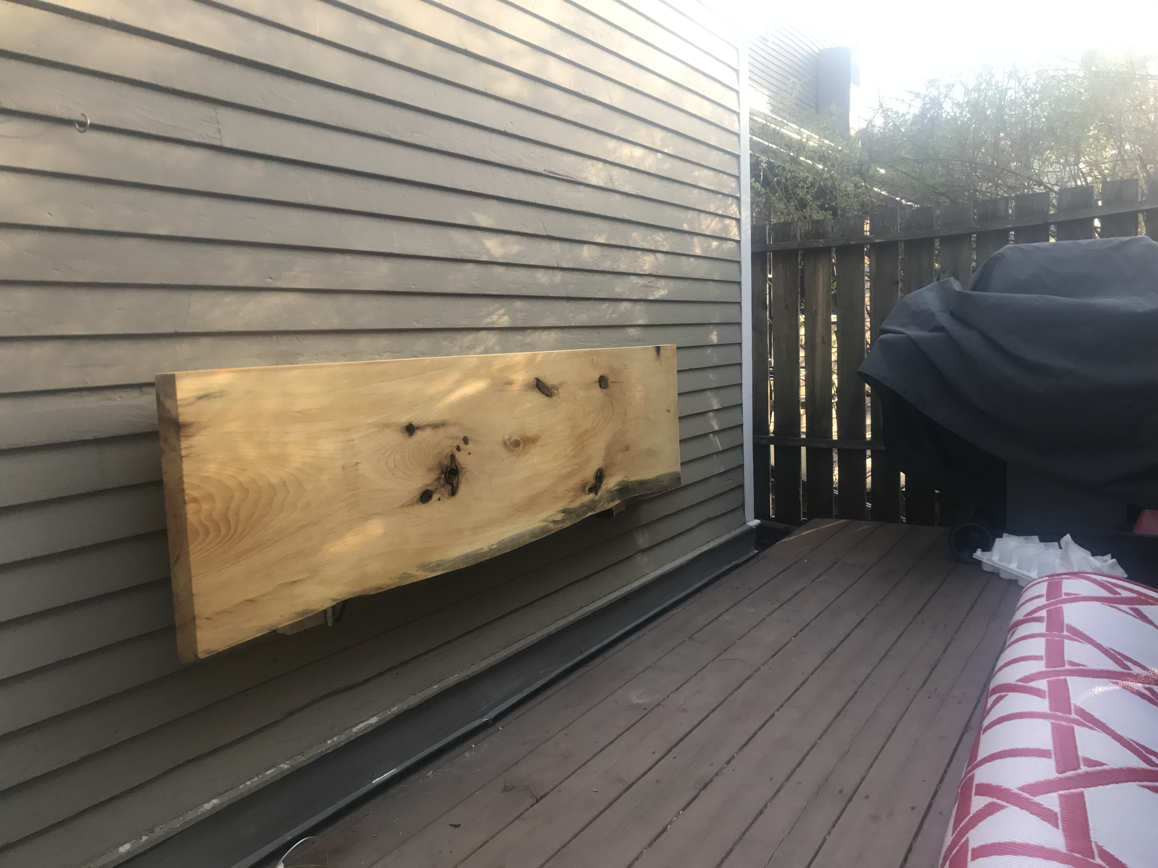

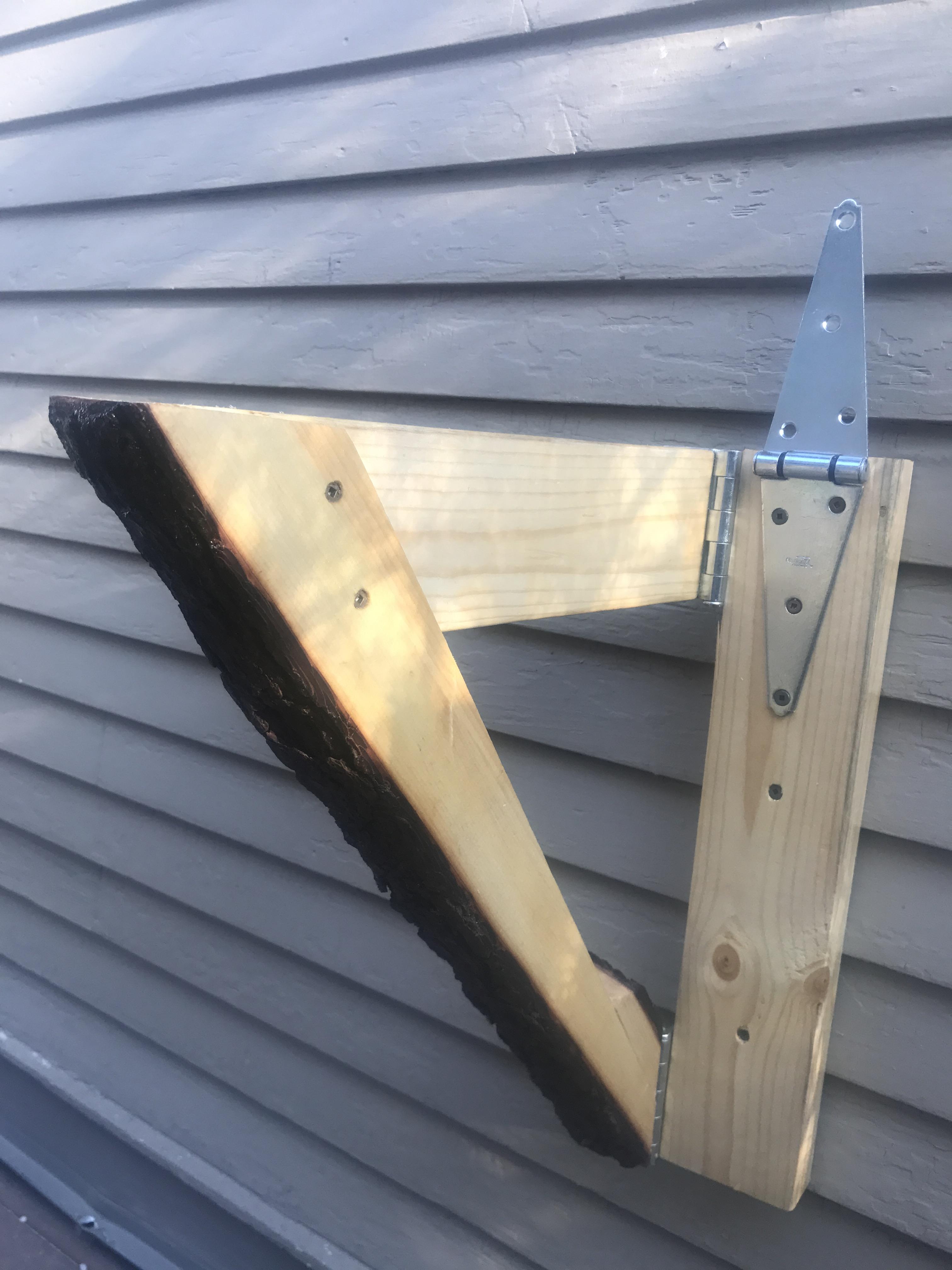

This is a BBQ prep table I made out of a 2" thick live edge slab. Space around the BBQ is a bit tight so it had to fold flat against the wall when not in use. In ripping the back live edge off to sit flat along the wall, I had enough of an offcut to make the hinged braces with the live edge facing out for a more congruent aesthetic.
