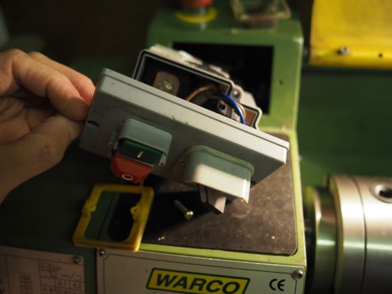

Hi All, thought I would start a thread about the Warco Lathe, a version of the Chinese made lathe that is sold in the UK. I've had a Warco WM240B from new for some years now and all has been fine, then last week I switched it off and could not switch it back on.
I pulled the panel off and did some basic measurements of continuity with a DVM, but what shocked me most was the rats nest of wires:
Attachment 26689

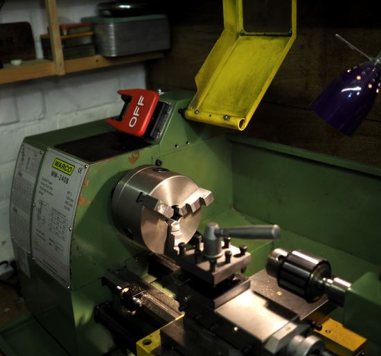

After messing around I rewired the machine with a simple NVR switch
Attachment 26690
What is most interesting is that I now get an instant on and the machine doesn't hesitate - there must have been an issue with the original wiring as it would start and then after a few 10s of seconds it would shudder.

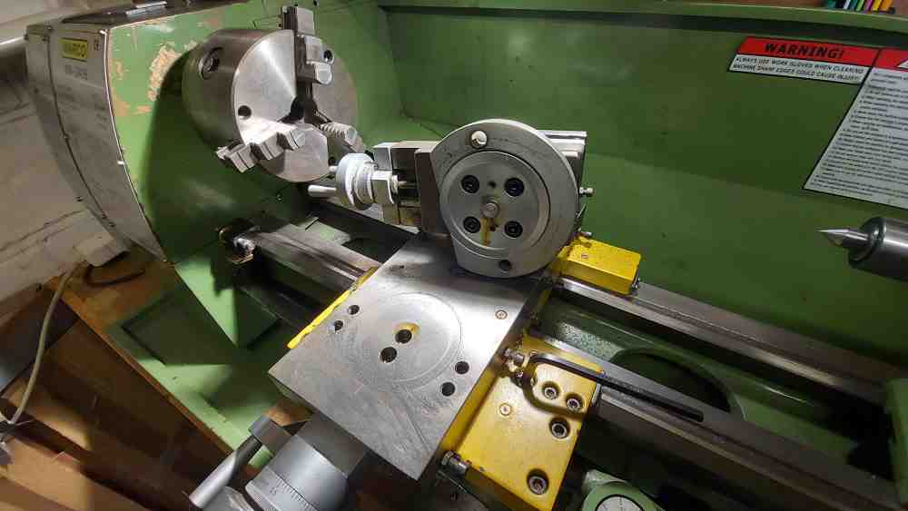

1 Attachment(s)
Just removed the topslide on the Warco and realised there are two position settings for it that are 15mm apart, something to remember if you're turning larger diameters.
Attachment 41156
