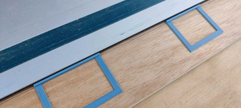

Attachment 41555
These are used when you want/need to have your guide rail on the waste side of the line. If you put the splinter guard up to the line on your workpiece, your workpiece will end up too narrow (by the width of the kerf of your saw blade). These jigs help to offset the guide rail by the right amount.

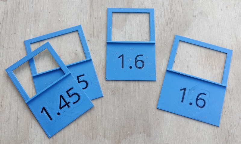

Attachment 41556
Designed to clip together for ease of storage:

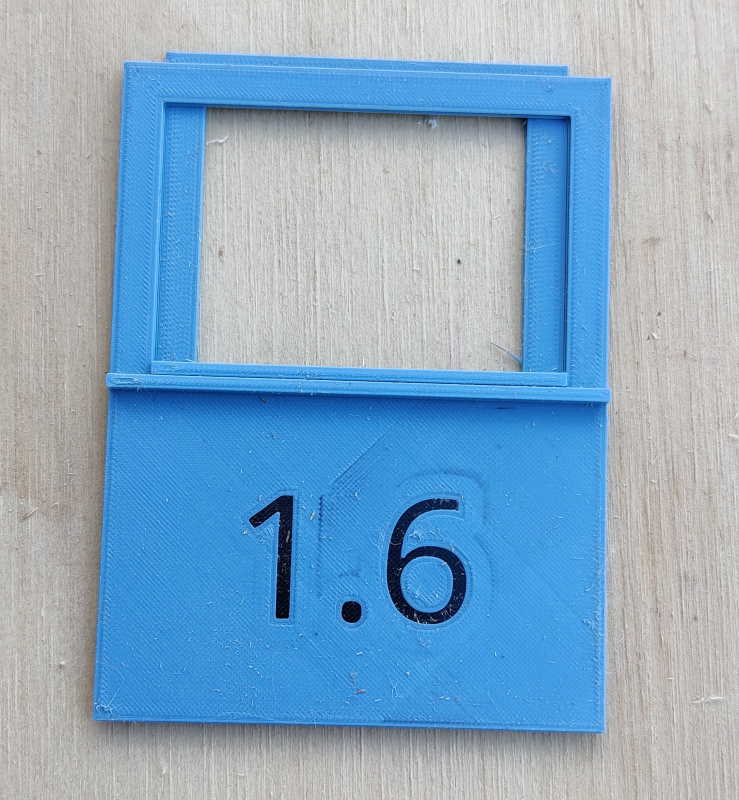

Attachment 41557
If anyone's interested in printing their own, the files required (including lots of different kerf sizes) are all here: https://www.prusaprinters.org/prints...side-kerf-jigs
