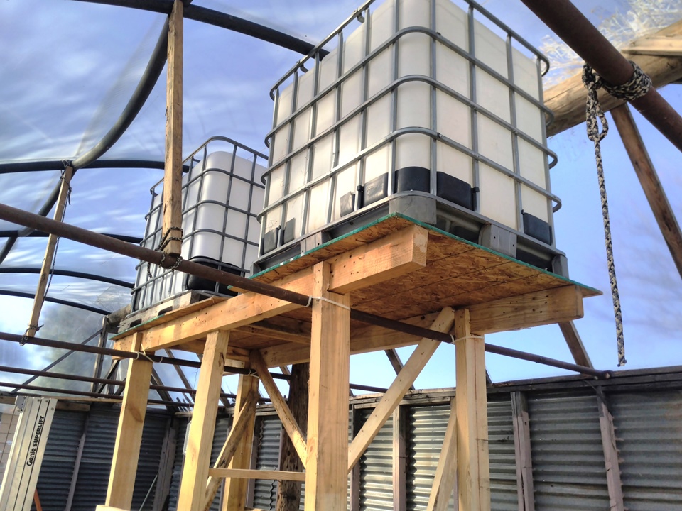

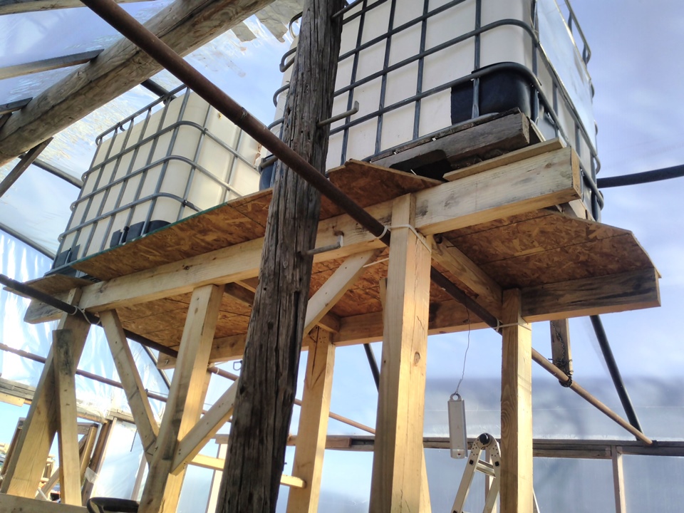

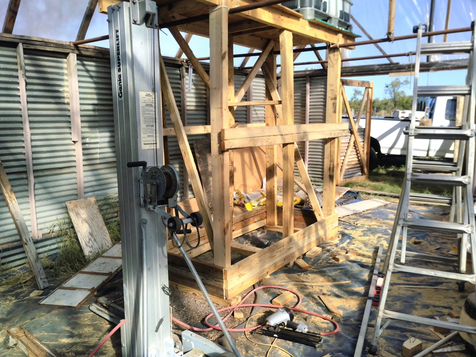

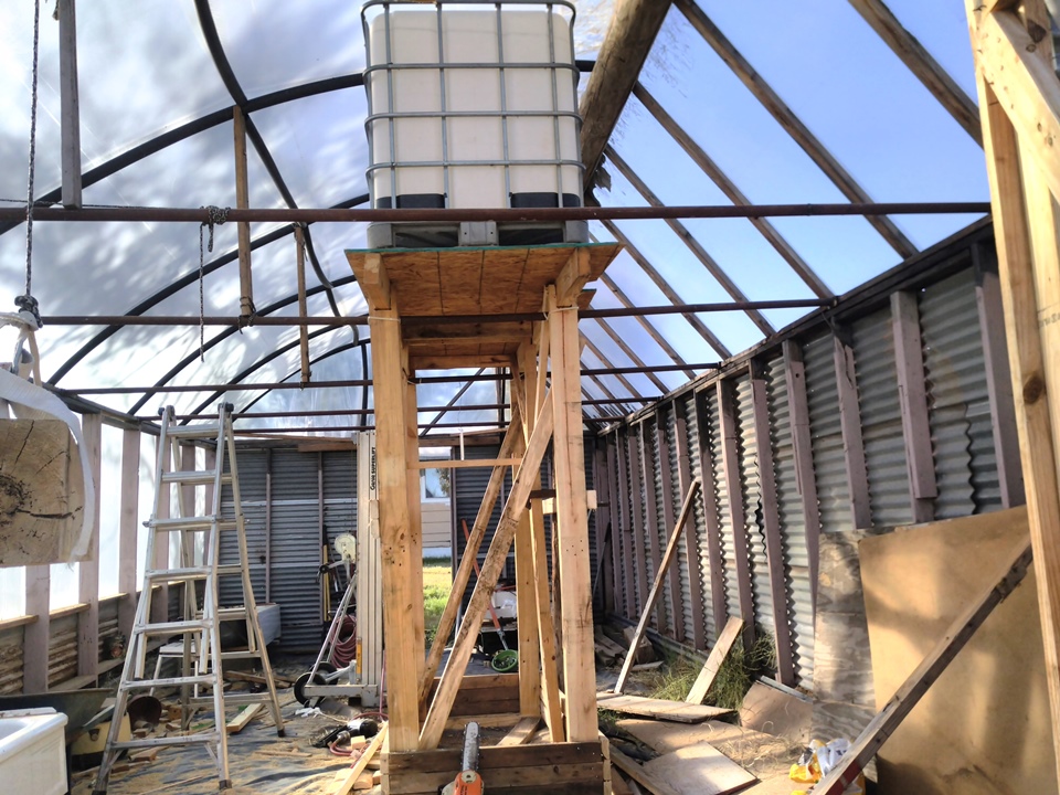

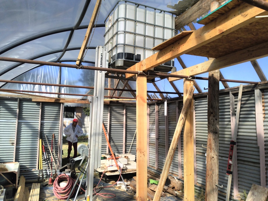

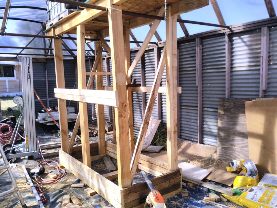

    In getting ready to add some thermal mass in my green house I decided to do this by building a structure for a water tower. This structure will serve several purposes 2 300 gallon totes mounted on top will be painted black to absorb heat during the day the water in them will store the heat and radiate it off during the night time hours also eventually I will install an automatic gravity fed drip watering system to all of the grow beds as I build them and add plants but the hot water will not be dripped directly on the plants it will be cooled prior to this or fed into the soil through tubes in the bottoms of the beds
    I will have 2 levels of grow beds under the tower itself to utilize otherwise wasted space.
    lifting an empty tote
    Water tower / thermal mass / grow beds structure-img_20211114_103150wr.jpg

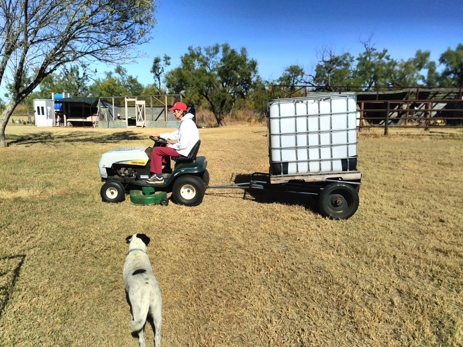

    Tote delivery service
    Water tower / thermal mass / grow beds structure-img_20211114_111907jn.jpg
    Water tower / thermal mass / grow beds structure-img_20211114_143941gh.jpg
    Water tower / thermal mass / grow beds structure-img_20211114_144056gh.jpg
    Water tower / thermal mass / grow beds structure-img_20211114_154647gh.jpg
    Water tower / thermal mass / grow beds structure-img_20211114_154717gh.jpg
    Pole for access to the platform
    Water tower / thermal mass / grow beds structure-img_20211114_154758gh.jpg

    What is your foundation for this tower? (2)300 gallon totes is north of 5000lbs when full...?!

    Earth floor with a tarp over it to prevent grass and weeds growing in the floor 3 3x6 boards 48" long give it a total of 5.5x3x48 or 792 sq. inches.
    400lbs timber for the tower 400lbs dirt for 2nd tier grow bed 5000lbs water call it 5800 lbs with a ground bearing load of 7.32PSI 1st & 2nd grow beds plus diagonal and horizontal bracing share in making it ridged and stable , it will still be standing long after I'm gone

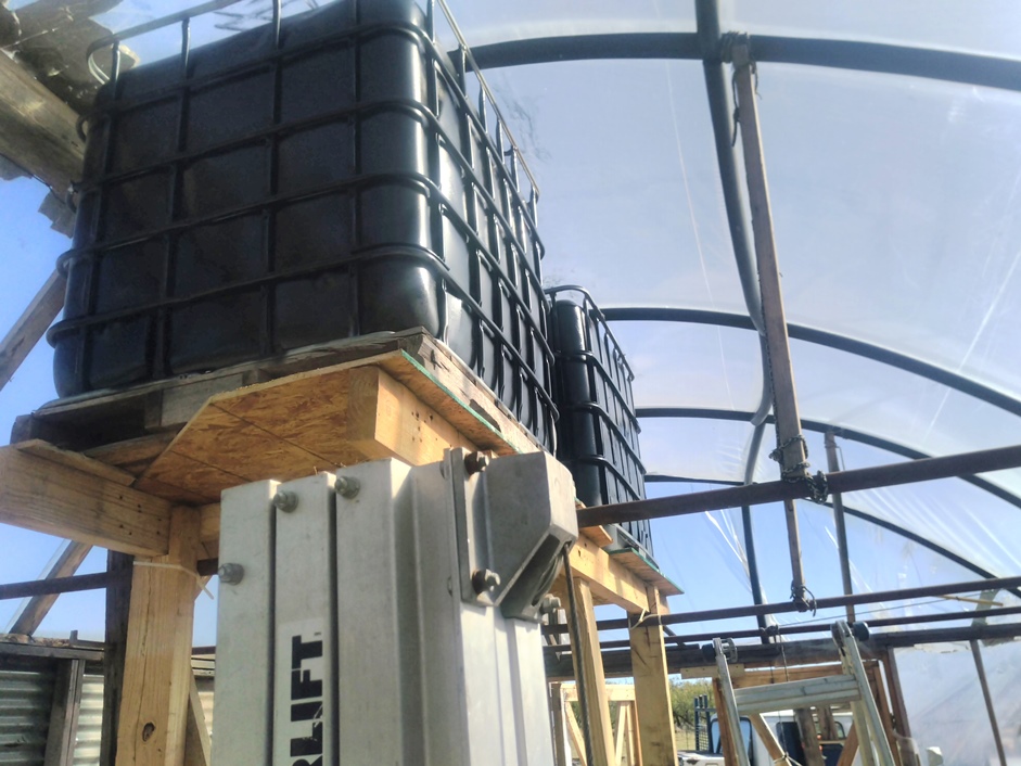

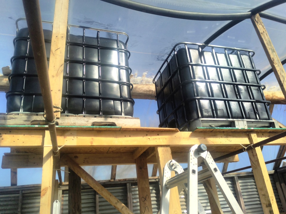

    The totes are now full of water and painted gloss black to absorb as much heat as possible
    Water tower / thermal mass / grow beds structure-img_20211116_105928wt.jpg
    Water tower / thermal mass / grow beds structure-img_20211116_105957wt.jpg
