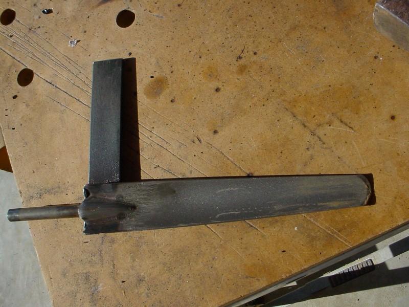

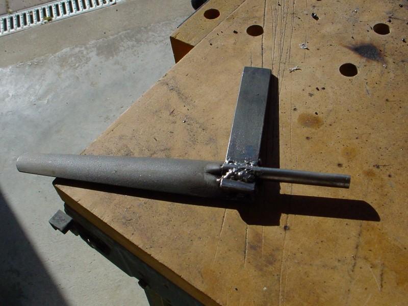

I start from a tool I purchased, it's like a long gouge, made for pulling out weeds, but with the hand. It had a short handle. So I removed the handle, and I welded a big foot rest, perpendicular to the gouge.
Here it is :
http://www.labellenote.fr/file/Diver...e_pied.JPG.jpg
Upside down :
http://www.labellenote.fr/file/Diver...e_soie.JPG.jpg

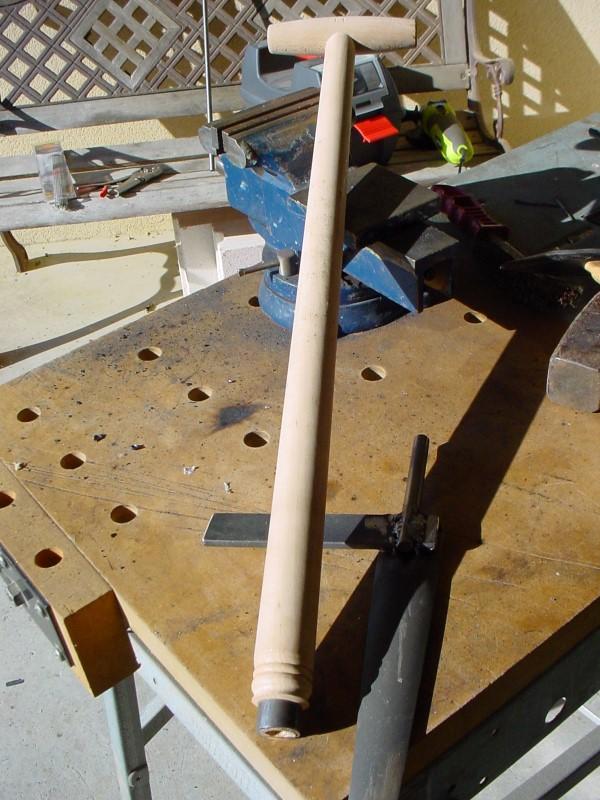

And Then, I bored the end of a shovel handle, added a steel ring to avoid any splitting :
http://www.labellenote.fr/file/Diver..._bague.JPG.jpg

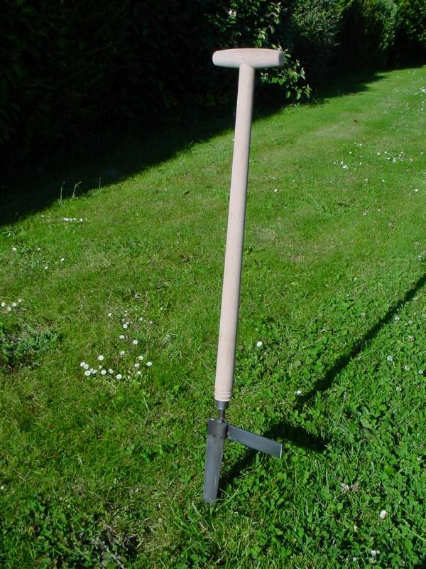

And here is the complete tool :
http://www.labellenote.fr/file/Diver...mblage.JPG.jpg

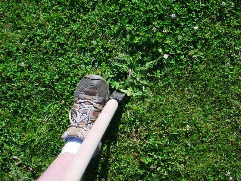

So you have more strength pushing with the foot than with the hand :
http://www.labellenote.fr/file/Diver...foncer.JPG.jpg

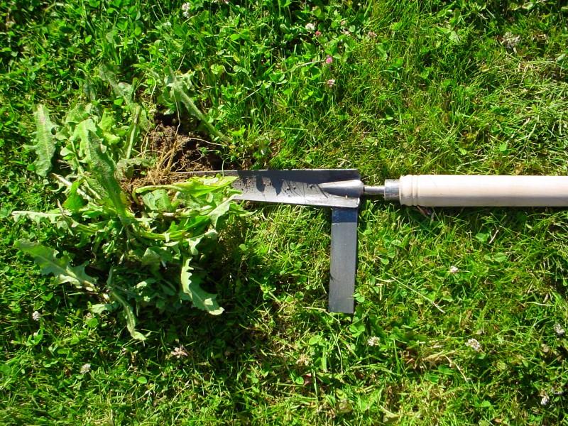

You just need to swing the tool to help the dandelion to be extracted easily with most of its roots !
http://www.labellenote.fr/file/Diver...sculer.JPG.jpg
