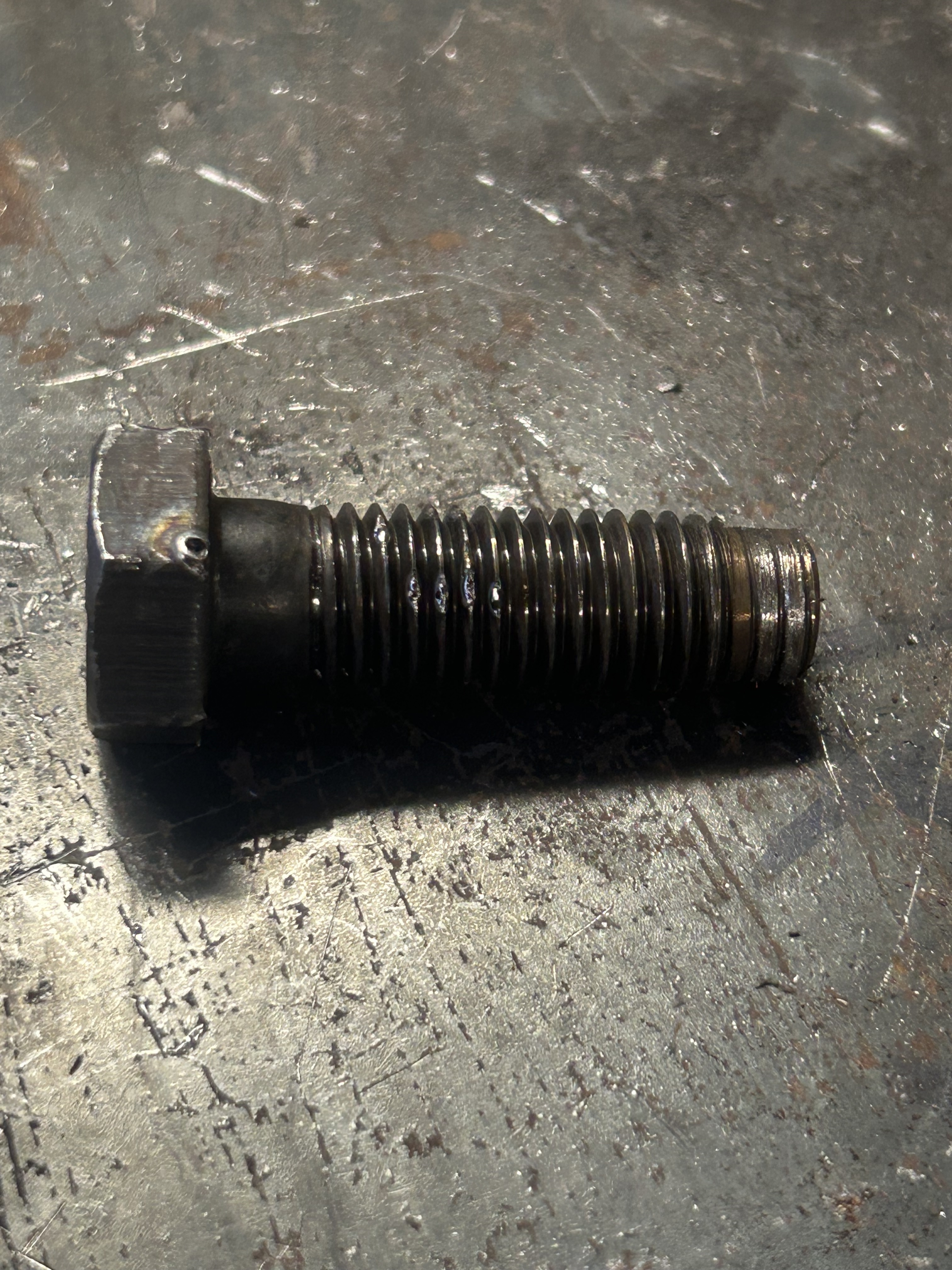

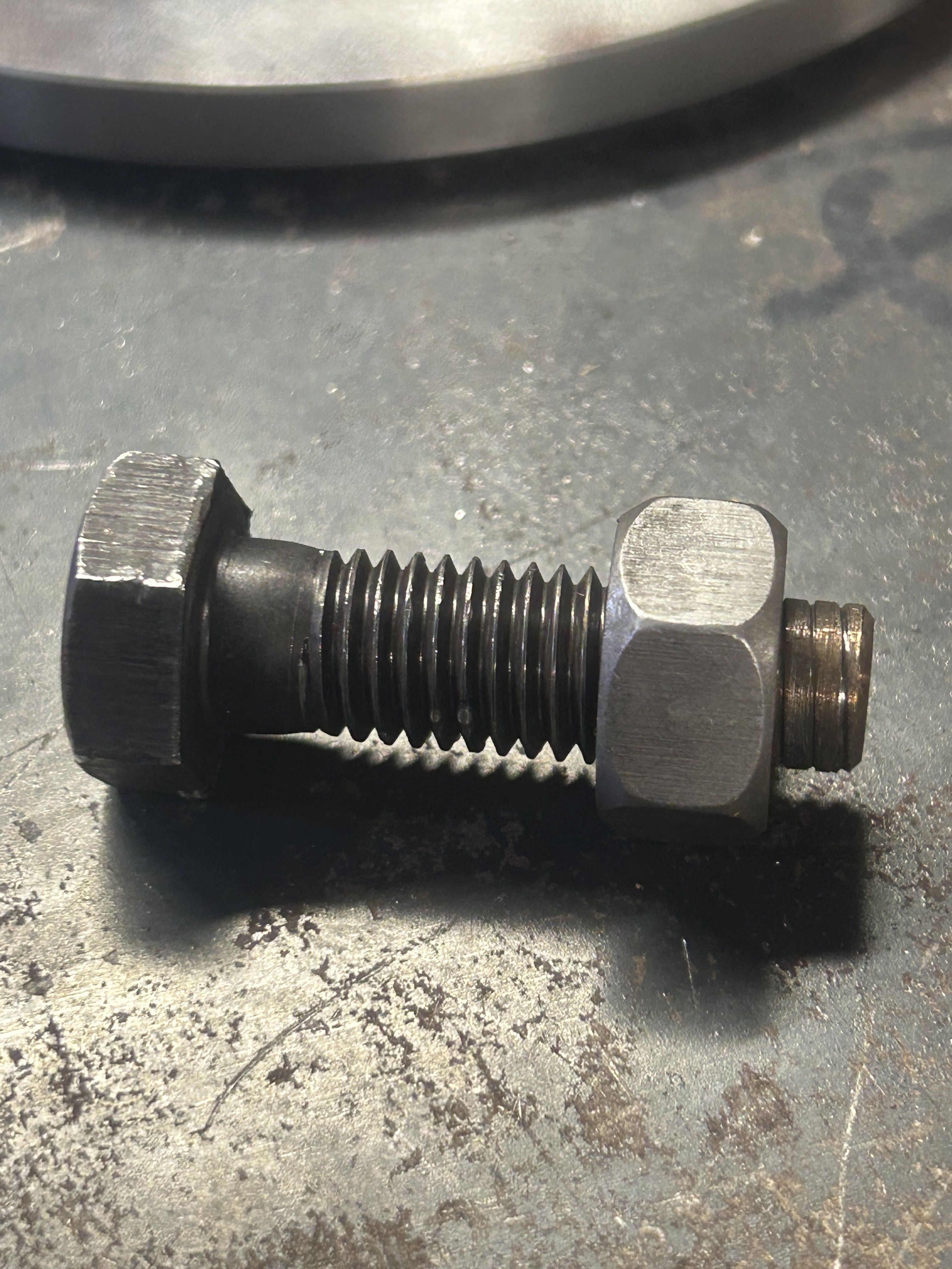

The holes in the flange were drilled tapping size for M12x2.75 (10.2mm) A standard steel bolt was then turned down to the core diameter to be a good fit in the drilled holes. The first nut was then screwed on to this bolt with about 7mm of the core diameter protruding out so this could locate in the 10.2mm holes ensuring that the nut thread wound be concentric to the hole. Then welded in place and the bolt removed. After all 8 nuts were welded in place a tap was used from the nut side to extend the thread into the flange.

Attachment 47648M12 bolt with the front turned down to core drilling size 10.2mm

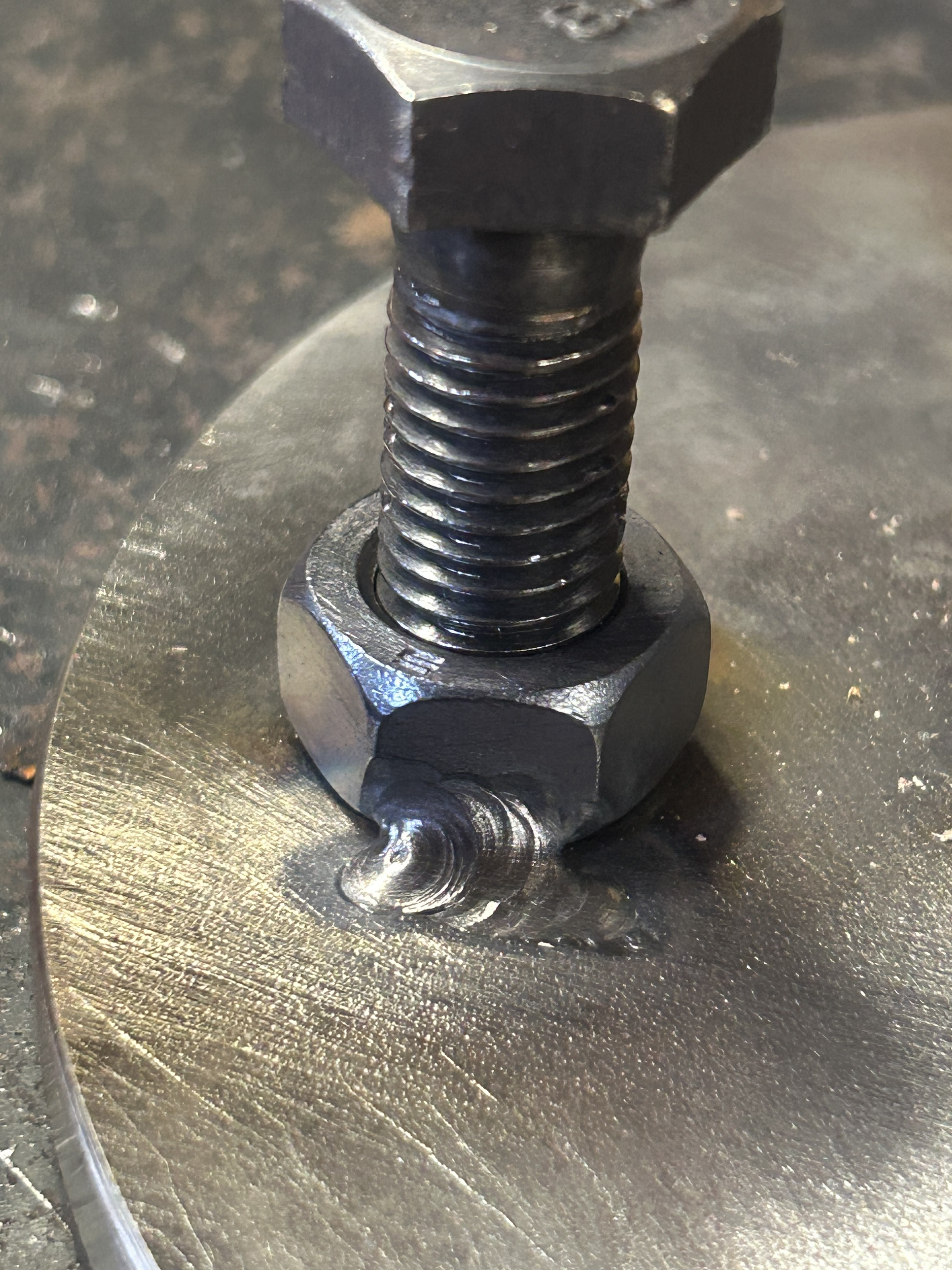

Attachment 47649Nut ready to be located in hole.
Attachment 47650Nut welded to flange.

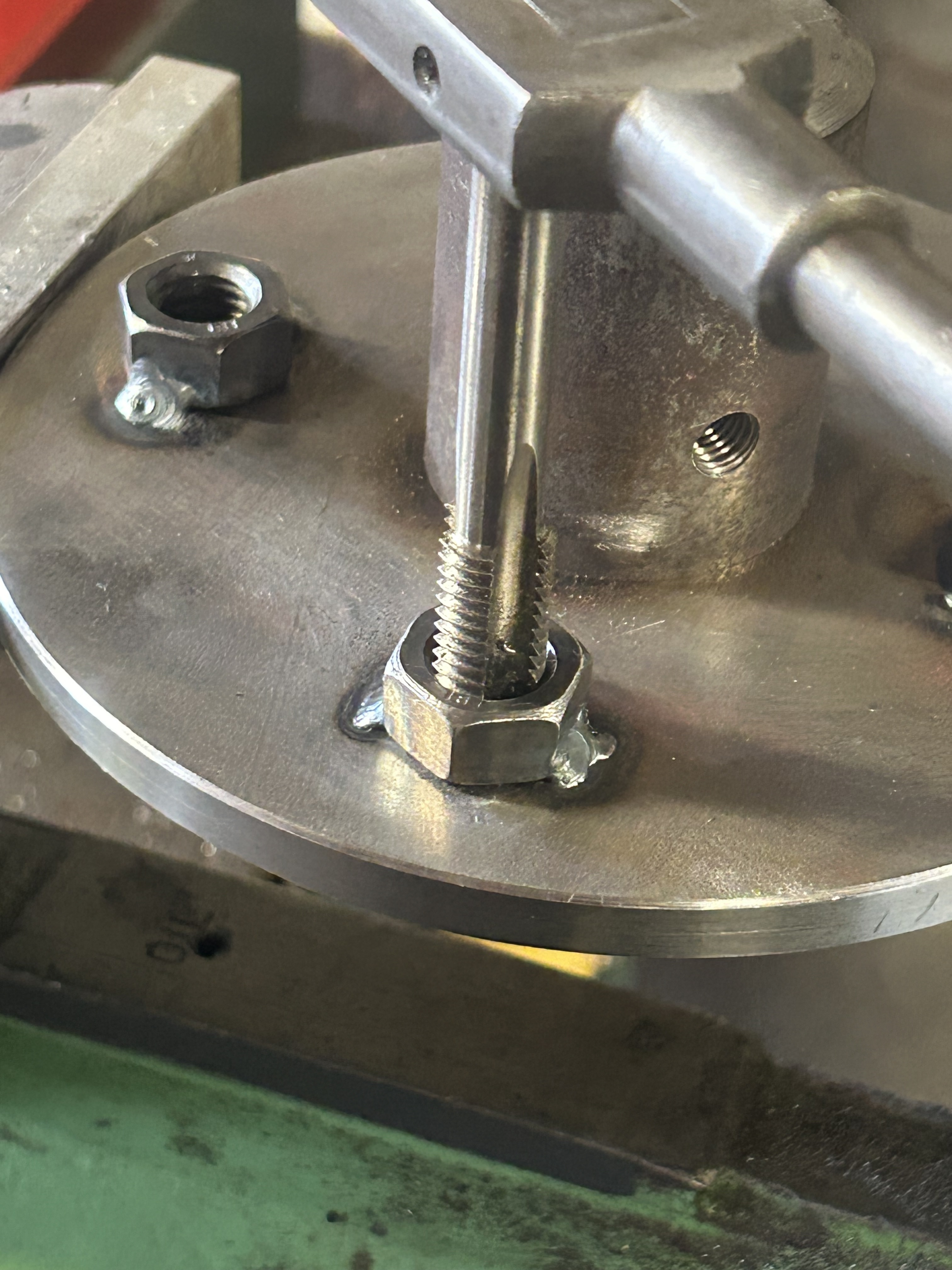

Attachment 47651Tapping down through the nut and into the flange.
