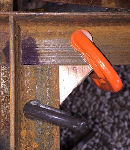

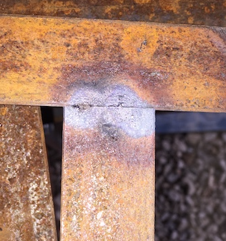

This material is perfect for the frame of a project I am making. My only welder is an antique Lincoln 220 Amp AC "buz box". Even at the lowest 40 Amp setting it is very easy, for me anyway, to burn through the thin material. Like this one only his great great grandson, maybe with a 3rd great.
Attachment 48984
The use of a chill plate seemed like a possibility. Some small pieces of 1/4 t0 3/8” steel plates in my recycle bin are perfect and serve a dual purpose. They are nice and flat providing a perfect surface for clamping parts in place. There is a danger however of welding the frame to the plate.

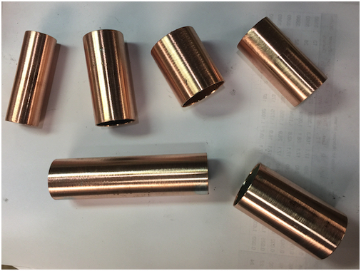

Some chill plates are made of thick copper. Copper conducts heat away from the weld quickly. I do not have any thick copper plates laying around. I do have a lot of of copper plumbing pipe in my recycling collection.

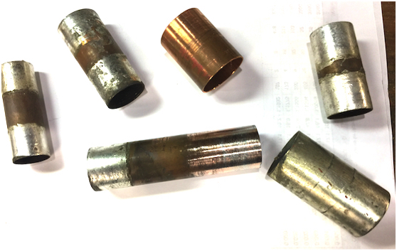

I selected some short pieces,
Attachment 48973
cleaned them up,
Attachment 48974

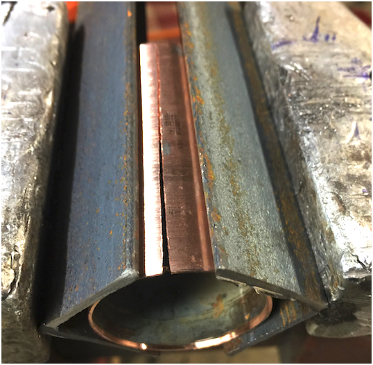

slit the sides with a hacksaw,
Attachment 48975

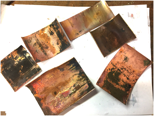

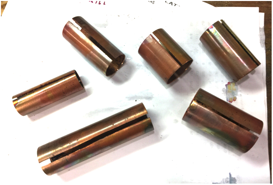

annealed them by heating with a propane torch and drop into cold water
Attachment 48976
bent them open,
Attachment 48977

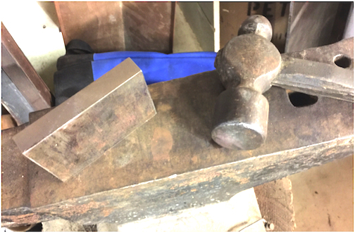

flattened with my grandpa’s old hammer and anvil and a flat steel plate,
Attachment 48978

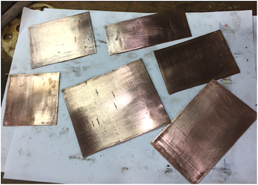

Finally, clean again.
Attachment 48979

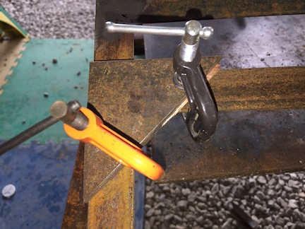

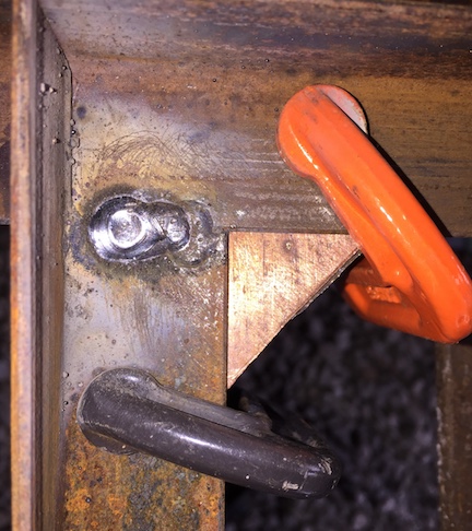

The copper can then be clamped between the parts to be welded with a steel backing plate to hold parts in alignment while welding.
Attachment 48980
Attachment 48981
Attachment 48982
Backside
Attachment 48983
It helps me make better welds in thin material.

The chill plates have actually made me a much better welder.
Thank you hemmjo. The flattened copper pipe is really useful. If you don't have copper you can get a similar effect using thick aluminium sheet, which sounds odd as you'd expect it to melt at steel welding temperatures. As long as it's thick enough / has some free area for cooling it conducts the heat away before it will melt. On a side note, backing of welds using copper / aluminium isn't allowed in some industries, but I find it's very helpful to improve my amateur welding!
