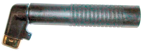

When it comes to the electrode holder Benard has done ot better for 40 years and are not much more expensive than just the drill chuck would be
back when I was pipelining and doing heavy equipment repairs it was Benard or nothing for me, one would last through a 1000 lbs of electrodes or more .
A simple 1/4 twist to the left opened it then the same to the right closed it Change rod sizes open it more or close it more would accept rods from 1/16" to 1/4" (1.5 to 6mm)
Also if it didn't have a rod in it you could toss it on the work piece and it wouldn't arc out made of industrial Bakelite with a copper nose shied for heat

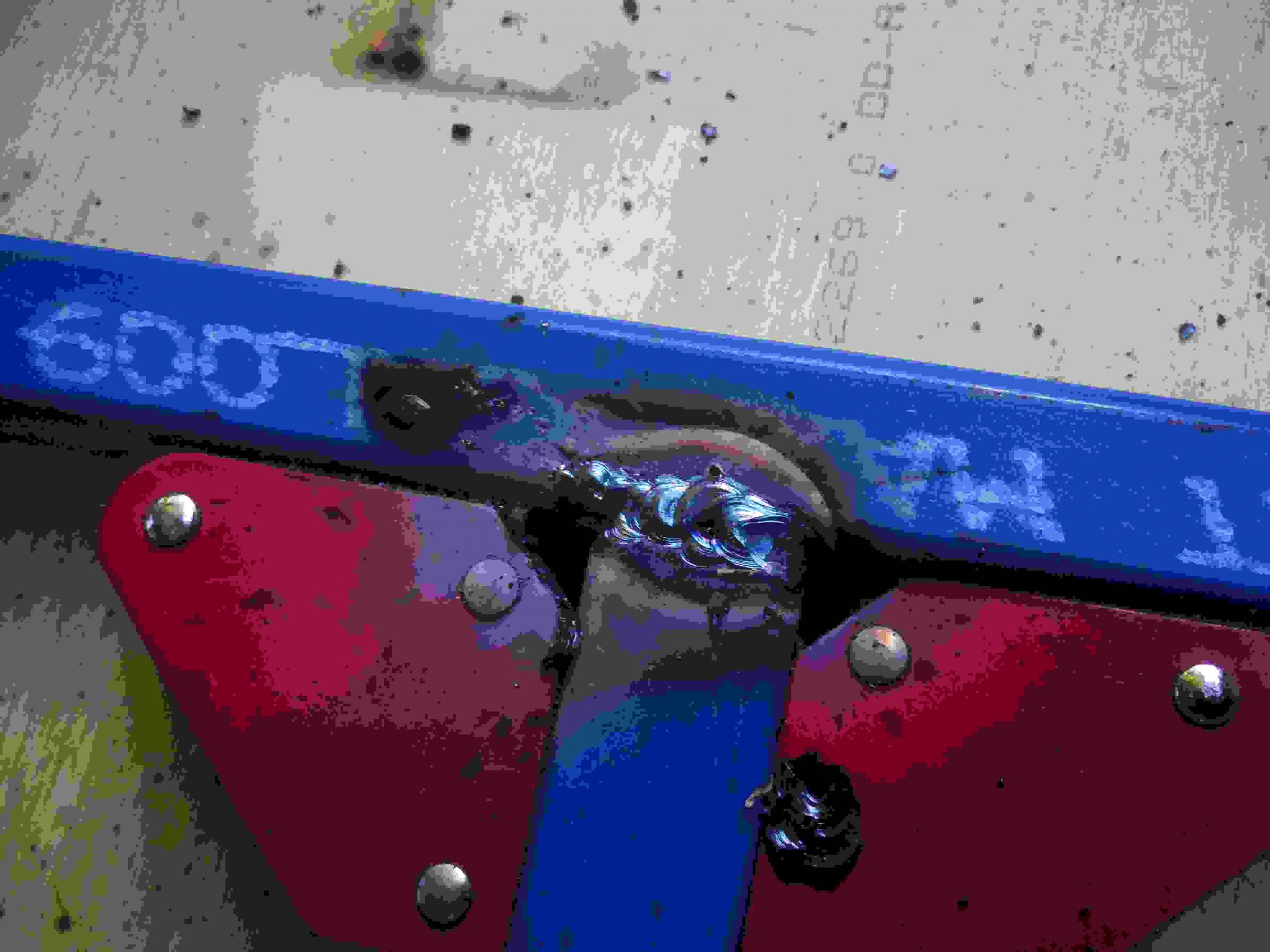

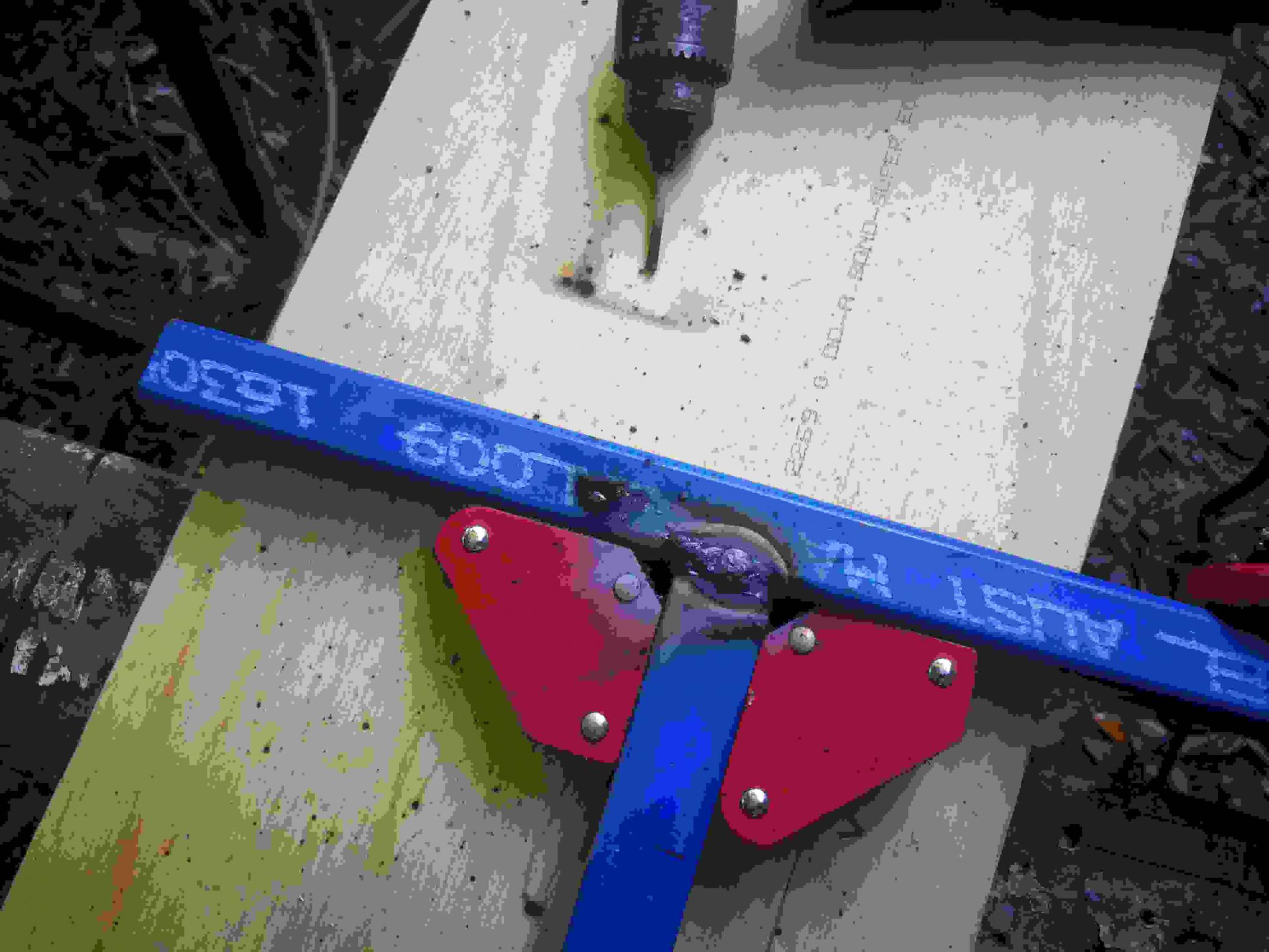

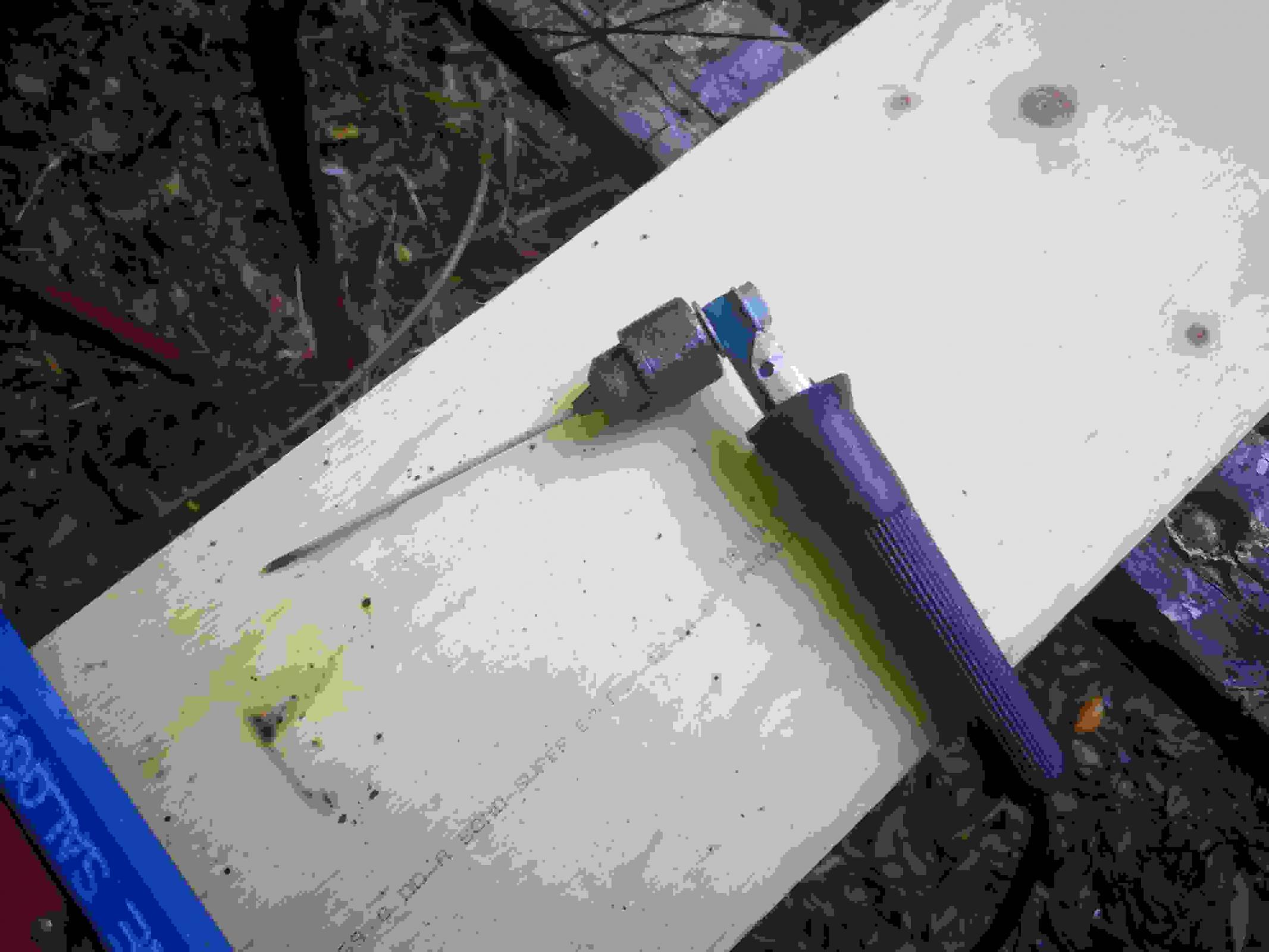

Liked it so much I built my own! Works a treat, nice flowing weld with no bird **** spatter.Attachment 29411Attachment 29412Attachment 29413
hahahah super Bro,I'm really glad you liked my video and you made your own welding tool, congratulations and just forward
