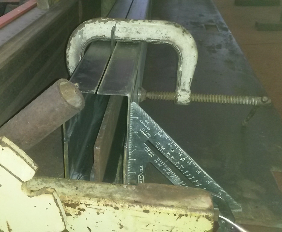

This weldment is called the lower beam in order to fabricate it there are 2 main pieces which must be welded together to make a rectangular shape with a raised formed slot Due to the shape and the parts which must be welded inside it has to be formed in 2 pieces then welded together
here is my stupidly simple method to achieve this
I welded a vertical strip to my tilt table then clamp the pieces over it using the strip to preserve the slot width
Attachment 39198

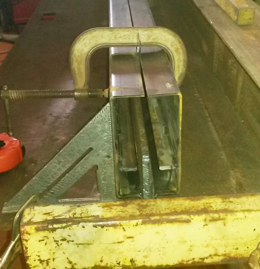

A pair of speed squares clamped to the table maintain squareness

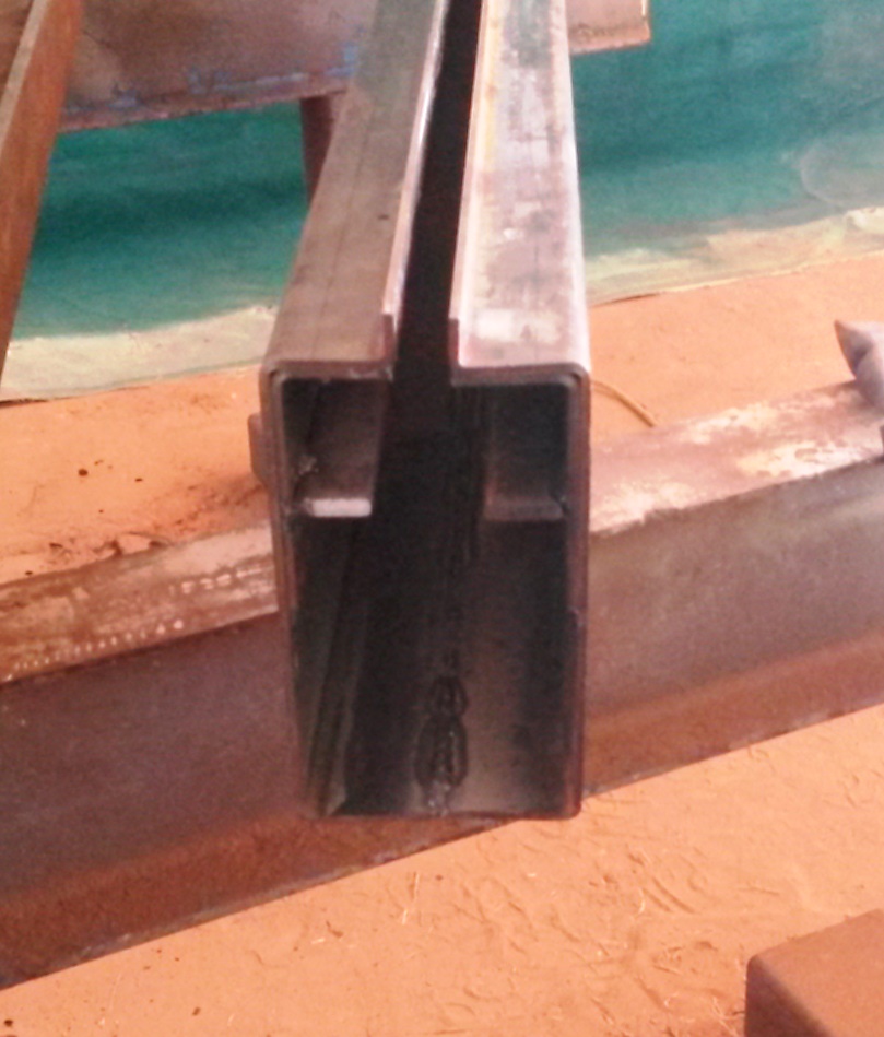

and shims clamped between the sides allow for a 100% penetration weld
Attachment 39199
Attachment 39200
