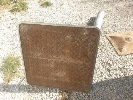

With so much of my stuff packed away and or moved I really needed another small welding table. So in digging around in the ever shrinking pile of usable stock I noticed an old steel patio bar table or part of it at least.

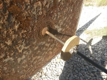

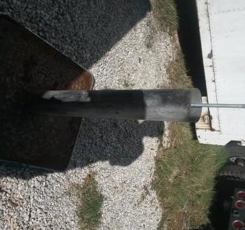

It looked like it would fit the bill I just needed to make a couple item for it first was to cut out a couple of wooden disk so while searching around for a piece of wood in the trash pile I actually found 2 disk that my wife had tossed there Cool no need to make them then I found a length of 4" thin wall pipe that actually fit the disks It may have been the piece that they were made for, for all I know, anyway I cut about 6 inches off if it put 1 of the disk on the table stem and added a hose clamp to keep it in place then added a coupling nut and a length of 1/2" all thread and the other disk then the pipe and then bolted the base back on the bottom.

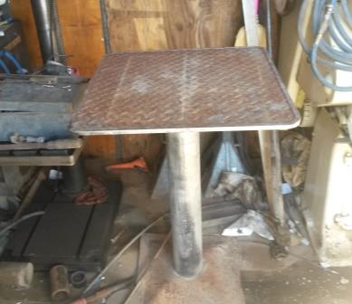

Now I have a small stable lightweight welding table for the project I was about to repair.Attachment 15222 Attachment 15223 Attachment 15224 Attachment 15225 Attachment 15226 Attachment 15227
