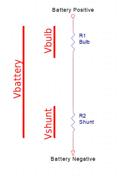

    Thanks for the tutoring. If I put the device on the positive post of a battery in the vehicle and measured the voltage from the body to ground with starter or lights (load)and used ohms law what would I expect to see? Thank you everyone for your patience with me as I don’t often understand logic.

    Quote Originally Posted by Eaglewood View Post
    The current through R1 is the same as the current through R2. So we also know:
    Ir1 = Ir2
    Vbattery=Vbulb + Vshunt
    Vbulb=Ir1 * R1
    Vshunt=Ir2 * R2
    We think R1 > R2 (by how much? maybe 10 to 1000 or more times higher)
    If we measure Vbulb and Vshunt we will see the ratio of how much R1 is greater than R2. If a meter is inserted to measure current through R1, we can calculate R1.
    If we don't have a current meter (has to be DC, not a clamp on AC meter which is what you said you had) we can insert smaller bulb or a resistor of known value. Or if we can measure resistance (you have the ohm meter), you can meausre the bulb while the circuit is active (yes, you can do that as long as you only cross the bulb) and now we know R1 and can calculate Ir1. (Why when it is active? because if the bulb heats up, resistance can change)
    Once we know that, we can calculate R2 because we can read Vshunt and Ir1=Ir2.
    I wouldn't use the starter or lights of the vehicle until you have figured out what Rshunt is. If it is milliohms (which it should be), then you can use Rshunt to measure vehicle operating values (such as starter current or power consumed by the lights).
