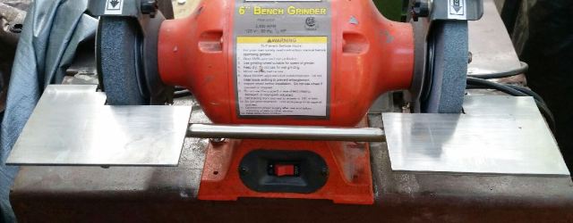

Today I got up and looked at the extension cord first thing and discovered that a sliver of metal had fallen into one of the sockets and I happened to touch it while putting it away. I took the box apart and tidied all the connections up anyway since it's been needing doing. Next I jumped on to my bench grinder tool platen project and finished it up in not that long. It'll be a boon to my tool grinding efforts because my hands aren't that steady and my eyes aren't that good these days.

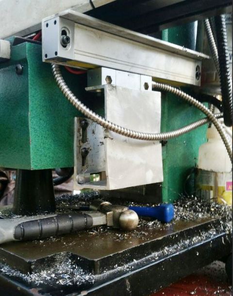

Then I started again making a new Y axis DRO reader mount that allows access to the Y axis lock down bolt so I can make better cuts. To my surprise and pleasure my welding clicked today and I was able to finish a new mount that will fill the bill. This project was notable to me because
1. I made it for free using bona fide scrap from my bin
2. I can now lock down the Y axis when making long cuts and I'm sure that better milling will result
3. I made my first successful TIG welds in aluminum and they looked acceptable after grinding off the globs. Nowhere to go from here but up and though it's still not anything to write home about I can make more things out of aluminum now.
