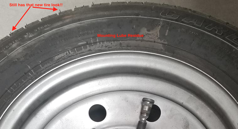

Wheel ripped from hub - photo
That is caused by the wheel nuts not being tightened properly, one has come loose and started the others coming loose, whilst they have merrily kept driving along.
Now with all that shaking and totally ignoring the vibrations and noise, eventually the wheel studs get chewed out,and or, the holes get flogged out and that is the end result.

1 Attachment(s)
That tire looks to me like it was just installed on that wheel.
Attachment 44219
