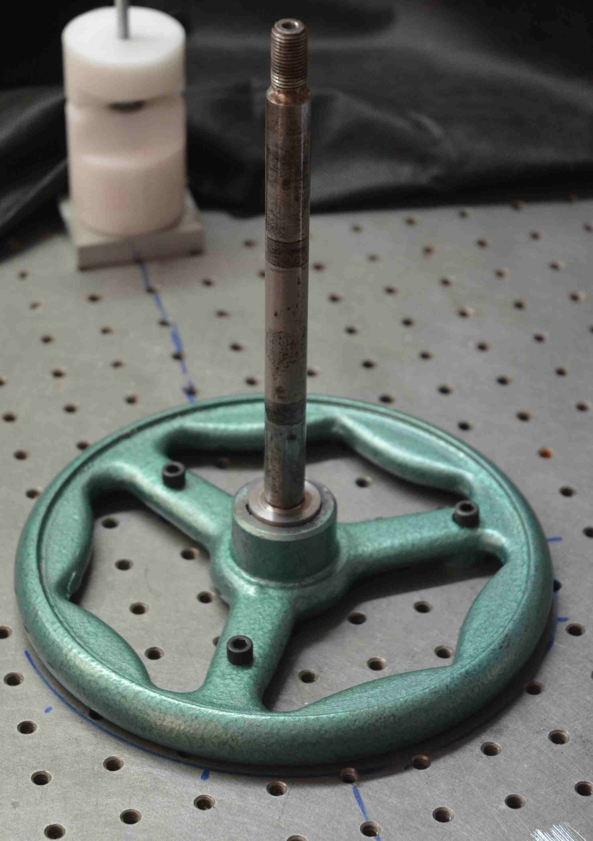

The most common bearing sizes in the wheels likely to be of interest to me were/are 15, 17 and 20mm, so I decided to use a 15 mm spindle with sleeves to take care of the larger sizes.
Attachment 48672 Click for full size
The 15mm spindle was a press fit into an old lathe handwheel which gets bolted to the optical table. This gave a rigid and accurate alignment of the wheel centre. After pressing the axle to the handwheel, the axle was mounted in a lathe and the base of the handwheel was machined to ensure truth.

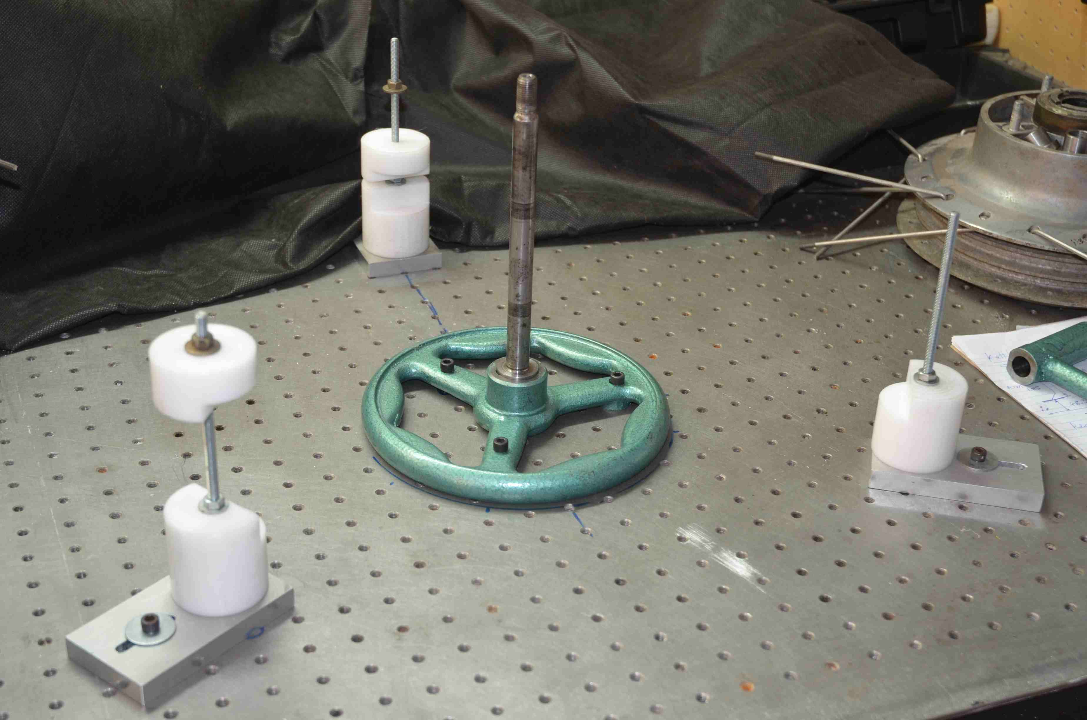

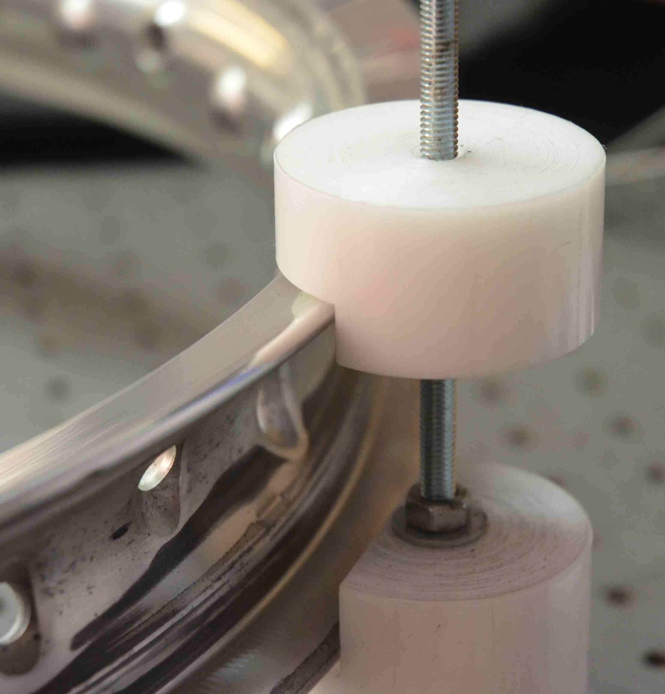

To locate the rim true to the spindle I made three Delrin locating and alignment pieces which were attached to the table via slotted adjustable mounts, so as to cater for 18" and 19" rims.
Attachment 48665 Attachment 48666

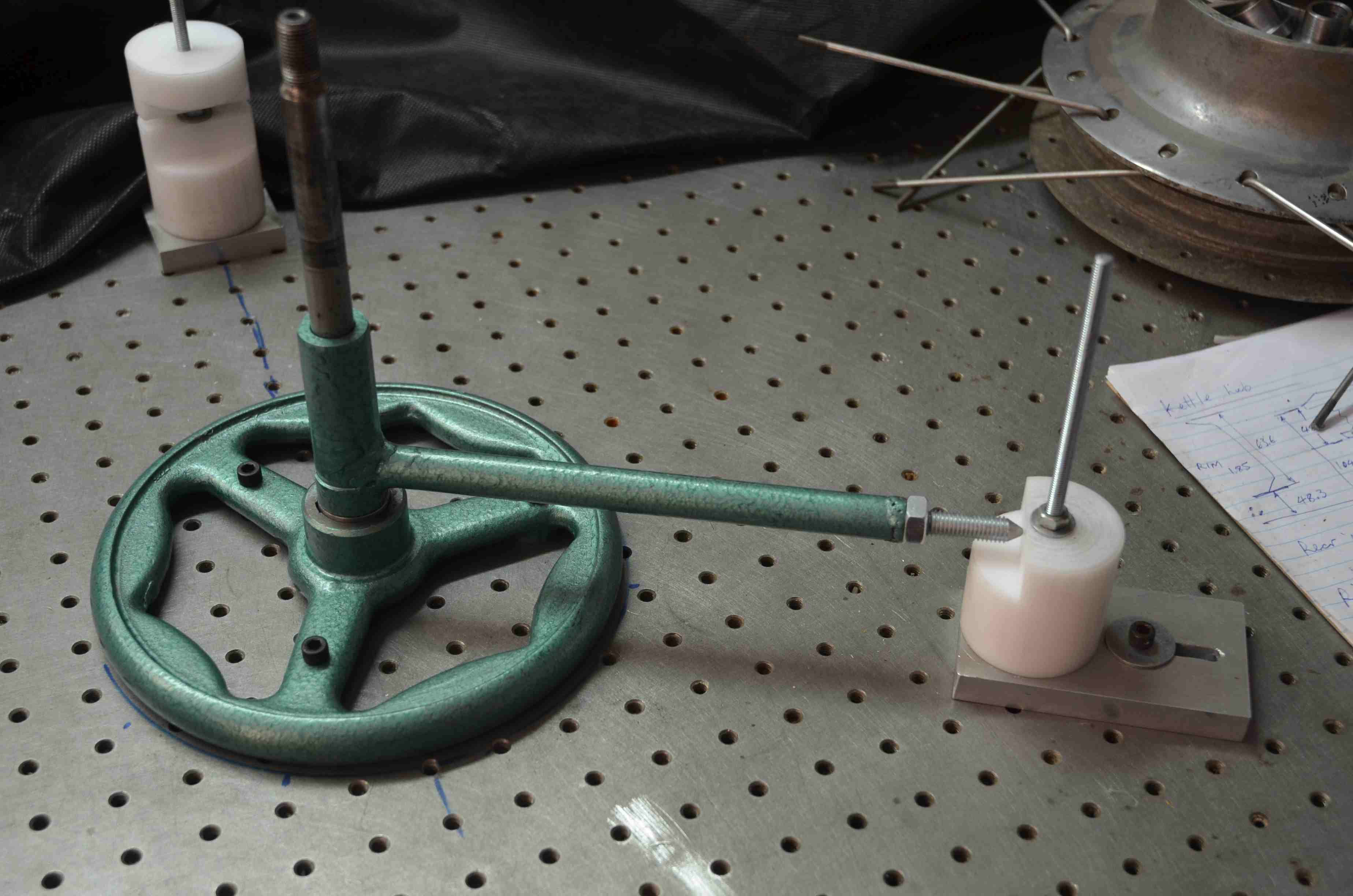

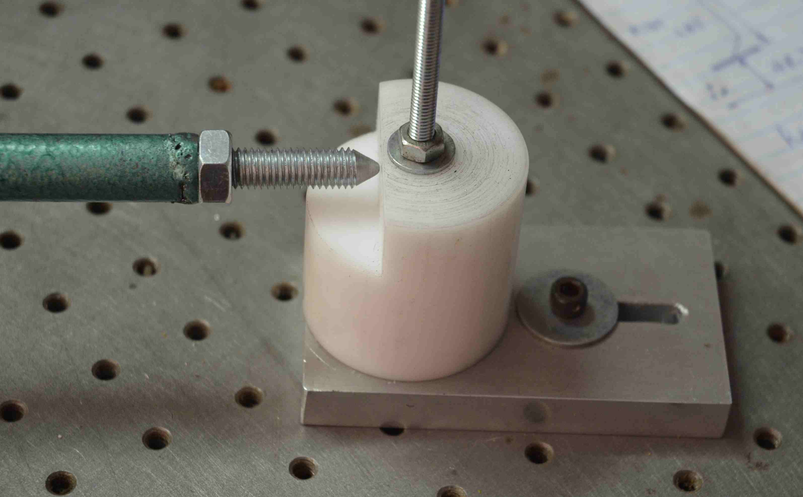

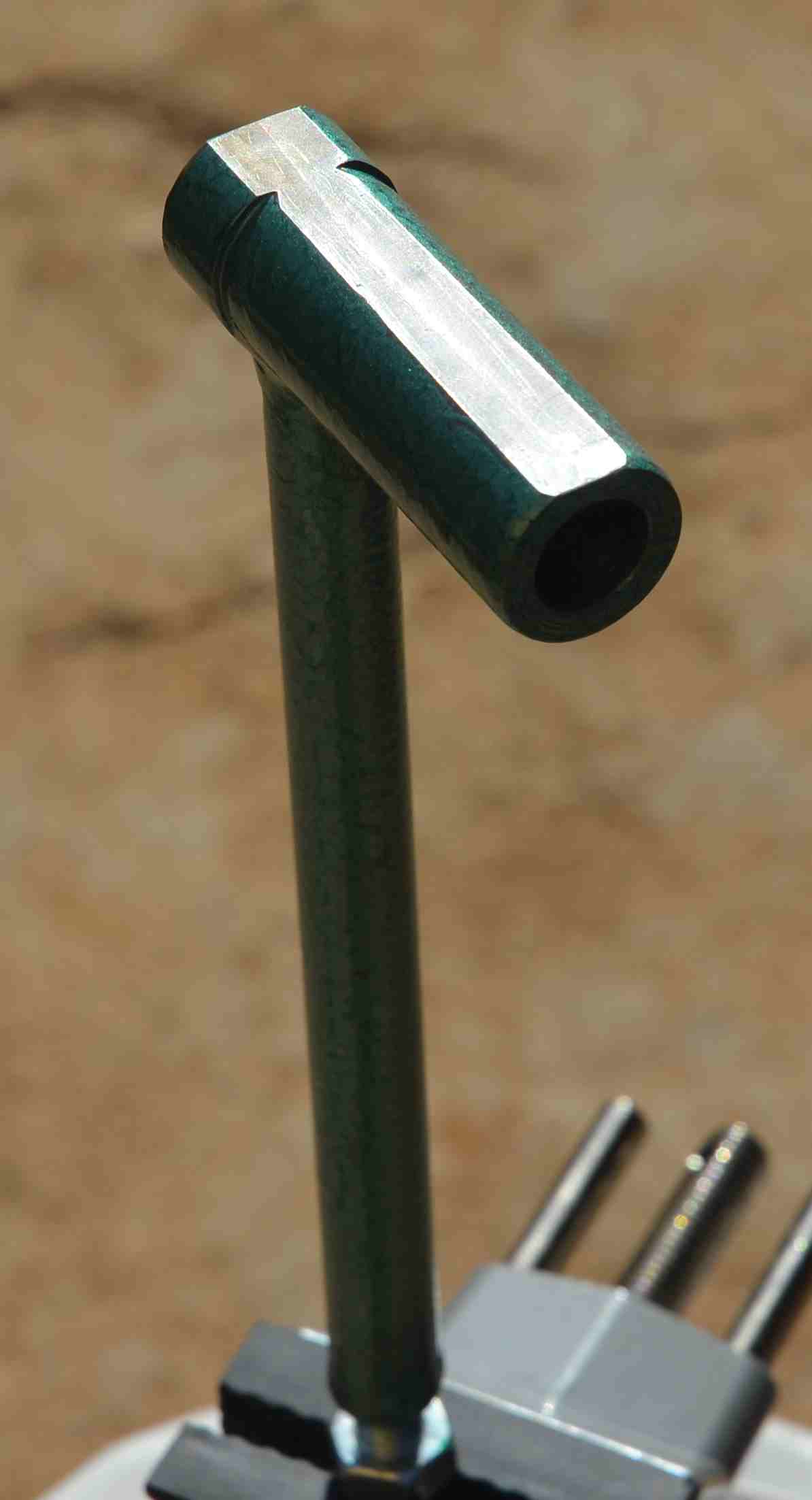

Adjustable mounts are fine but you need some way to ensure correct alignment, For that purpose I made a setting tool. It pivotted about the 15 mm axle. and a piece at right angles was used to ensure that all three mounts were radially aligned. The far edge of the spindle sleeve was machined flat to sit on a surface plate for setting.
Attachment 48667

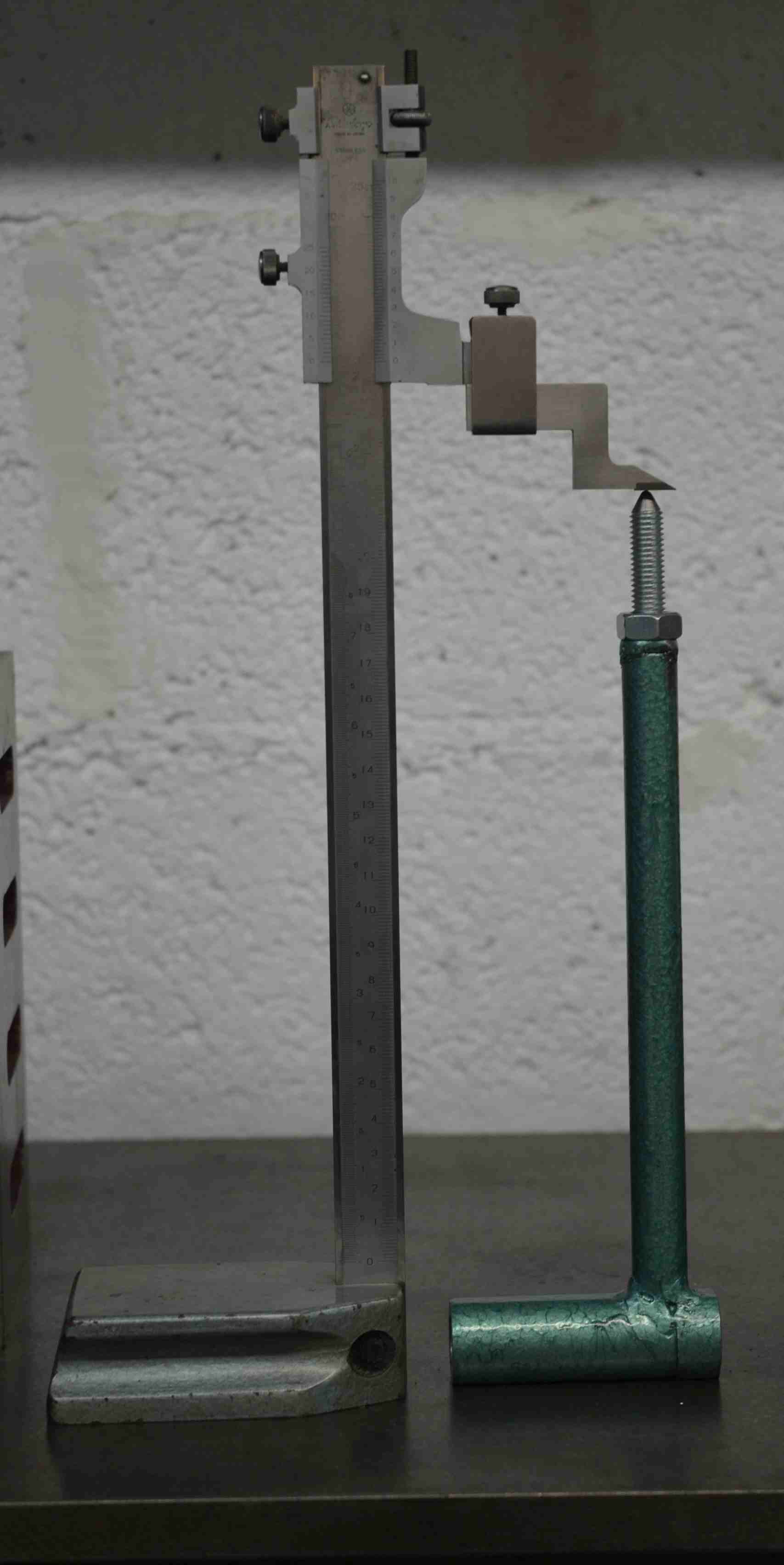

Setting the length of the setting tool.
Attachment 48668
Using the setting tool to position the rim clamps.
Attachment 48669 Attachment 48670

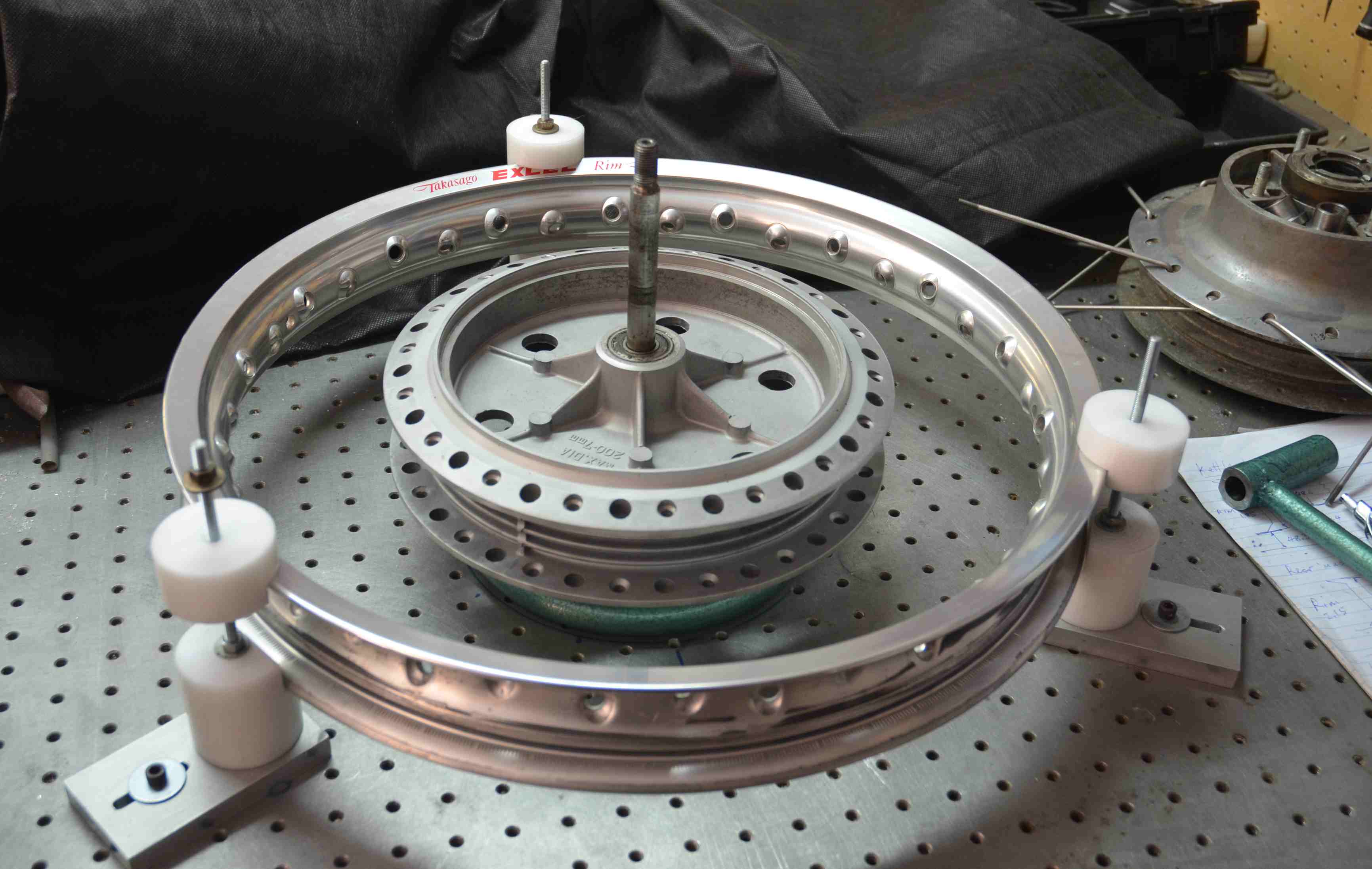

Here are the rim and hub mounted ready for spoking.
Attachment 48671
