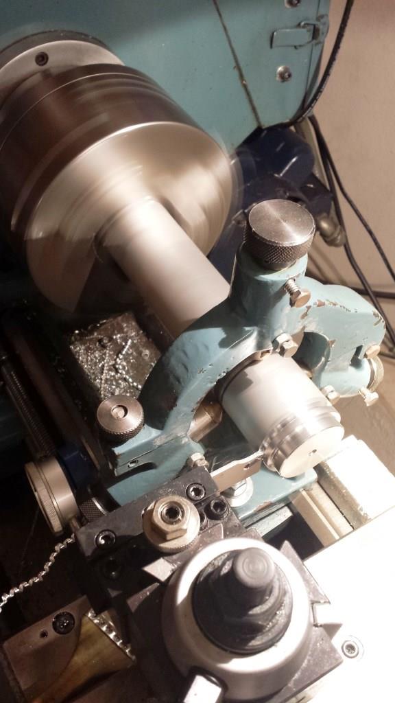

2 Attachment(s)
Mini Lathe Tail Stock Clamp Upgrade
Paul, I was amazed when I tried my new clamp on the tail stock as you mentioned. The new one is twice as thick,twice as long, a little wider and rough finished, I also drilled clearance holes for access to the tail stock adjustment screws. The alignment is instant and the clamping is quite strong. One added benefit is easier alignment when placing the tail stock on the lathe bed. Before that square clamp would always rotate and would not fit properly without rotating it a couple of times.
Thanks for the great idea. If anyone wants to do this mod be aware that the mounting hole and clearance holes for the adjustment screws are not centered on the mini lathe tail stock. They are offset a bit but easy enough to get the hole right on with a few measurements of the lathe bed and tail stock itself.
