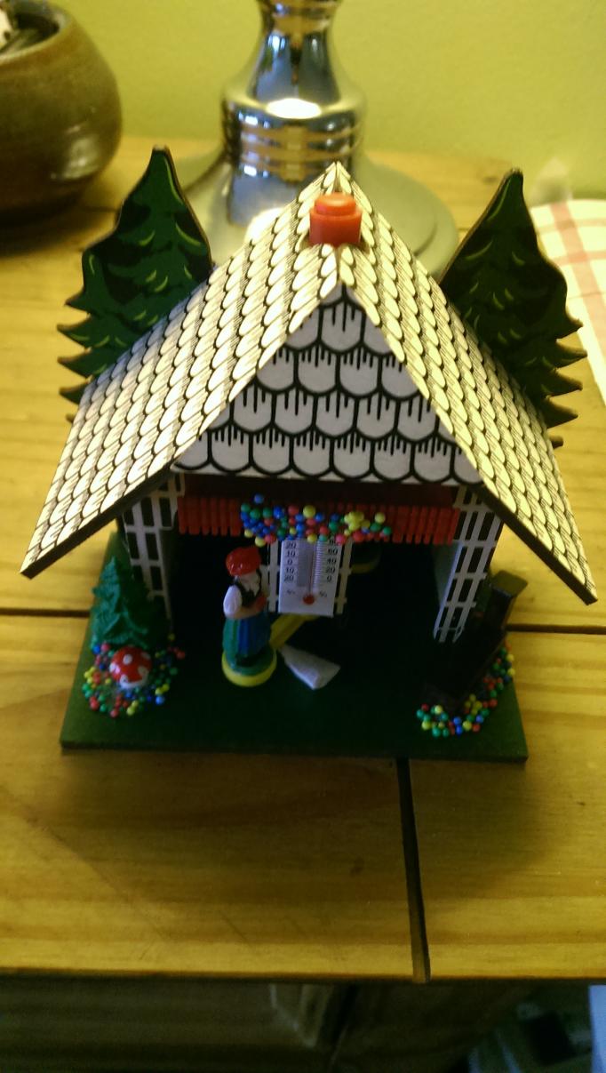

The work on my magnifier lamp is on slow at the moment as I've got involved with a design challenge that's got a deadline and requirement for weekly posts. The contest is "to enchant an every day object" so my plan is to take a weather house and hook it up to the internet to get a more accurate forecast. There's a few other changes along the way such as changing the motion to a more linear motion.
Attachment 3381

The deadline for the project was Friday so I worked hard last week to ensure I had something to demo. The build is complete but it might be nice to record a better quality video. However, I'm taking a well deserved break this week.

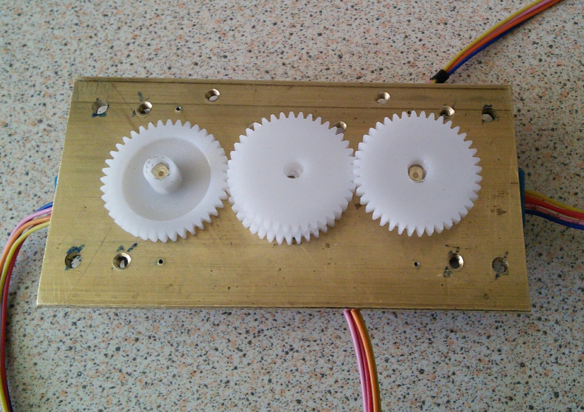

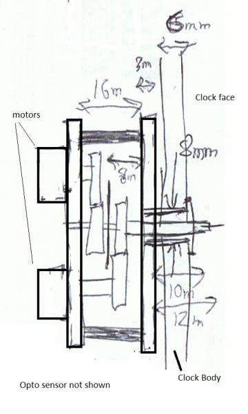

I have exactly the same stepper as yours, and so far, I feel they are quite slow, so I guess the hands are not dirctly on the shaft of the stepper, and how do you manage to drive the two hands that are on the same axis ?
Edit, I just saw the video, I saw how you did it, but where did you find the necessary gears ?
There is another one, which you probably already know about, it's a big wooden spiral, with a ball rolling always in the bottom position, this one could be nice to do as well.
Thanks !
Christophe
3 Attachment(s)
Christophe, those motors have a plantetary gearbox so have a ratio of 1/63.8. The gears came from Proops Brothers ltd via Ebay.
Here they are for a test fitting.
Attachment 3906
I don't appear to have any photos of the concentric shafts but here's a sketch I made.
Attachment 3907
