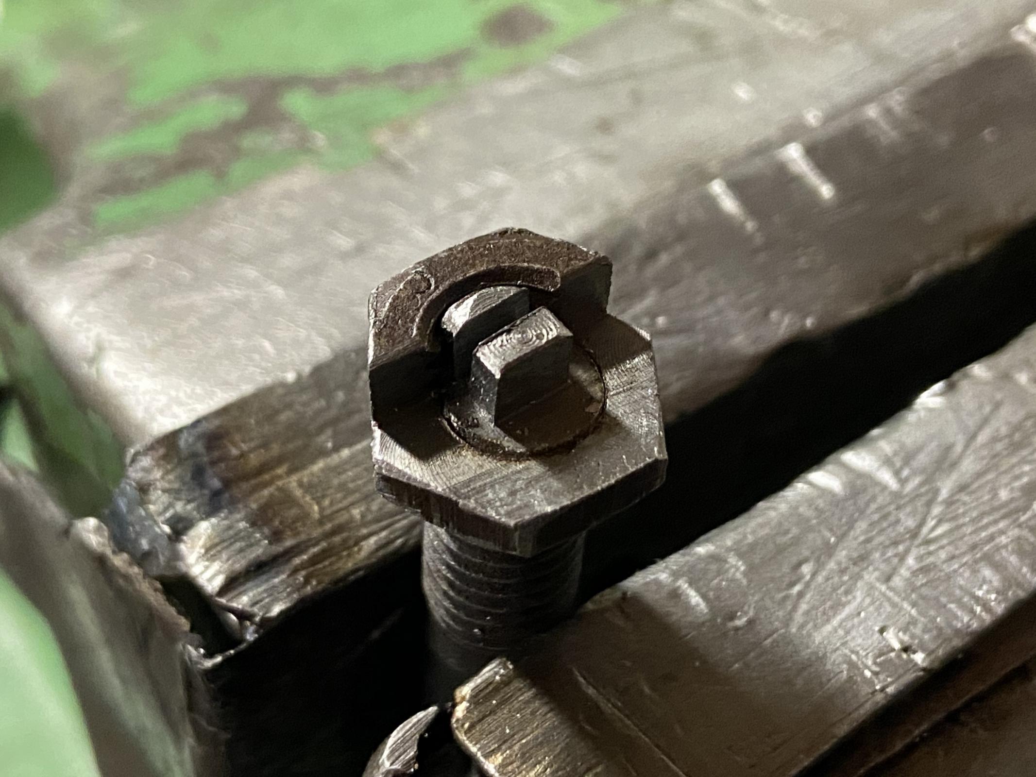

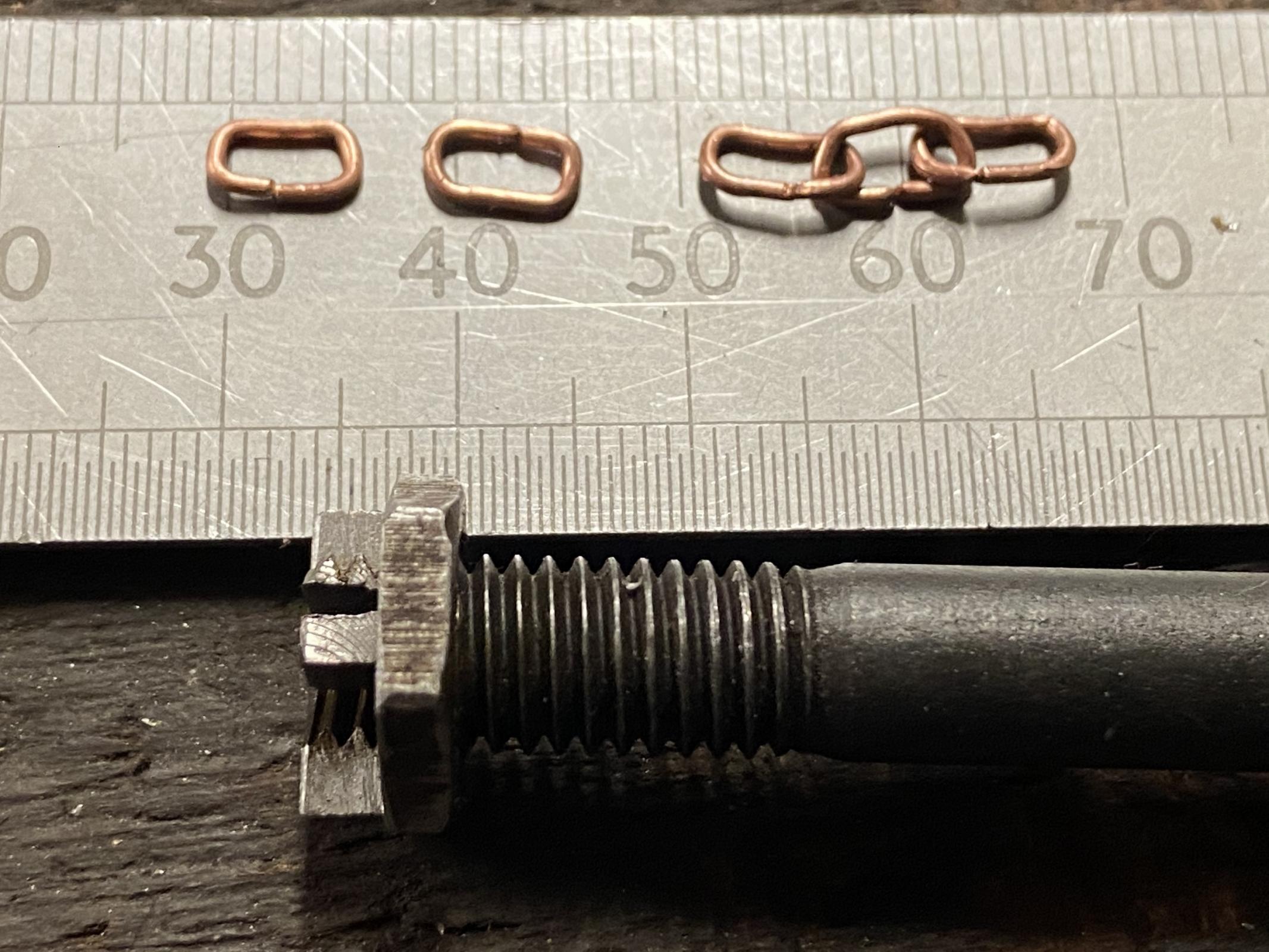

After seeing this thread by kess (supporting member) https://www.homemadetools.net/forum/wire-bender-76803 I had a :idea: moment and thought about adapting this style of bender to make chain links for my 1" scale traction engine.

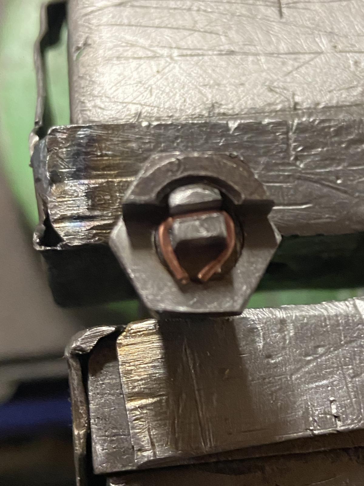

I decided to use a M8 (5/16") nut and bolt to make the bender as the links are only 6mm x 4mm (1/4" x 5/32") made from 1mm (0.040") copper wire. The following photos show the first few test links and the method used to form links.
Attachment 33327
Bender made from M8 nut and bolt
Attachment 33328

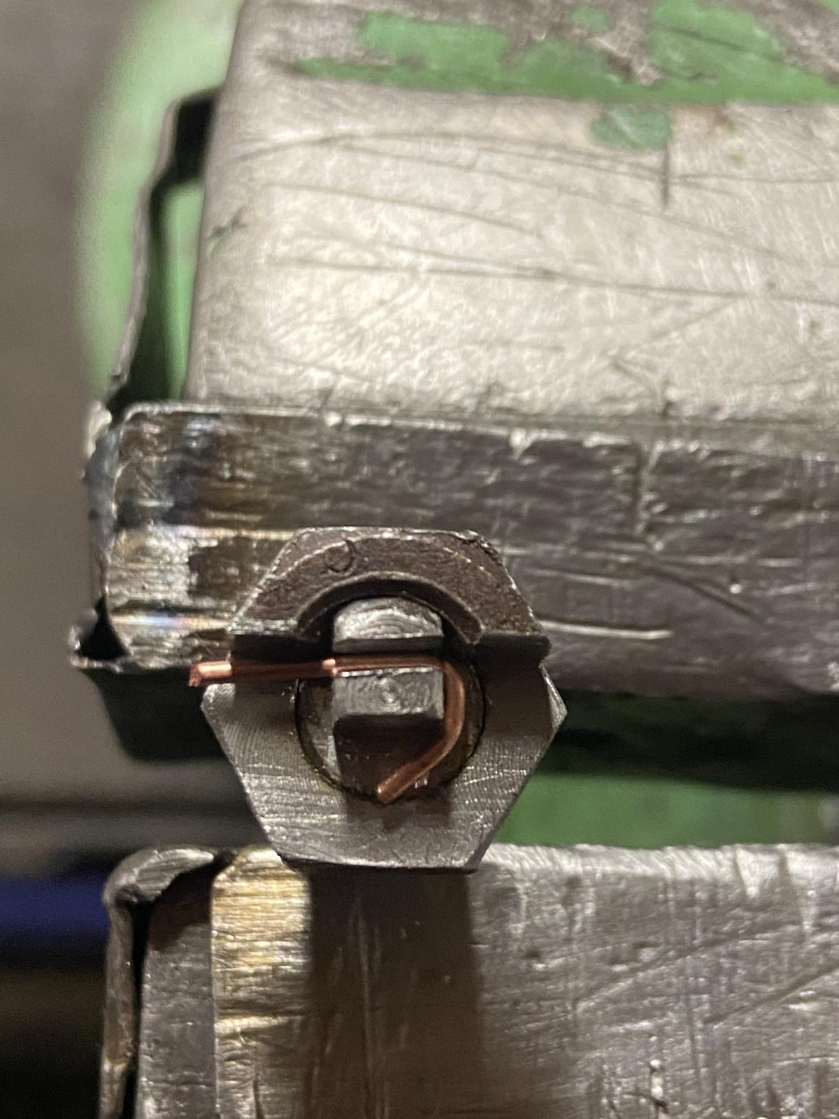

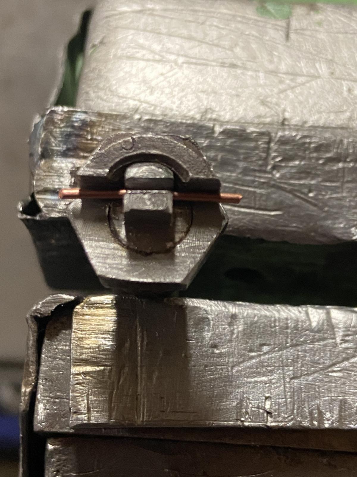

Copper cut to length ready for forming
Attachment 33329 First Bend Attachment 33330 Second bend

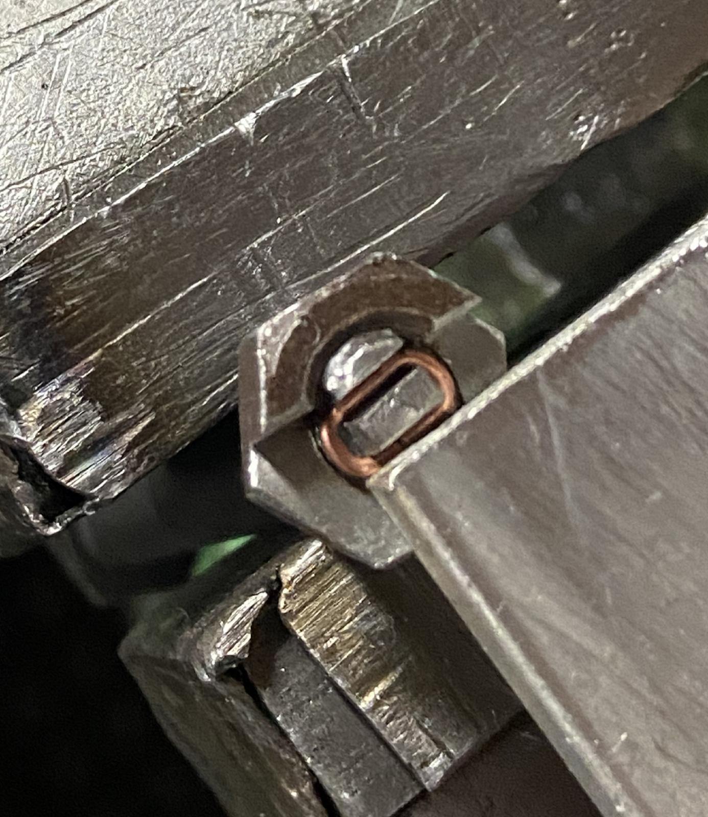

Attachment 33331 Closing link with a piece of aluminium

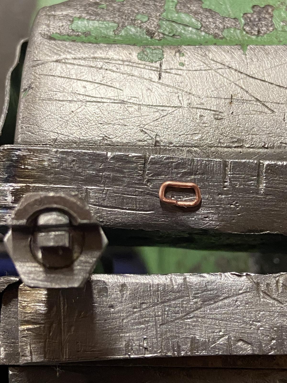

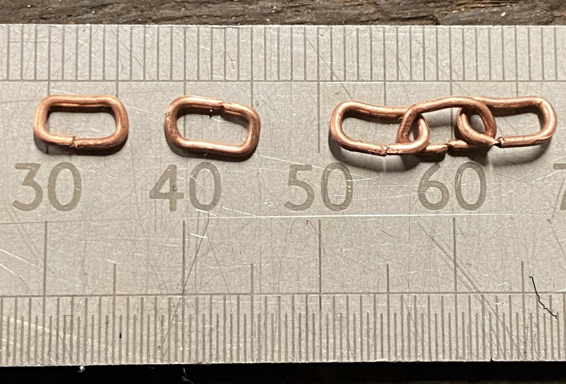

Attachment 33332 Link removed from bender

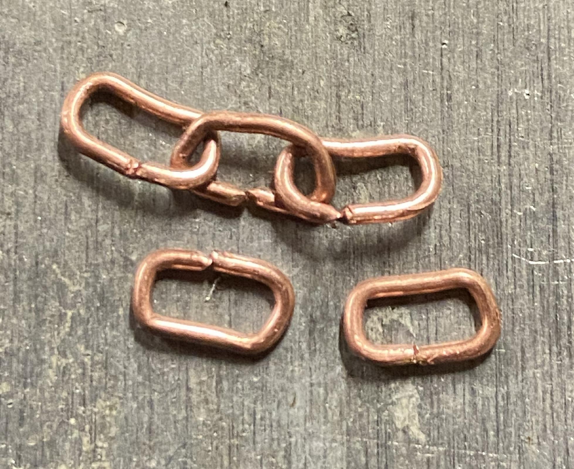

Attachment 33333 Attachment 33334 Attachment 33335 First few test links
The links will be silver soldered at each joint. As there are quite a few links needed I am in the process of designing and making a guillotine to cut the wire to a constant length.
