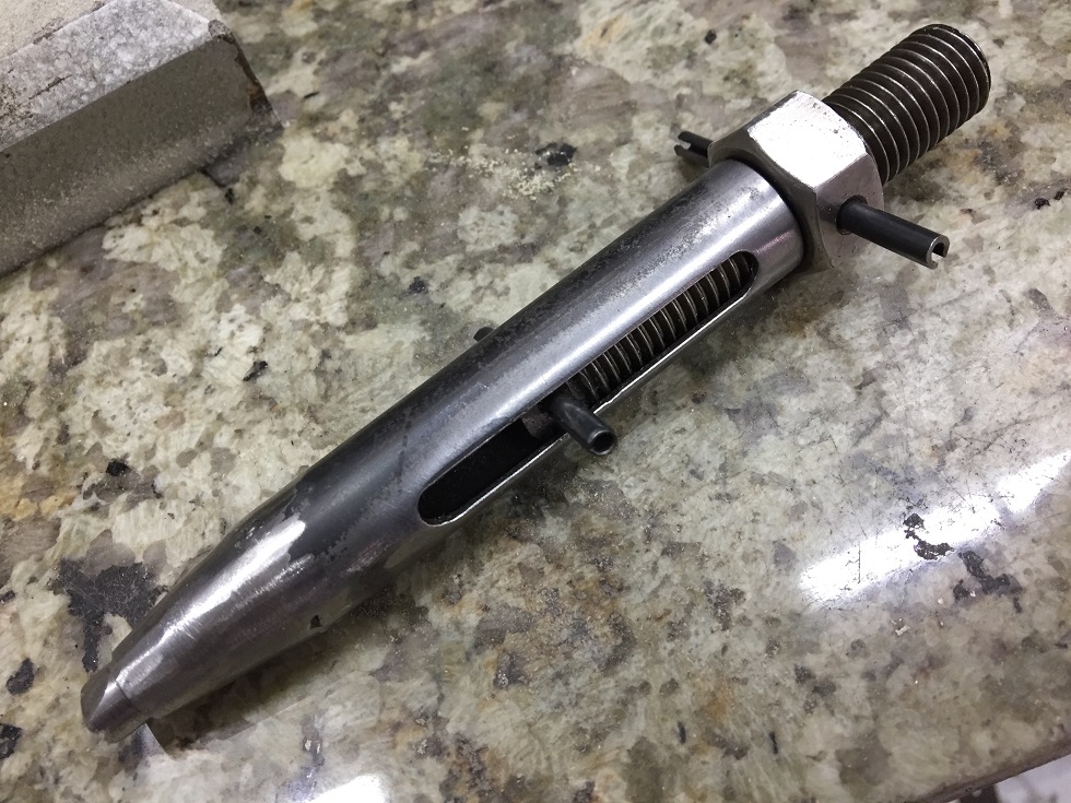

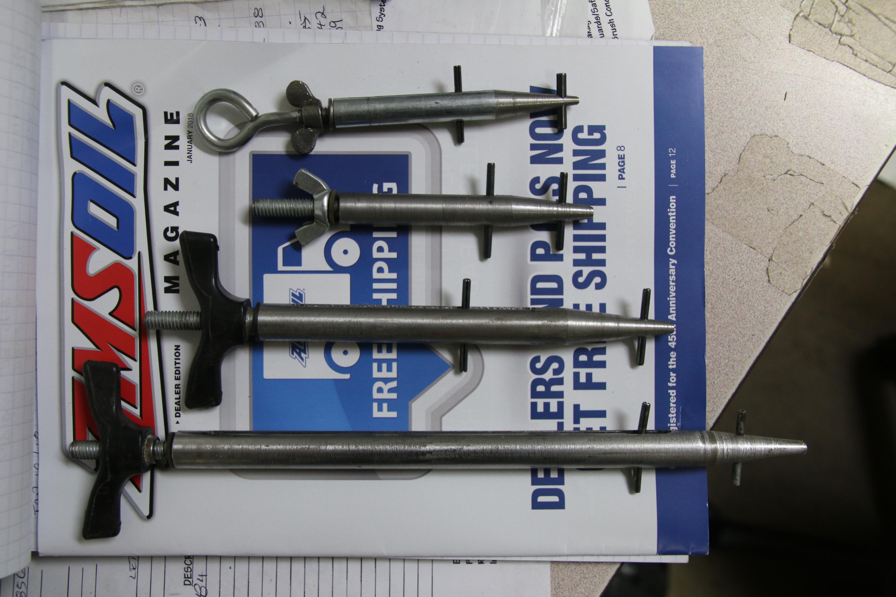

My take on the "old" wire clamp tool. Used it to connect what ever pipes I could find to make up the 20 meters I needed to get to the tanks. Can share its working if someone does not know this type of clamp. Fortunately made it some time ago so it was ready for use and at least clamps were going to be no problem.
Attachment 21656

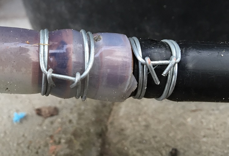

the clamps are super neat, low profiled and for mine I use galvanised wire. I tried stainless, but find the wire has too much spring back.
Attachment 21657

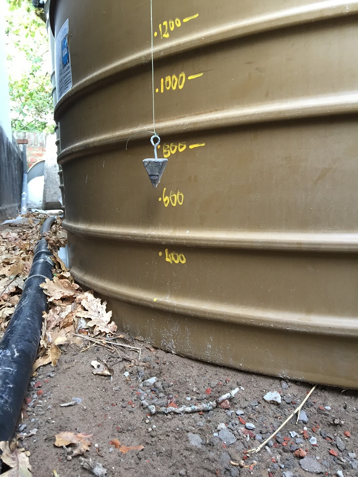

And I have to share with my Web family that I managed to recover +600 Liters of water with some promise of some more rain Monday after noon
Attachment 21658
