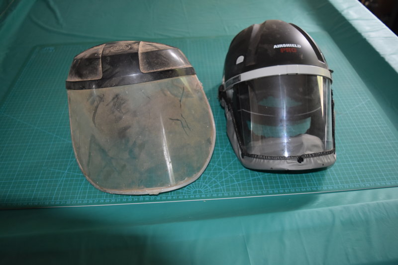

Safety is a big serious thing especially for the noggin. My fav piece of kit used to the one on the left.
I used to use it with gauze while whippersnipping/brushcutting in parks: that was until a very large sloppy doggy doo sprayed through the gauze and covered my face as well as my body.I was spitting more than chips and not one tap in the park: had to find a neighbour at home & then phone for clothes replacement. I'd laugh but it still isn't funny, many years on. Who would have thought that a 33cc brush cutter loaded with 3mm string could spray so much from under low branches where it couldn't even be seen.
I changed to the right one (with no tell tale unused accumulation of dust)after a chunk of relatively soft Toona sp. let loose from a lathe while I was standing aside to check out its behaviour before starting.(I waited years for prices of similar items to fall due to the demand of safety gear but it never happened but tech did improve weight, use time etc: these also remove harmful dust associated with similar such species). The red cedar chunk missed me but was flung across the shed.
